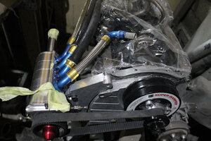

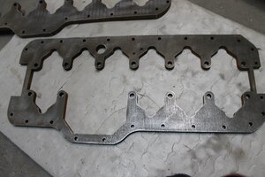

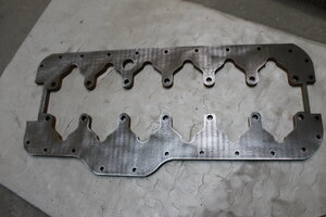

I know that the 7m block is flexible. My engine Japan Promodet Komine Engineering is supercharged at 1.2bar. I think it will be more reliable with a reinforcement plate.
And I'm converting to a dry sump.

figgie
5,225
50
Twin Cities, Minnesot-ah
Good ole Weiss/PRC 5 stage dry sump pump. Probably also has the hex adapter in the rear (judging by the discharge pipe on the rear).

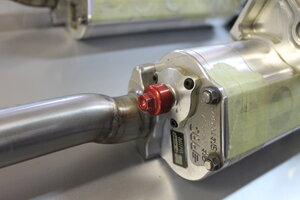

trofimovich
Jun 29, 2012
97
21
8
Russia
In an engine with a turbine and a boost pressure of 1.2 bar, will there be a large vacuum?
Does the weiss pump develop a large vacuum?
I didn't find any information about them.
figgie
5,225
50

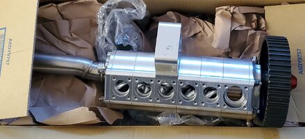

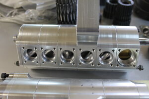

Not sure when they went from 6 stages to 5 stages but the 6 stage Weiss/PRC dry sump pump could.
Also remember, those dry sump pump survive 800+ hp sustained and that is pulling vacuum that they need to use vacuum pop offs so it dont pull to much vacuum.
Btw here is a 6 stage weiss pump. I do not see these any longer on ebay.
  • Like
Reactions: trofimovich

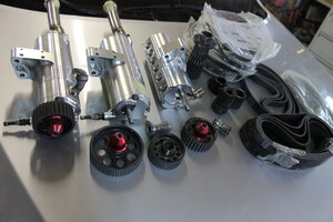

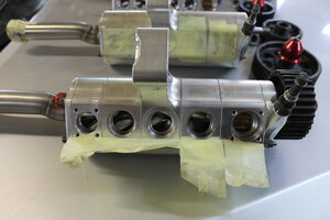

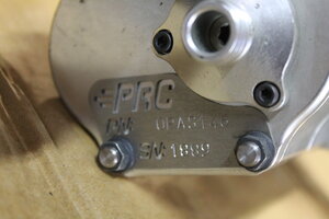

Yes, they are rare. But I prepared myself. Bought almost everything from a-1performancewarehouse,a-1performanceflorida,hindel15
The rarest is the red cap.
Often there are pumps of 5 sections.
I also bought hoses.
Special thanks for the information on dry sump vacuum seals! I'll try to search. Useful information!
