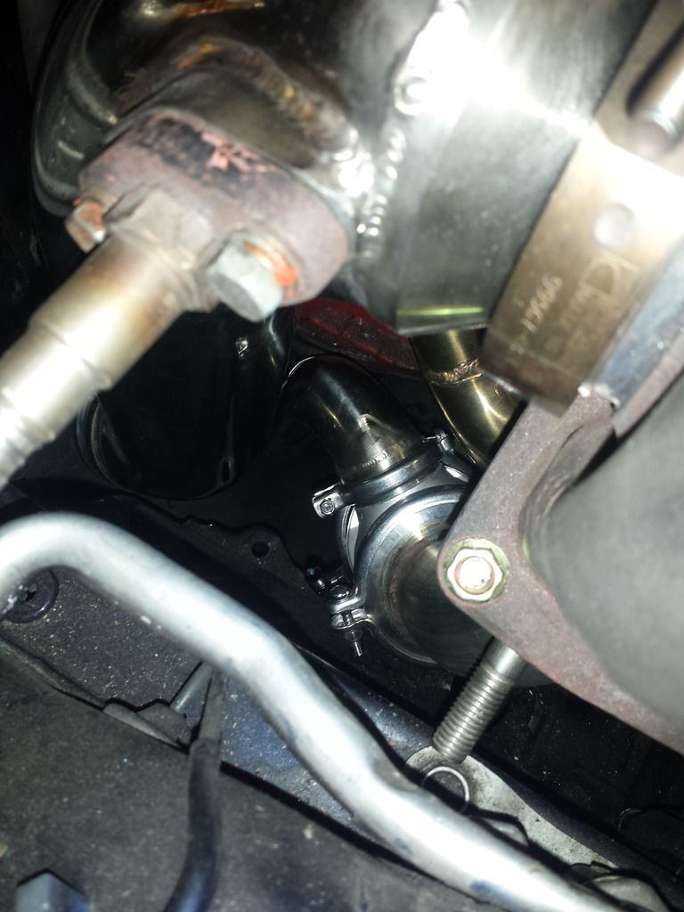

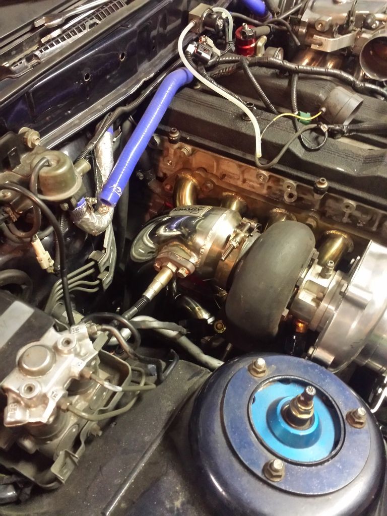

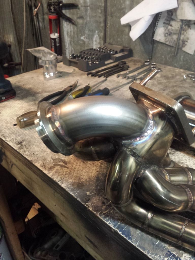

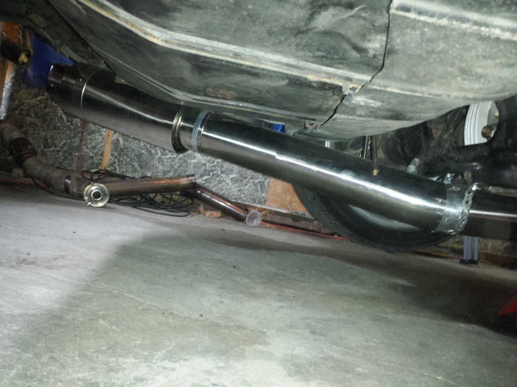

Nice fab work.
I might have to make a qsv at some point as well :D
But good luck clearing that exhaust over anything, wow! low.

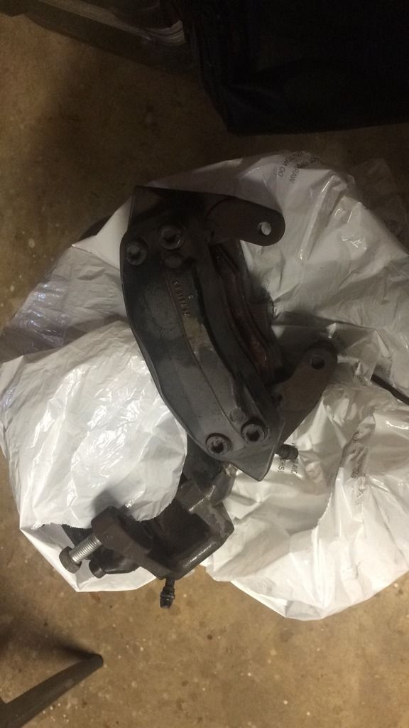

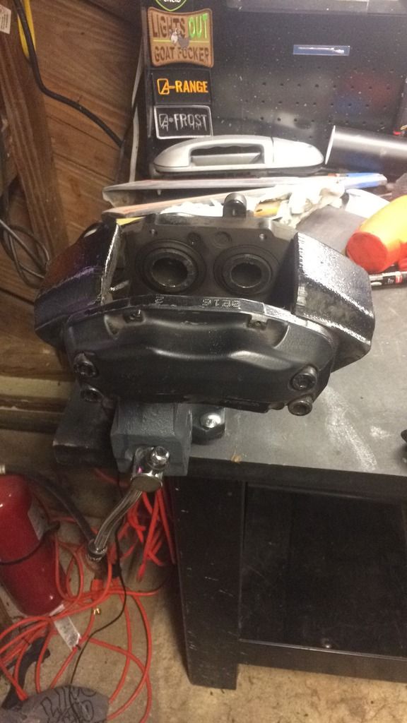

Found me a set of calipers today at the pick n pull for $30 by accident. Was looking for a set of sun visors to replace mine that aren't in the greatest shape. Walked past a S500 and thought the calipers looked familiar. Looked at the year and it was the right year car, it had just been put on the yard actually. However, I found they do not fit under my Starion wheels

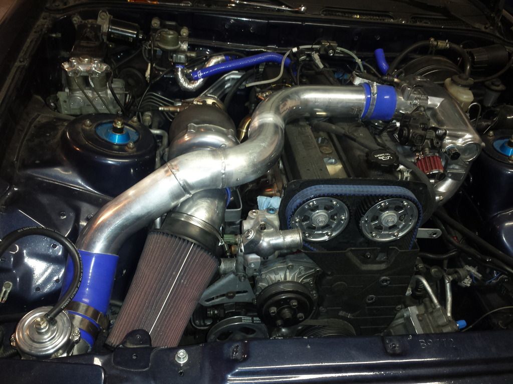

Installed Arp studs, titan hg, and threw the head on. 4th times a charm, right? I'm sure it'll last awhile
