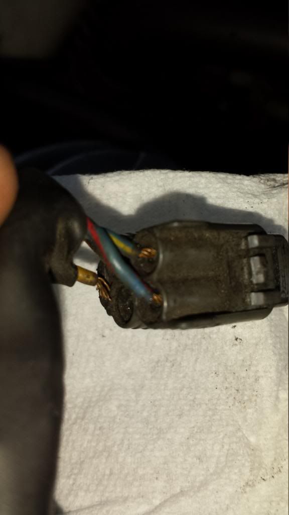

Found my spark issue:
CPS Connector. Replaced with a new connector and fired right up.

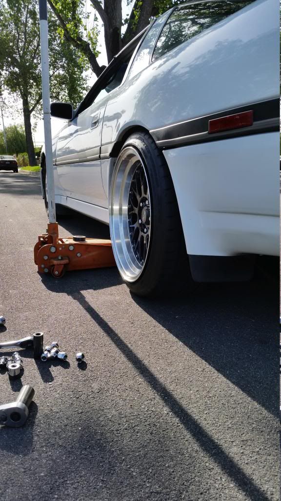

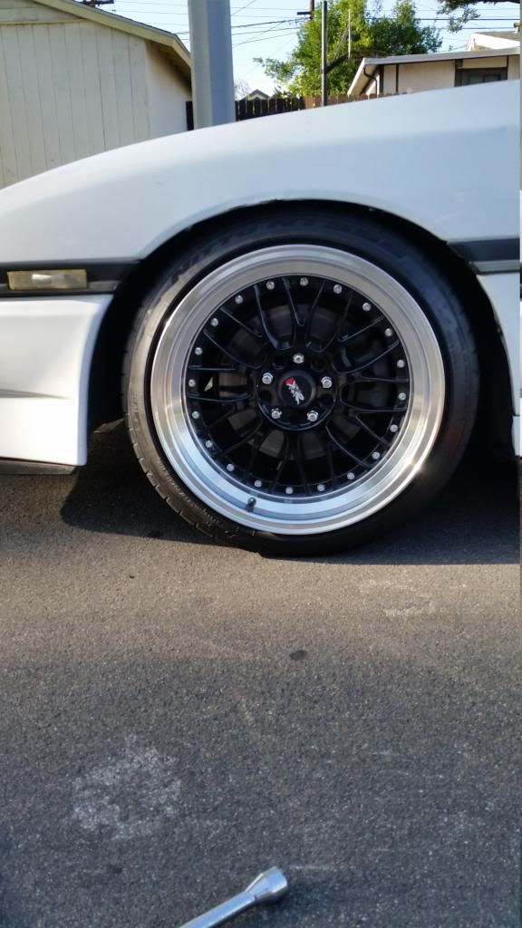

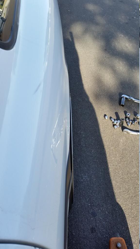

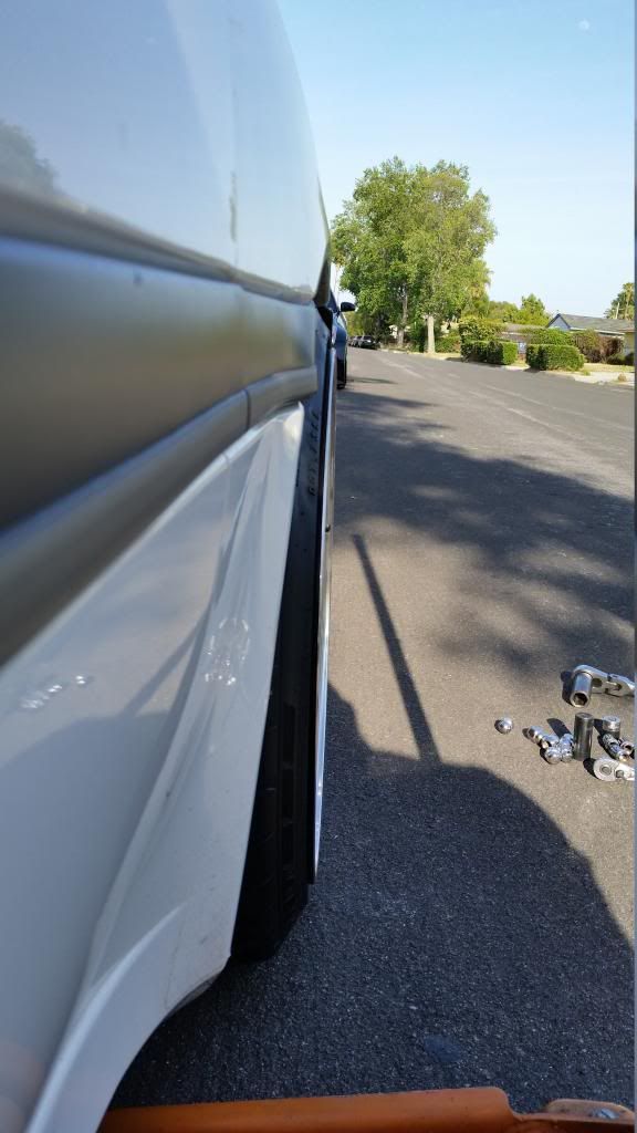

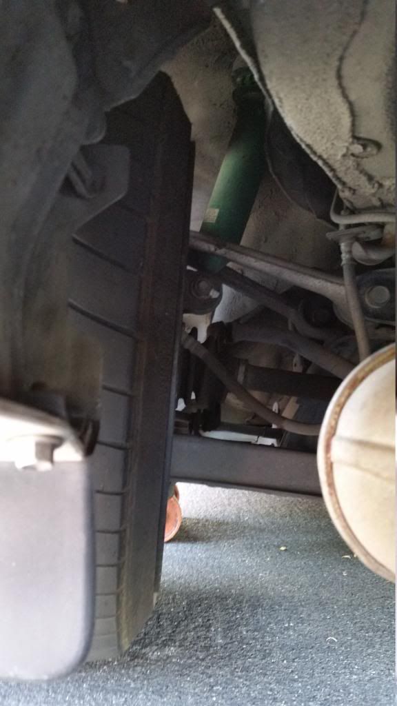

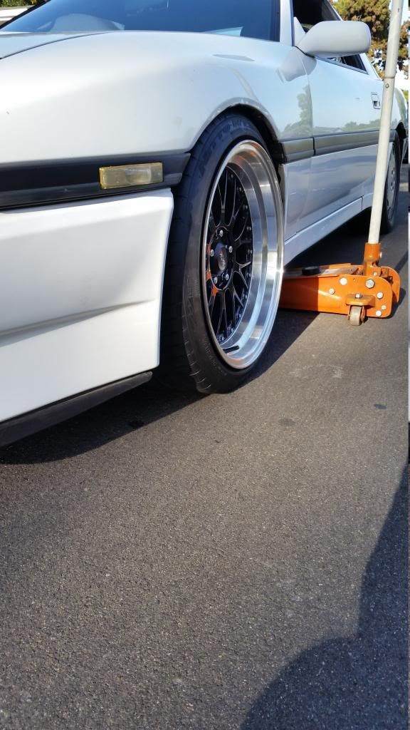

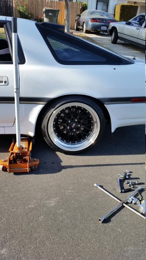

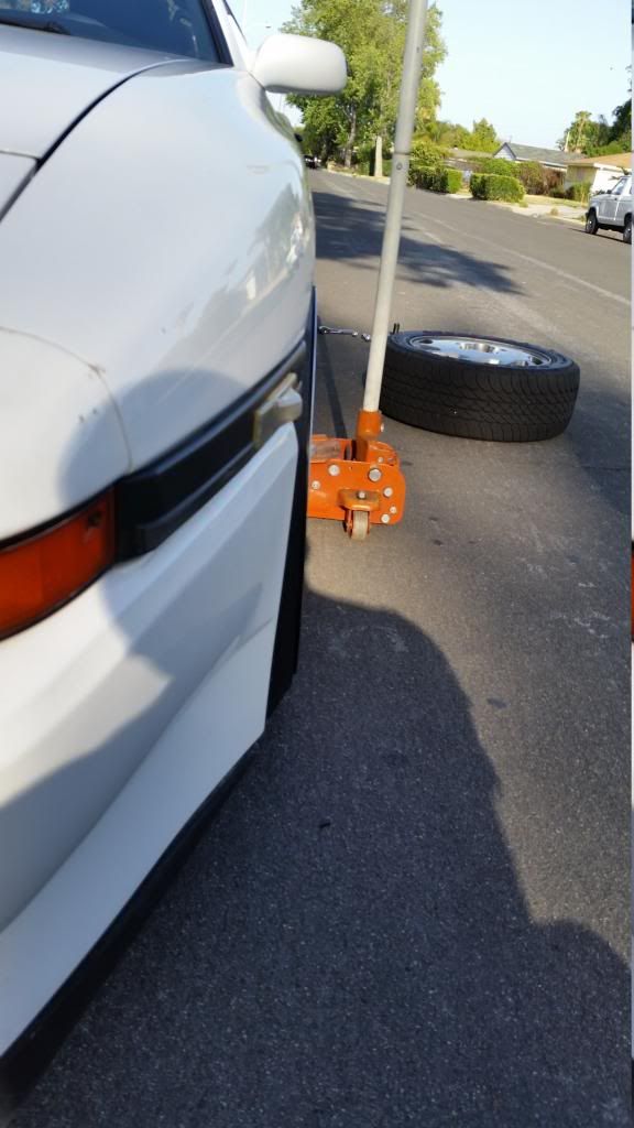

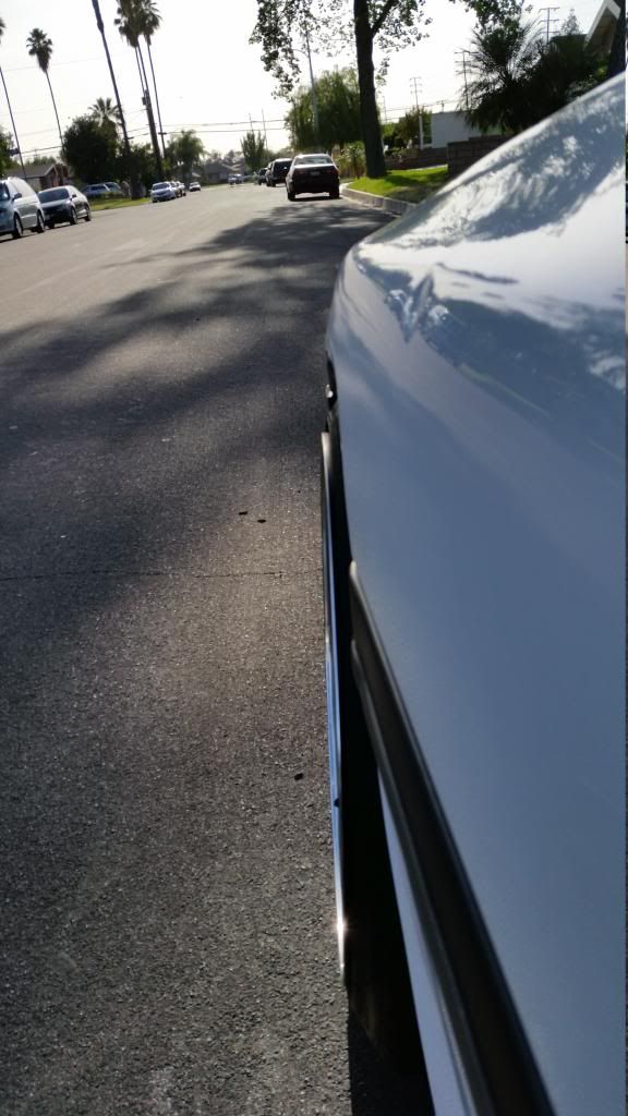

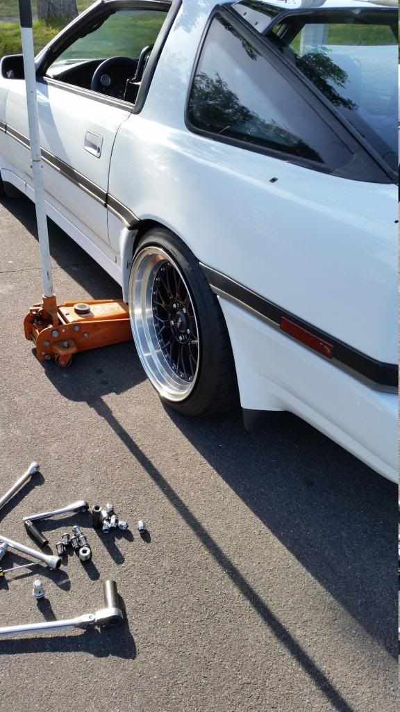

Also, test fitted some wheels. No, these wheels are not going on my car, just test fitting to figure out what size I can run. I'll post pics when I do pick up the wheels I'm looking at. Here are some pictures of the test fit:
REAR
Clearance to the Coilover body
FRONT

it definitely needs bigger rear tires. with a roll and pull you should be able to get 275-35's on there. the front wheels are too wide for my taste. i'd probably do 18x8.5 +25. that way you can fit a 235-40 under there.

I'll be getting wider tires once I get my wheels. 8.5 is too narrow for my taste. I've ran 9.5's all around the past few Supra's I've owned with 275/35 all around. Definitely like a square setup much better than a staggered setup. That wheel was off a friend's Z, I just test fitted to see what I can run on the Supra.
