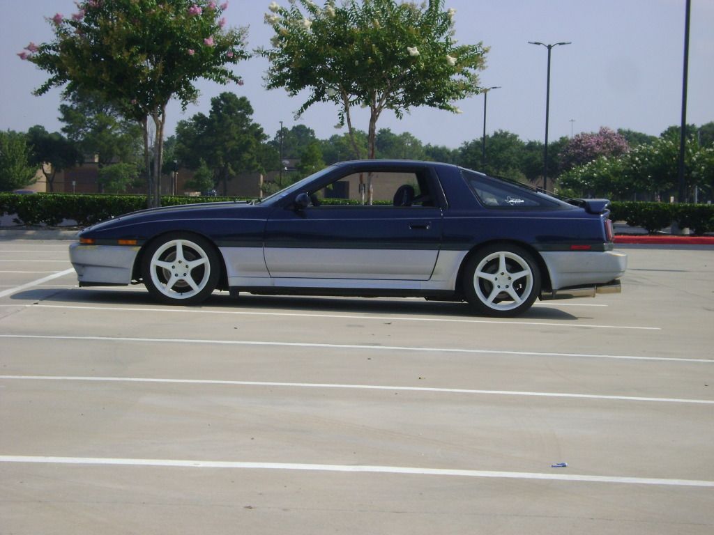

I because my camera died took a picture of my car. So I was only able to take one picture. I washed the car in case anyone is wondering what I "did" haha
My bumpers need to be resprayed hopefully will do that before the year is over

The car looks good. I always like the blue two-tones. I also need to have my bumpers repainted.

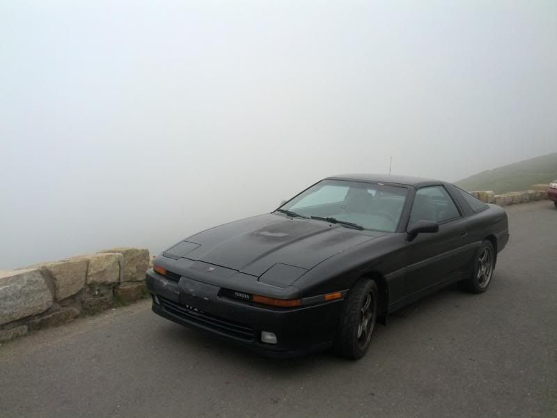

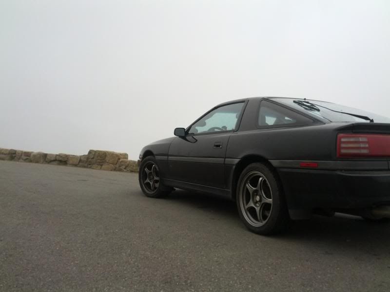

Not today, but a few weeks back. Drove through Rocky Mountain National Park. Got a decent pic and an iffy one showing my horrible hood in need of paint and windshield trim.
Those are cool pictures, looks like you are on top of the world. I wish we had real mountains here. :(

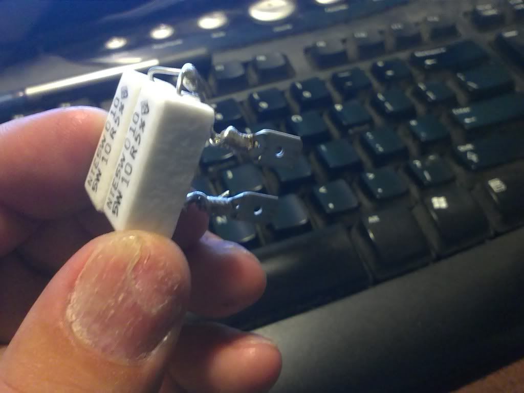

Built this little device
The problem: My LED gauge lights keep burning out. They're cheap eBay 194/74 lamps, so the regulation on the lamp is clearly inadequate. The dimmer rheostat on my car is burnt out. I have 2 good ones, but someone's done something with the wiring, and I know from experience that as soon as you do that, chances are the first thing that happens is you burn out that rheostat. Instantly.
What I really SHOULD do is figure out what was changed, and undo it. This is the plan with the help of my shiny new 1990 TEWD. In the meantime, I just want my dash lights not to burn out in a matter of a couple of weeks.
Given that the lights actually work, and don't burn out instantly, I figured that what they need is just a little extra safety margin. The rheostat was bypassed using a length of wire with a pair of male spade terminals plugged into pins 3 and 4 of the wiring harness connector. Given that I've installed LEDs, I'm not going to dim the lights anymore... Well, not really, and I'm certainly not going to get a linear response from a rheostat anyway. (I might build a PWM controller in the future. I think it'd be kind of a cool project, but I'd have to isolate the dash lights from the other things on that lighting circuit, and I'm not going there now.)
So... A simple idea. A resistor to induce a voltage drop. I tried a single 10 ohm/5W resistor at first, but the climate control doesn't really like it, and will decide to shut off. It visibly dims the dashboard lighting as well. Not terribly so, but noticeably. I actually kind of like that at night, but I don't like the climate control deciding that it's TOO dimmed, and shutting off. I COULD have gone back to the store and bought a smaller value resistor, but instead, I decided to make use of Ohm's law, and just paired the devices. Half the resistance with 2 in parallel. I also get twice the power dissipation, so it should be good. With a little luck, this is enough buffer to the LED lamps so that they won't burn out right away.
I bought enough of those LED 194s to do the marker lights and sth, but with the performance in the dash, I'm just not going to. I guess I'll use them for other 12V PC based projects, where the 12V provided isn't going to climb to ~14V ever, and be nice and regulated. They will probably last a good long time that way.

Wouldn't it be easier to buy better LEDs like from superbrightleds.com? I am using their LEDs for my dome, courtesy, turn signals, parking, license plate, reverse, and brake lights and they work and look fantastic.

It would have been easier if I had bought them in the first place. I didn't, and the extra $1.49 spent on a couple of ceramic resistors is still cheaper. The lesson here for the reader is partially about the solution to the problem, and partly about avoiding the problem in the first place. I'll use the LEDs that I bought (Actually, the slightly reduced brightness at night is an improvement. They're still a very nice white colour, just a little less harsh.)
