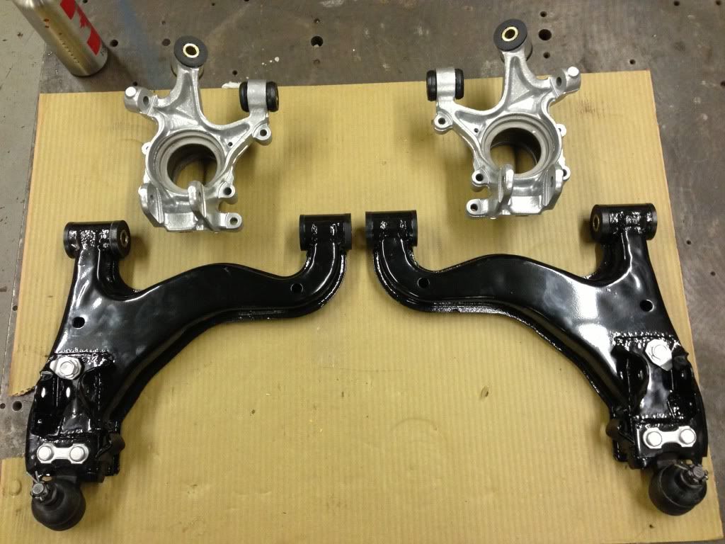

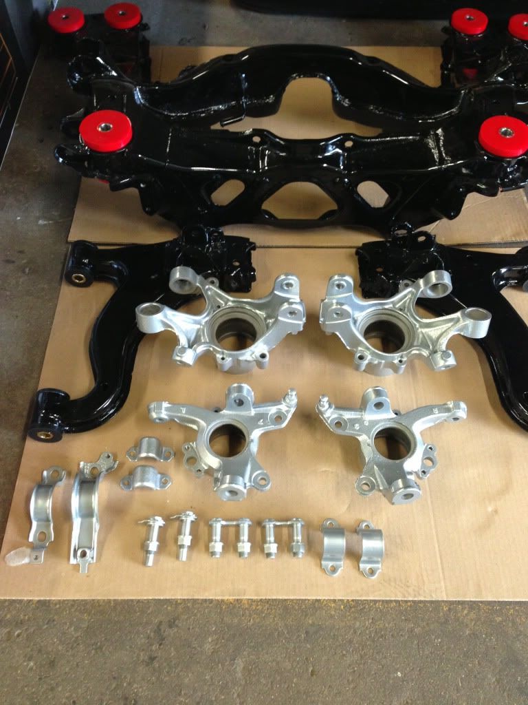

Picked up more parts from the powder coater.
very nice.

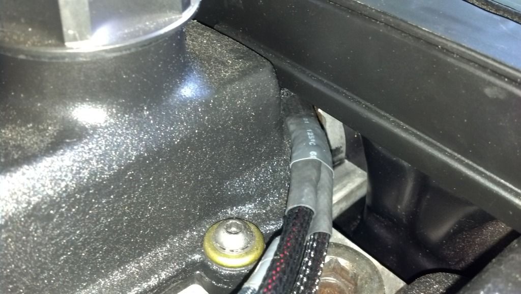

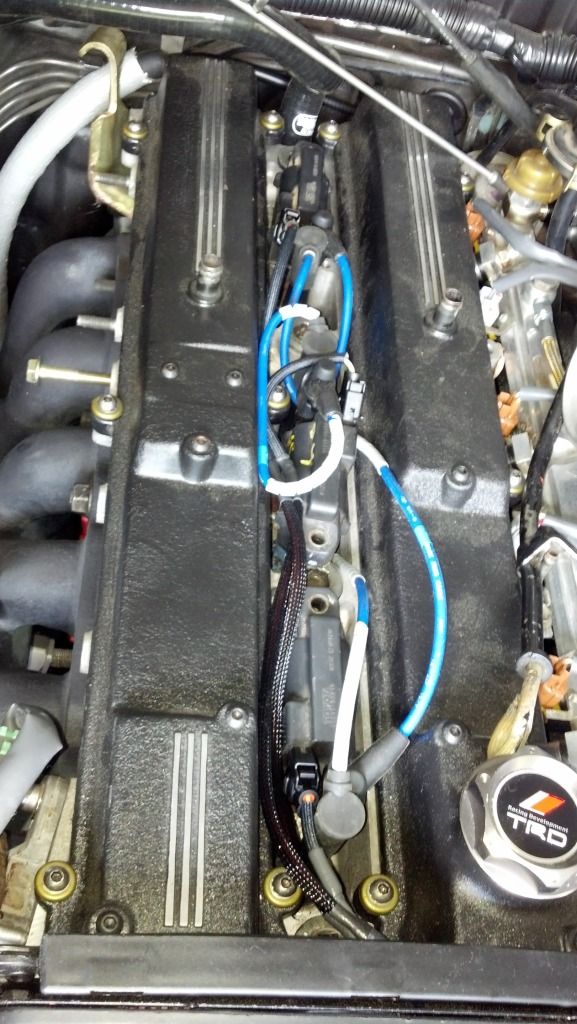

Finally did the IS300 COP mod.
http://img.photobucket.com/albums/v444/supraguy7/Supra%202012/IMG_20130622_145330_804_zps93d609d0.jpg[IMG]
[IMG]http://img.photobucket.com/albums/v444/supraguy7/Supra%202012/IMG_20130622_151047_288_zps758c2181.jpg[IMG][/QUOTE]
What is the IS300 COP mod?
