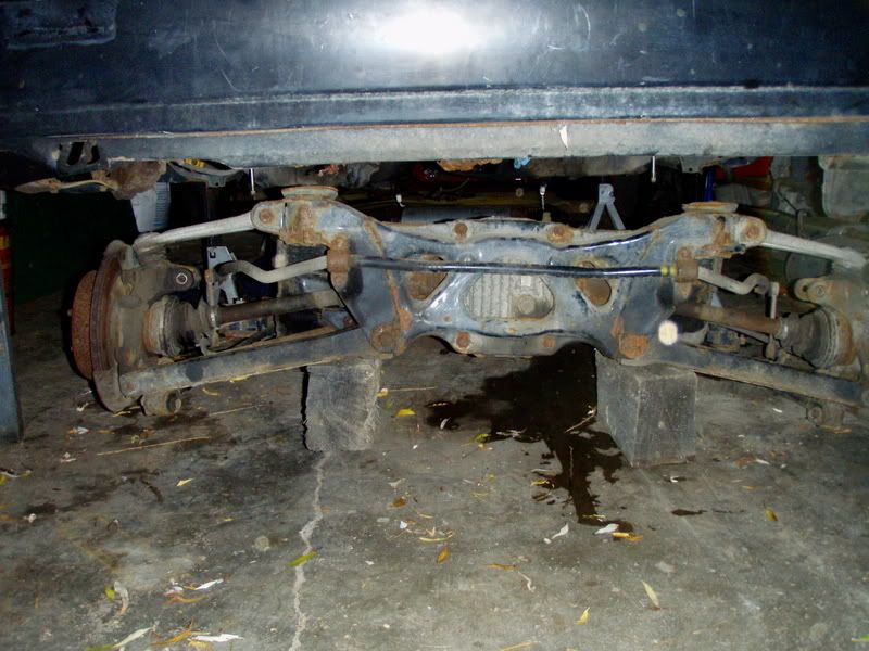

justin: that was my intention, but i couldn't find an '89+ subframe. :(
ian: do you have pics handy of the extra bracing? can extra bracing be welded onto mine to make it like the '89+? bryan is pretty damn handy with a welder!

i apologize for whoever i stole this pic from (someone selling it)- but this is apparently an '89+ subframe:
and this is a pic i graciously stole from IJ. :)- note the welded diff area:
i'm hoping to accomplish something along the lines of the above- as i never want to have to drop the subframe again. (not that it was difficult, just don't want to do it again. ;))

thanks! as soon as i get my subframe sandblasted, i'm bringing it to bryan to work some magic on!

thanks, will. :) what's truly sad, is that i see better chassis than mine going to the scrap yards. :( that's messed up!

shaeff said:
that looks familiar. mine was a bit worse and I mangled it trying to get the control arms off, so I got one sent from south carolina that just has a tiny bit of surface rust. :love: everything else cleaned up real nice with a wire wheel.

hey man, haven't seen you around here in a bit!
surprisingly, my rear control arms came off easily with the rattlegun, PB blaster, 5lb hammer, and a centerpunch.
pulled the nuts off, pounded out the eccentric bolts. now the fronts (when i didn those a little over a year ago, haha, i had to cut the bolts in half with oxy/acet. torch. that sucked!) however, i managed not to break anything that i didn't want broken!
as for the bushings, the subframe spacers i got from BIC, and he still carries them. the actual nylon bushings, i bought the very last set of them that's been made. there are some for sale in the FOR SALE section, though. (i paid $750 for the kit) mr sinister is selling them for a little less.
