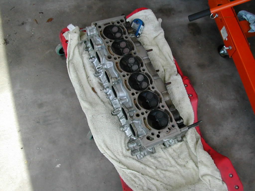

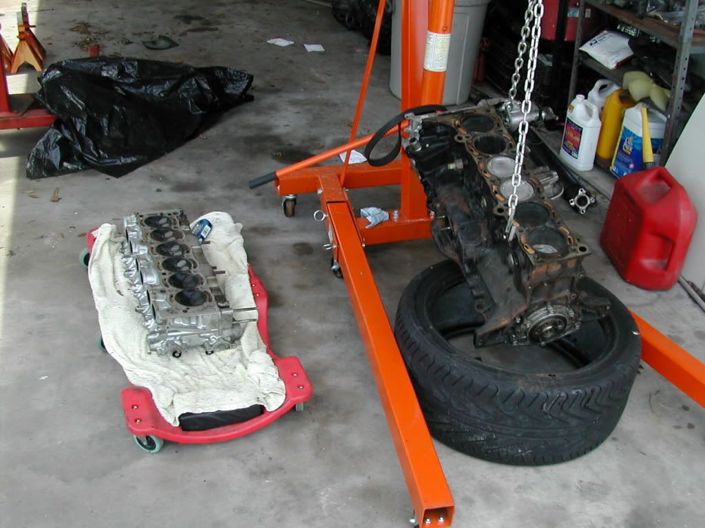

So desided to get the block and head ready to be taken away.... those poor guys :(
Pics?
Had to push the little gurly back and out off the way:love:
My head
Look at them all playing together :naughty:

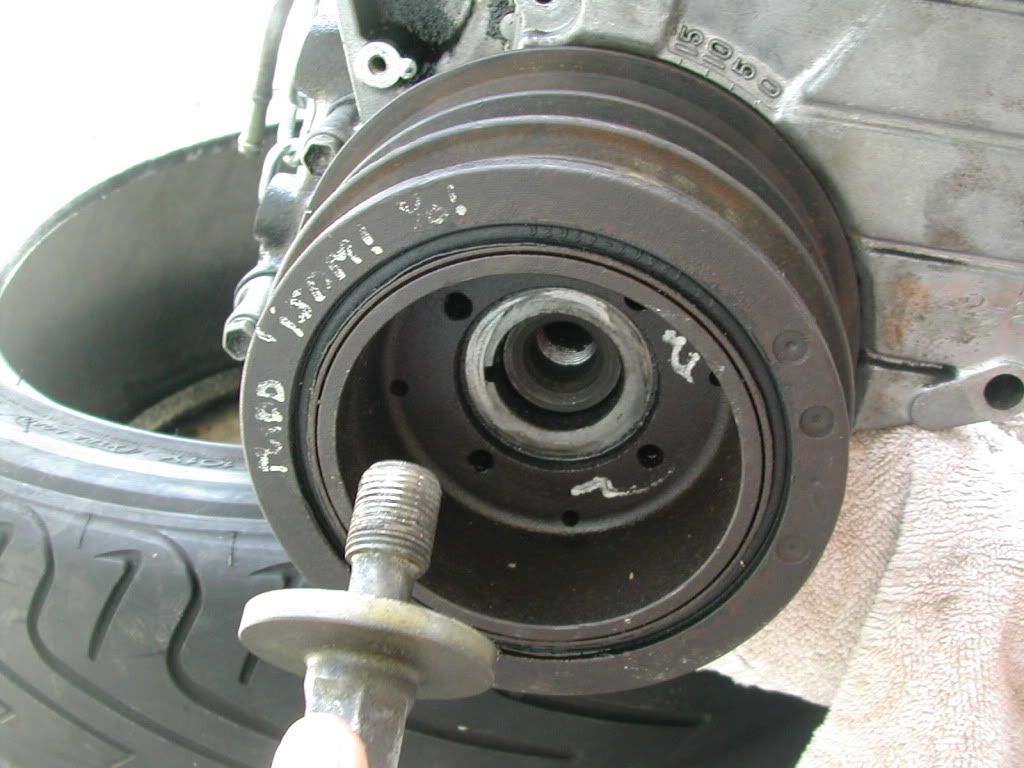

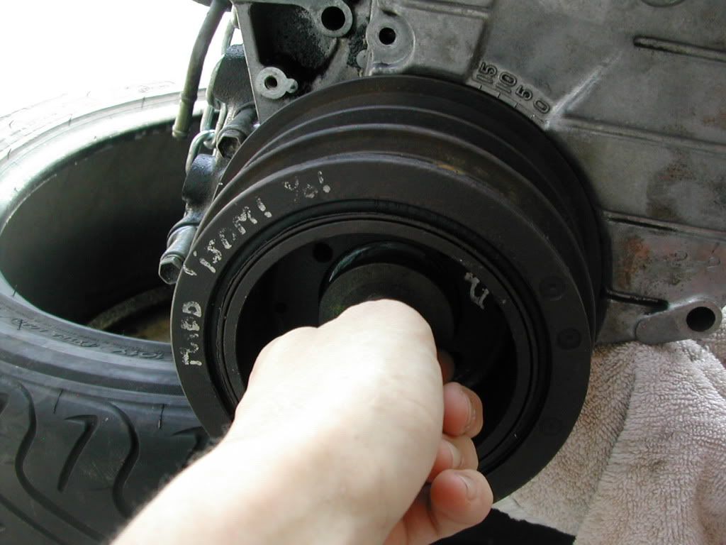

So its stuck.....
:1zhelp:
With the twist of two fingers.....:naughty:
Its off:biglaugh:

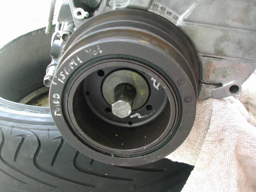

Ok so my fingers didnt use the 650 ft. lbs. of torque the tire shops impact gun did....but its off so im happy.

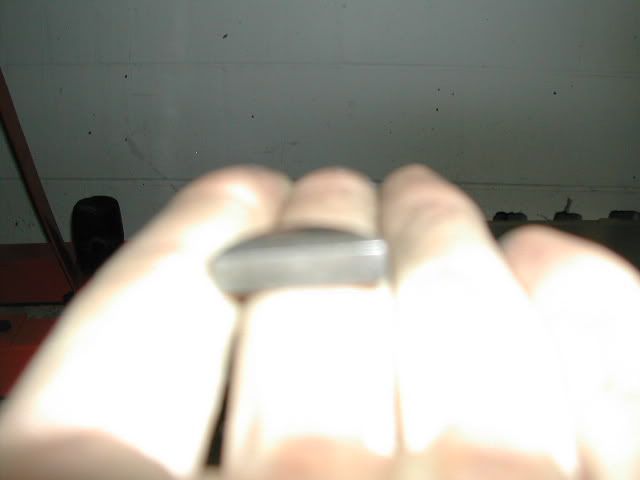

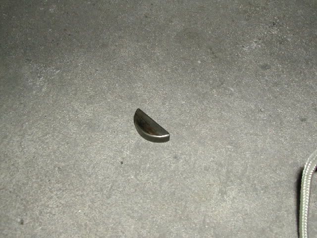

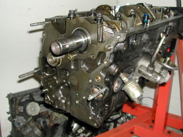

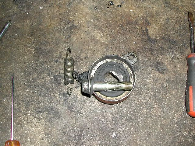

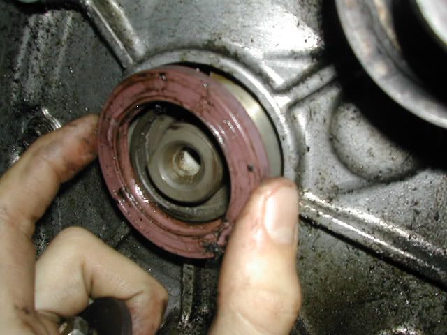

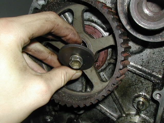

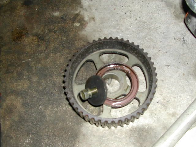

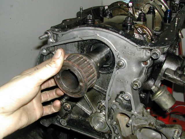

First off this little piece feel out when I first pulled off the main pulley. Anyone have any idea what it is? Cause im not to sure.

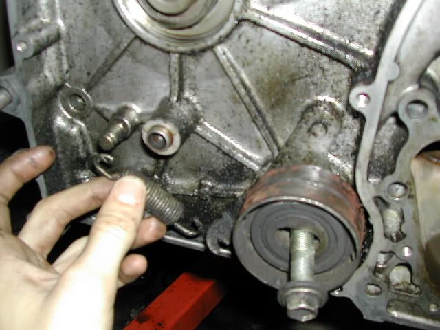

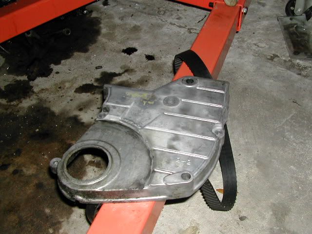

Lower timing plate cover. and timing belt
Oil bump gear

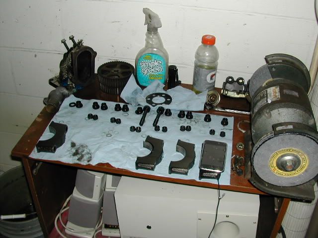

Just for me to remember

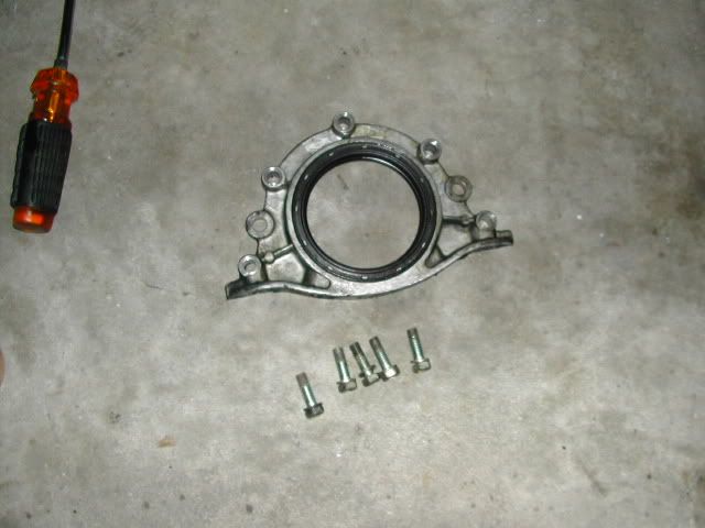

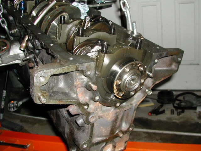

Starting taking off the main caps, and realized...the rear plate next to the flywheel, had to come off...only problem was that it was againt a engine stand, rookie move YES! I know, but we all learn somehow :D
So my new engine stand, cause they are peice of crap anyways :: lolsign ::

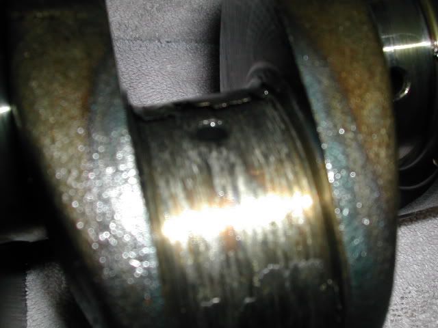

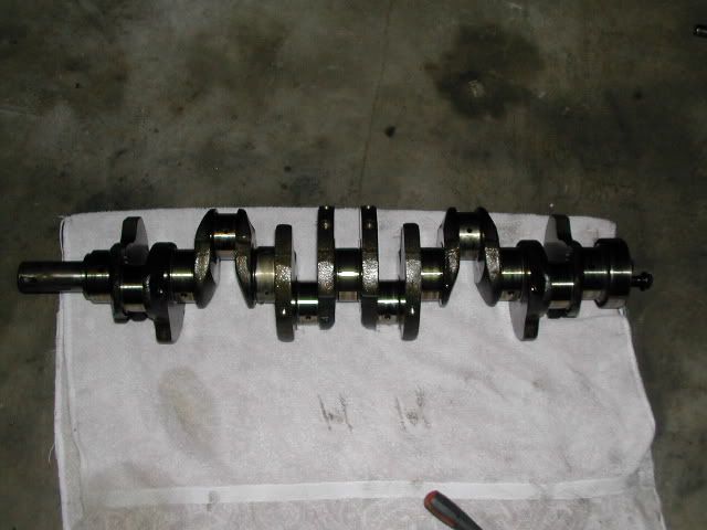

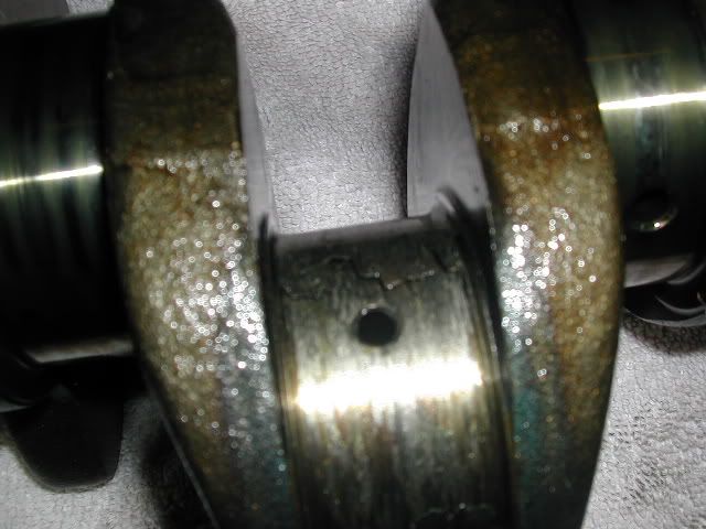

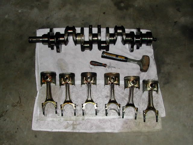

Got all the main caps off then the rod caps off, and removed he crank....they I noticed that all the bearings didnt come off and I think I found what my problem was.
*Note
The following are from the same crank lobe.
So if anyone has any ideas about this...im going to post a seprate post in the 7m-gte forums just about this problem Cause idk if anyone reads the little sub titles for each picture. So ill see what happens then.

The piece that fell out when you took off the front pulley is the keyway for the crank pulley. This keeps it from rotating. If you look at the crank pulley where it goes onto the crank there is a slot in the pulley and also in the crank shaft
As far as your crank, Yeah.. Thats a spun rod bearing. Thats probably why it was knocking, so you'll have to bring it to the machine shop to have them mic it to see if it is salvageable. If so they will turn the crank and then you'll have to get oversized bearings for it. They will probably provide the bearings. Most machine shops do. Either way, that crank is going to need a lot more than being micro polished. If it cant be salvaged, start looking for another crank.

Ok cool, im glad someone is able to tell me what I did...I noticed it and was like....that cant be good. So ill take it to them tomorrow and see if its salavgeable. If not....I have seen a few cranks in the for sale secton. So ill have to wait and see :) Thanks bro...i'm so glad I finally know what I did now, and I know im not wasting my time.

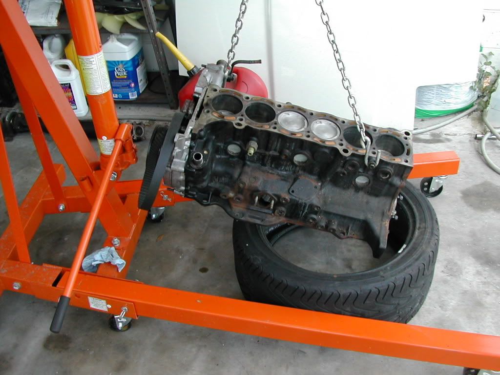

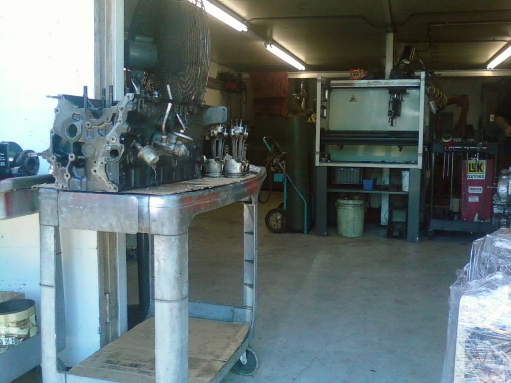

I got everything taken apart last night...and desided to go ahead and take everything to the machine shop :)
Something very cool is the guy that owns the shop like to take picstures as much as I do, (i dont think he has any idea) and he said that he would take picsture during the machineing process, for my build thread. But this is what I left her at :( poor girl

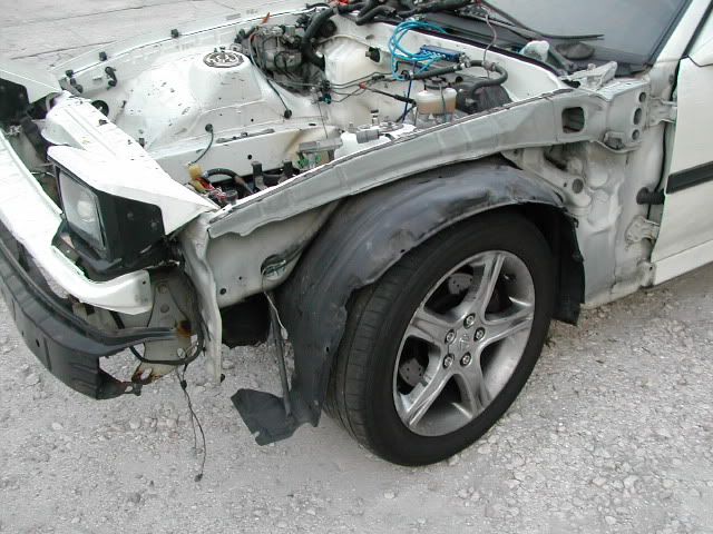

So while the motor is being worked on...im going to start and finish up a few things.
Things to do:
1 .Find replacement pearl white driver fender and headlight cover
2. Replace broken attenia mast

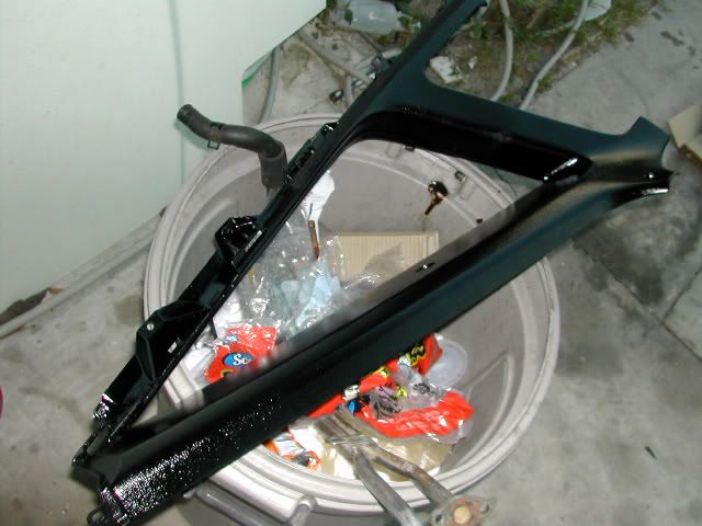

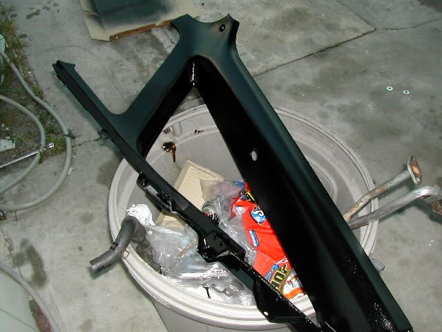

3. Respray interior (black)
4. Install spacers on wheels
5. Refinish the lips on the IS200 wheels

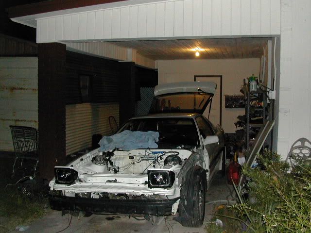

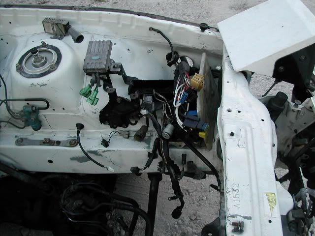

6. Replocate engine bay fuse box, to inner fender wall.
7. Install smoked headlights, turn signals and side markers.

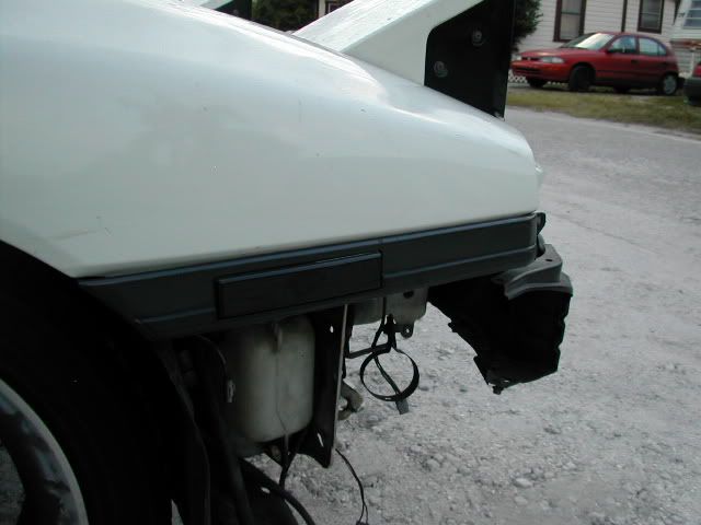

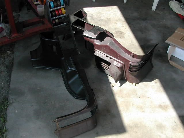

So I have already done a few on this list (its just a copy of the list I have on my computer) like headlights, turns, and sides, I started to respray the interior some today, just to get a feel for it. I dont think the one peice I srayied turned out to bad. Anyways, im really wanting to get started on relocating the fuse box. Anyone have any tips on doing this? Has anyone done this and or done a write up on it?
Here are some pics of the new turns, and how the rest of the body loks....very dirty. And the fuse box before I start moving it.
Smoked Side Markers
Close up of the marker
Last look at the fuse box mess
The one piece I resprayied

Ok so my machine shop contacted me today, and they told me that i'm going to need new pistons and rings. Can anyone recommend some pistons tat aren't meant to go balls out with like JE, CP, ect. Some low budget pistons that are offered in at least .20 over from stock bore. Would it be better in my interest to just get another set of stock 7m-gte pistons? That is of course if the block is still in stock tolerance's to the pistons.

Ok I have so the block is done getting hot tanked, and the pistons are no good...so instead of paying for new ones, i'm going to pay the machine shop for the work they have done on my bearing set, and then just save up for a replacement motor. Hopefully something that will last for a bit, and that I can use to daily drive...cause this not having a car is getting old, really fast lol. So over time I will just drive the supra, and build the motor :)
