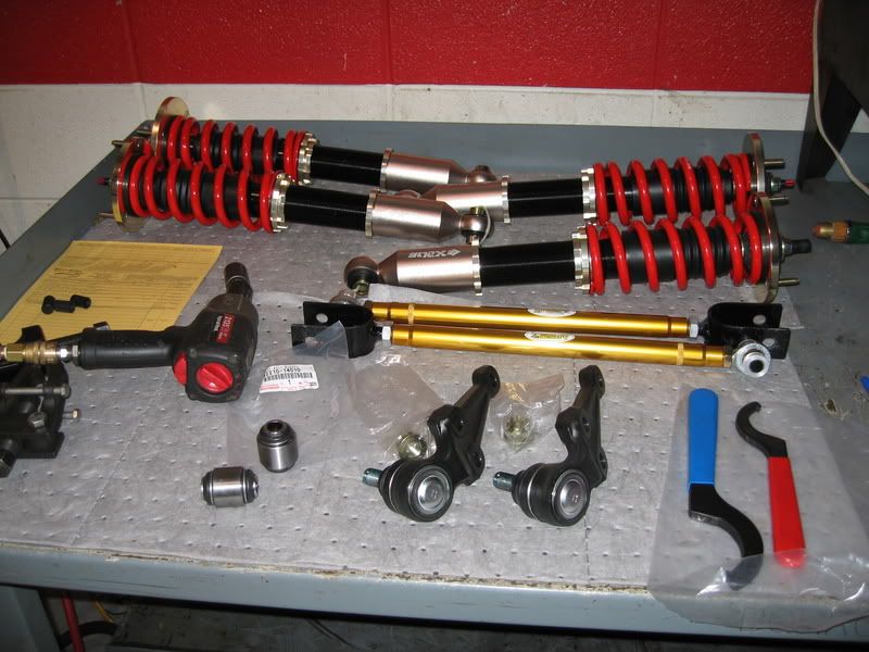

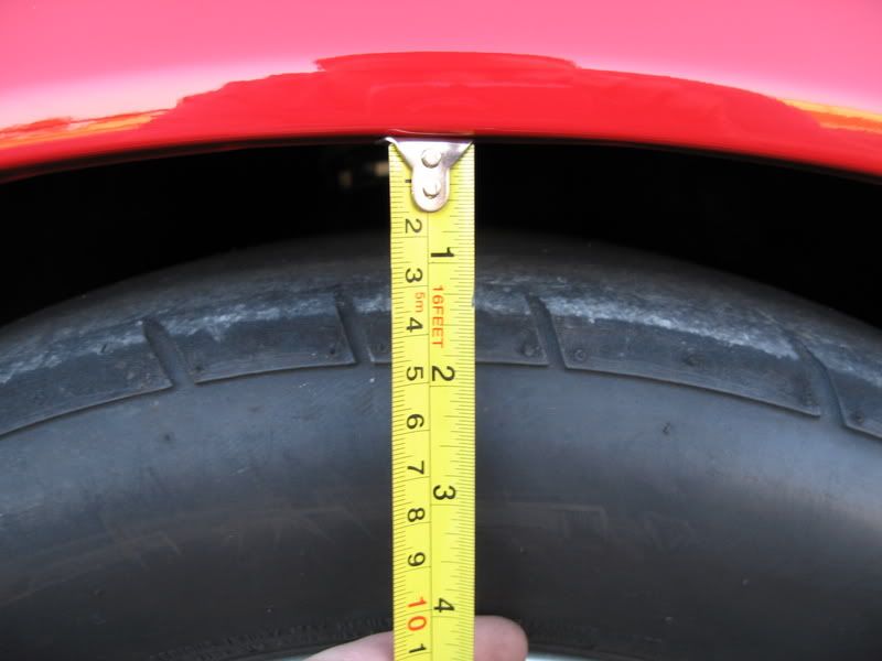

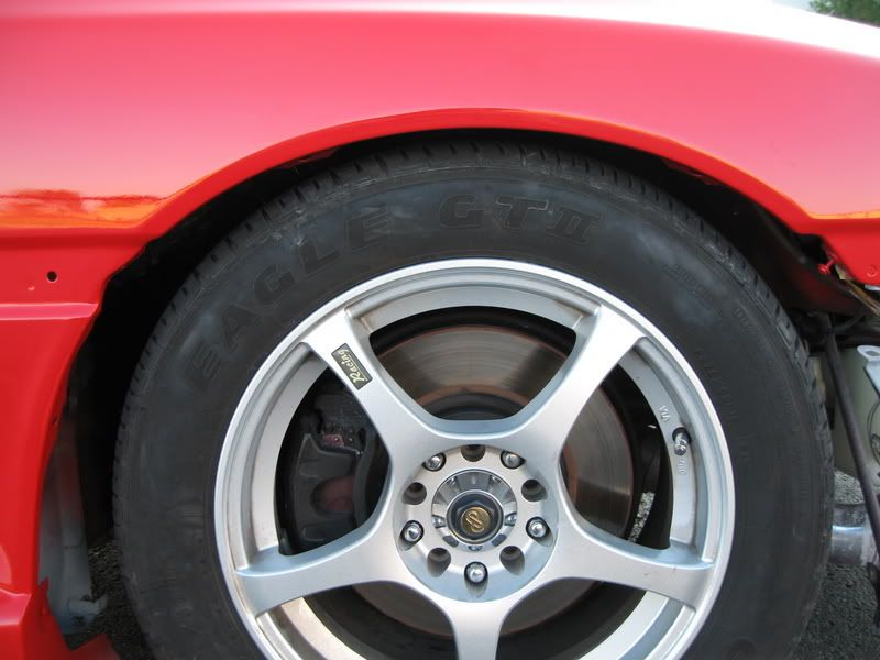

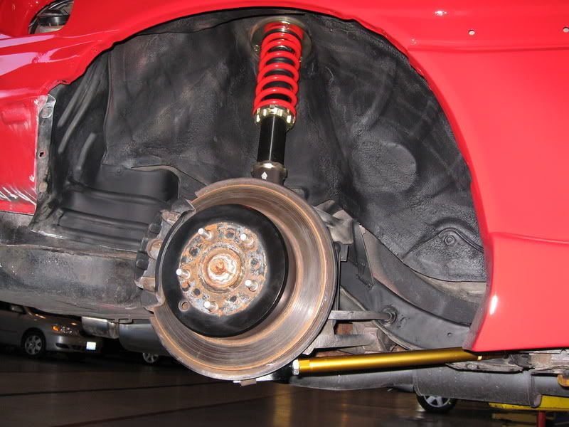

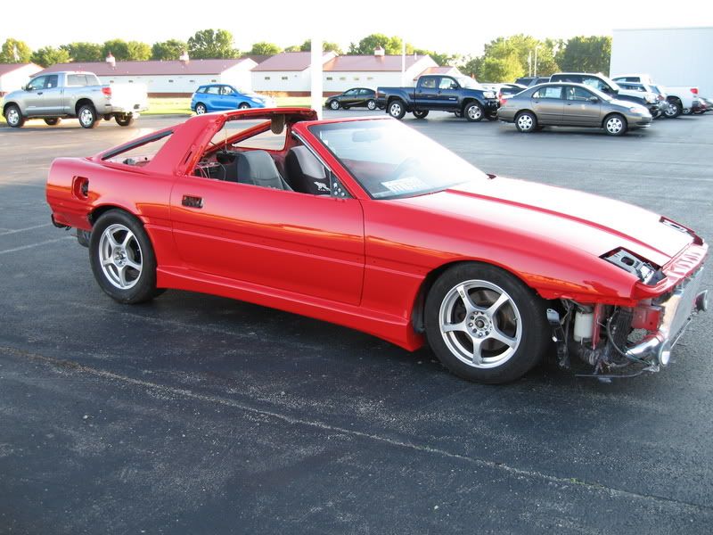

Got my suspension work almost done the last couple days. All the cam bolts came loose after soaking for a day in rust penetrant:):) I replaced the front lower ball joints and the lower control arm bushings in the rear, and installed the coilovers. I need to adjust......not sure exactly where to put it....seems too low in front, dont know if I can fit once fender liners are in, front bumper has 4" clearance. I need to look at some other cars and see where they sit. Anyway.....first ever pics of red rocket lowered!

now we're talking! that beast is down in the weeds where it belongs now! should look awesome with all the body panels on it. I love that you took off all the body panels to be painted, you get extra corner coverage that way. When I did my bumpers I did the same thing, definitely worth the extra time.

Thanks guys, I can find flaws....with anything, it's my nature, but I'm happy with it. Did the alignment today so I can put the bumpers on tomorrow:)

Ya, I'm diggin' it. I had it sitting next to my black one today and it looks soooooo much better that low.
