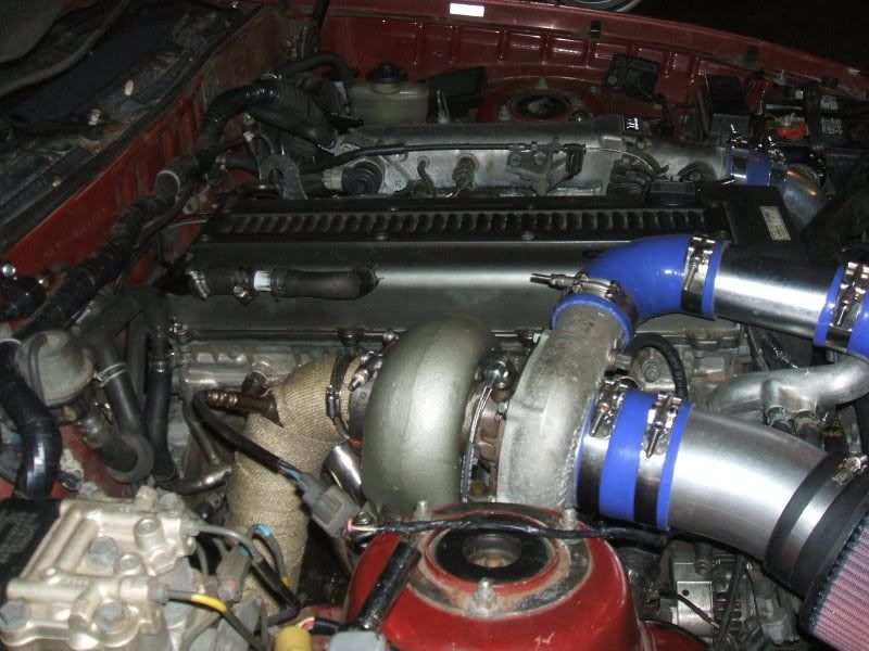

My welders wire feed motor broke today so I had to borrow my friends and hook my gas up to it. That kinda sucked but oh well.

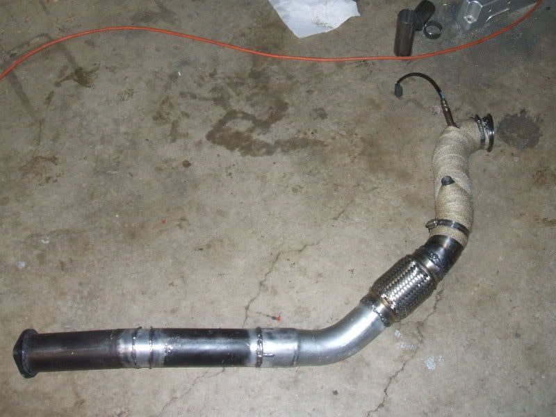

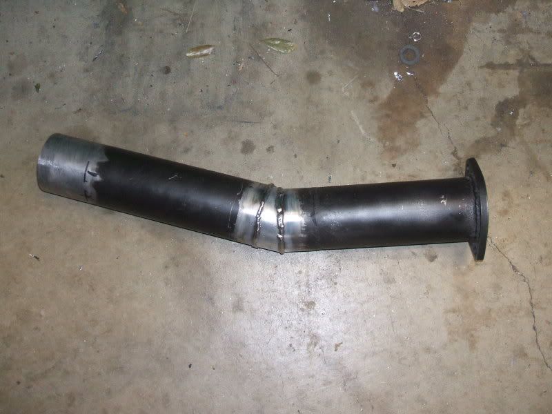

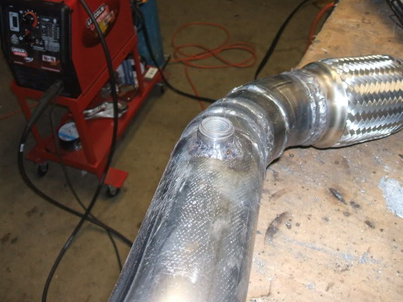

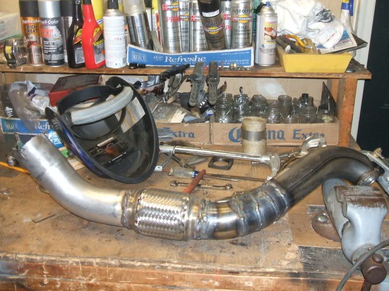

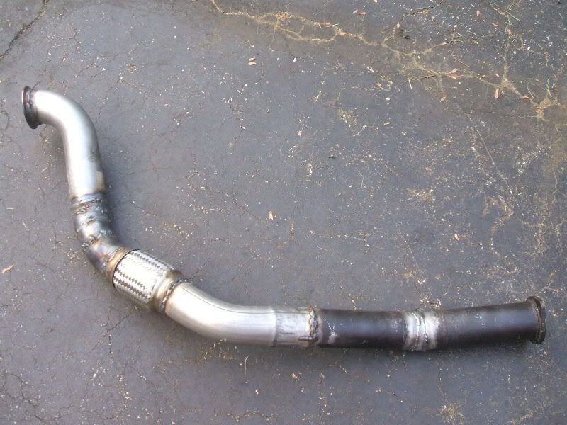

I started my downpipe today. I was kinda expecting it to be a little fun to make and such but oh boy, it was painful...literally. Ive got such bad welders burn right now thanks to short sleeves.
Anyway on with the pictures...

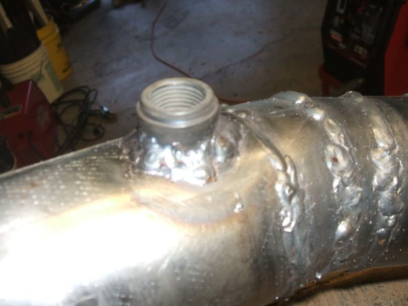

Slowly but surely it progressed to look something like a downpipe. And i got my wideband bung welded on.

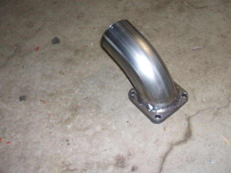

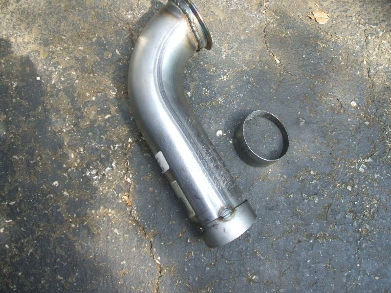

Wastegate dump tube

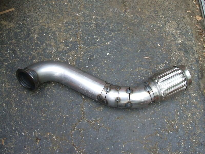

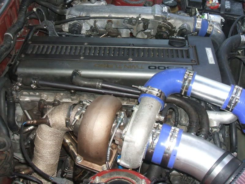

And its done after a little exhaust wrap.
So thats all great news, time for the bad/possibly catastrophic news. :(

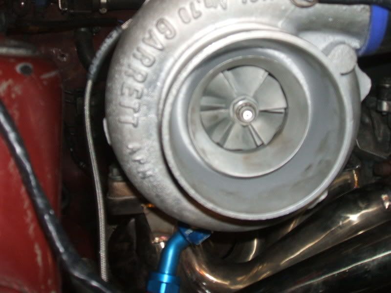

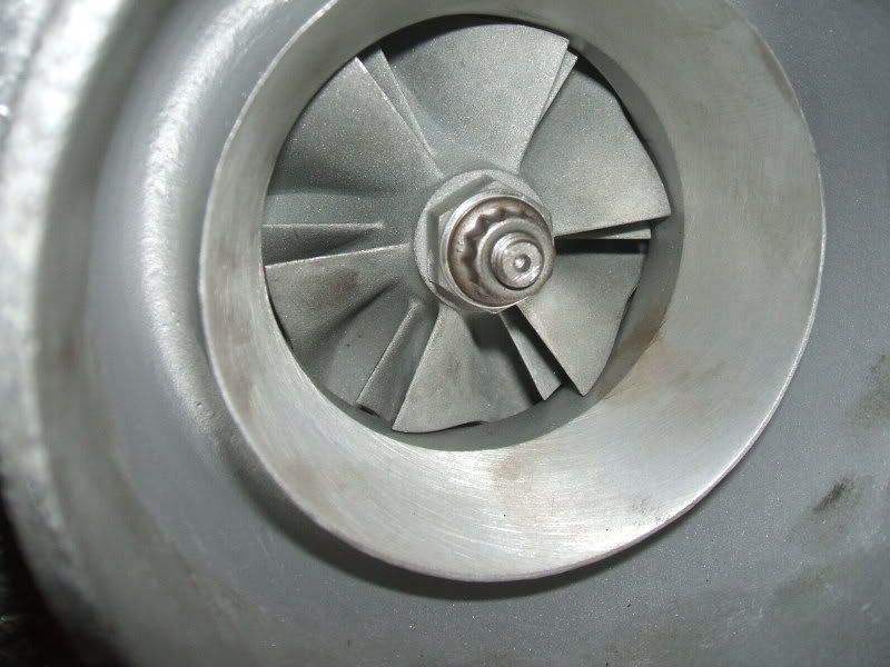

I went for a test drive after setting a bunch of stuff in E-Manage. Only as soon as boost was generated I was getting a LOUD tapping noise from the engine bay which I think could be my downpipe hitting my manifold/fame/whatever. Also after about 5 mins or so of driving I was making a very loud whine/squeal. It sounded really bad but the pitch didnt change at all with engine RPM, it was constant. When I got back home I let it idle for about 30 secs and turned it off. Waited an hour while I tried to figure out what it was. Turned it back on and it sounds completely normal.
Any ideas what could be making this noise? I know I primed the turbo right, pulled the EFI fuse and cranked with the oil feed disconnected and waited for flow. Connected the line and cranked more to get oil in the turbo. Put the fuse back in and started it up. I am little confused.

Looking real good. Hopefully you'll make it up to the Philly meet so we can see it.
BTW, the y-pipe didn't clear my motor mount brackets and I had to pursuade it with my "Thor" hammer. I think it's because I have an 89+ and didn't have to use the BIC mounts.

werewolves182 said:
No shit, I had no idea that would happen. Sorry for no heads up about that. Where was the pipe hitting?
Nah, it's no big deal. Don't sweat it. The piping closest to the engine was hitting the motor mount bracket.
