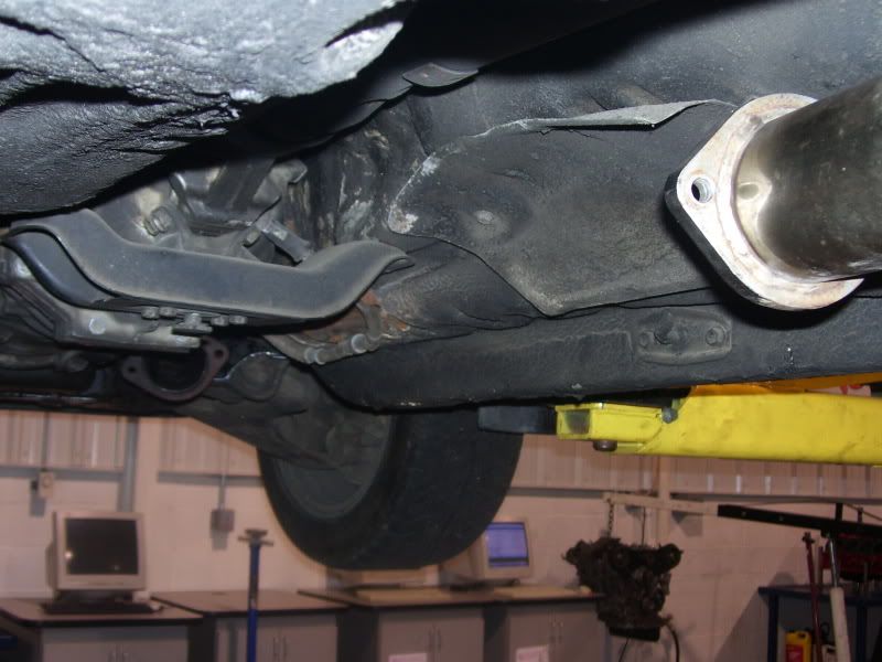

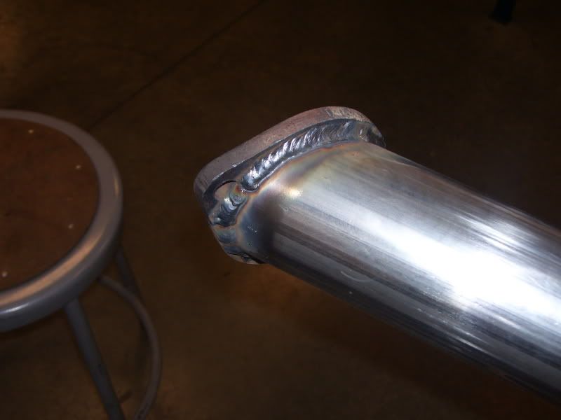

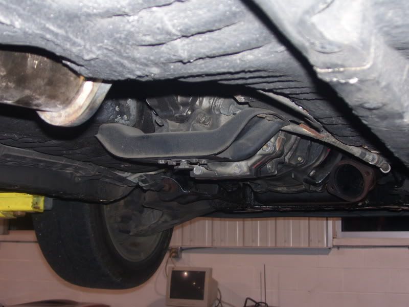

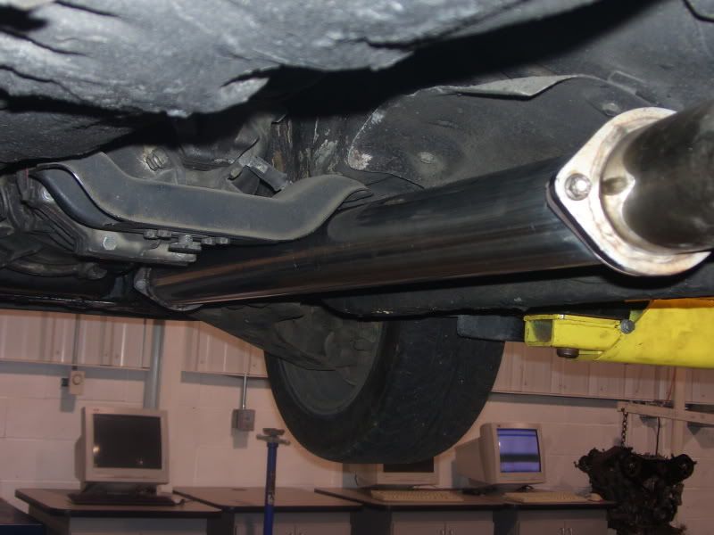

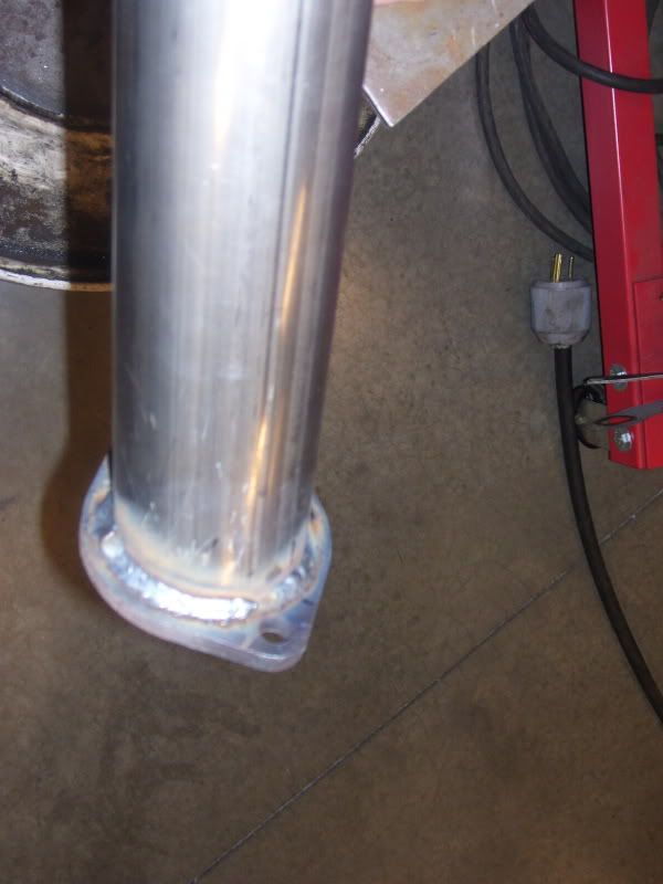

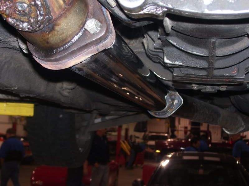

O and here is the elbow you guys asked to see off the turbo, definitely turned out very nice...
