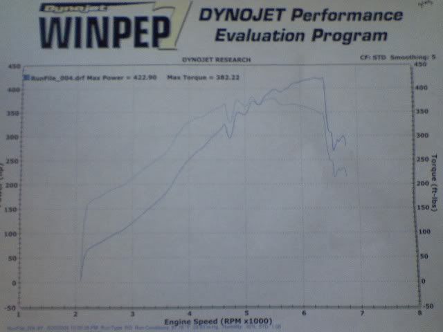

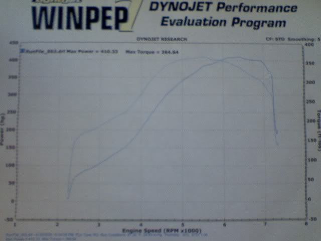

Thanks man glad to hear I inspired someone in some way. I was finally able to get her back up on the dyno again yesterday. Shes still a little fat up top and after about 5 pulls fouled my plugs which called it a day.
My wideband took a shit on me in the midst of tunning so I couldn't go any higher than 10psi. My timing MAP is still really conservative as I don't have anything yet to monitor knock. I'm just waiting on a new sensor right now for the wideband so she can really start to breathe.
These are the 2 dyno graphs the 4th gear pull is the last one I made of the night, and as you can see plugs started shitting on me.
3rd gear 410rwhp/365rwtq...
and 4th at the end of the night 423rwhp/383rwtq...
This was again on 10psi and really poopy 92 hick ville gas:sarcasm:.
