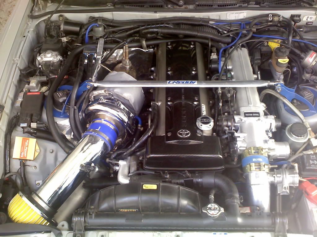

As some people know I was running my 2jz mk3 BPU'd for about 2 years.

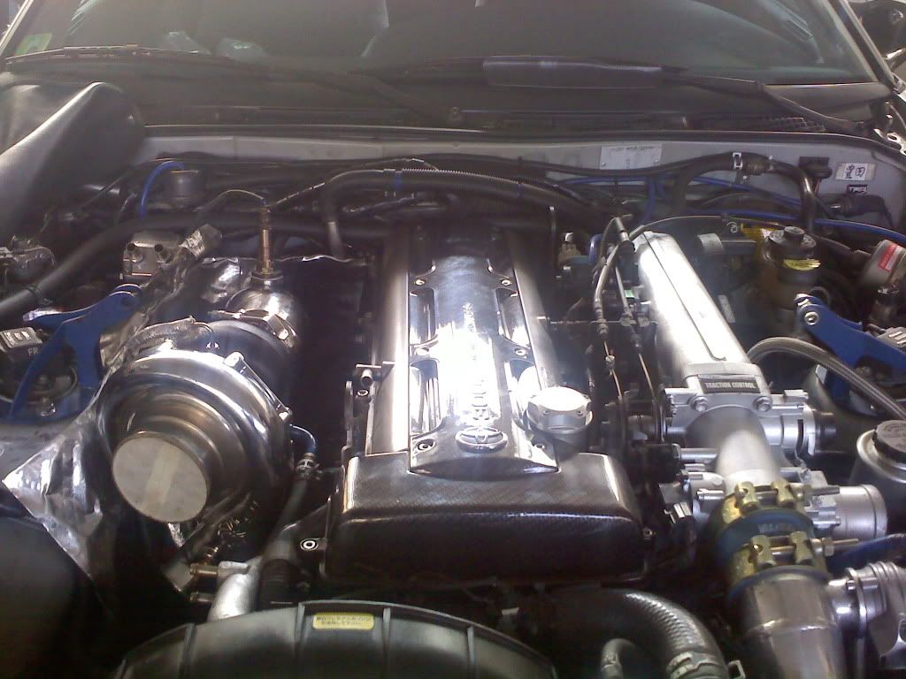

Here's a picture of my engine bay with the stock 2jzgte:
There is a build thread of mine on the JZ motors section.

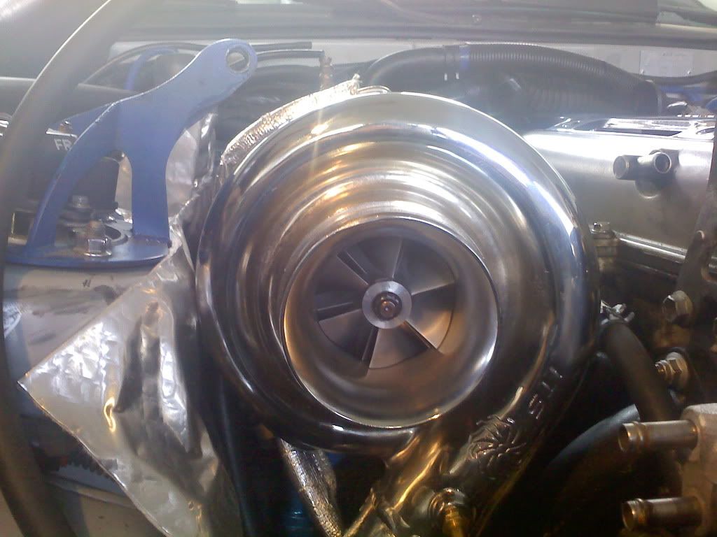

Then I started purchasing individual parts...manifold,turbo,wastegate,etc.,
Turbo: ITS 72mm,T4 divided,DBB - water cooled with 0.70 A/R on hot side
Exh.manifold: HKS GT T4 divided ceramic coated (used part from a member)
Wastegate: HKS GTII 60mm wastegate
Intake kit: Greddy Air Inx kit

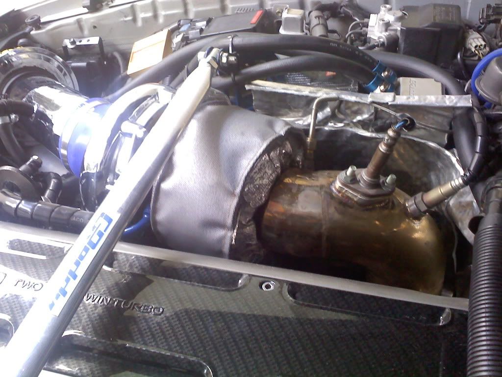

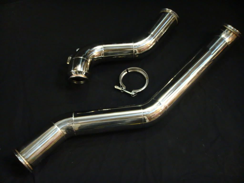

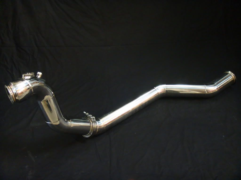

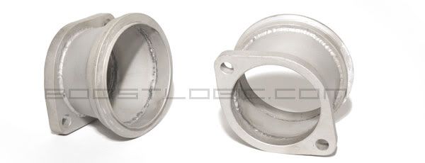

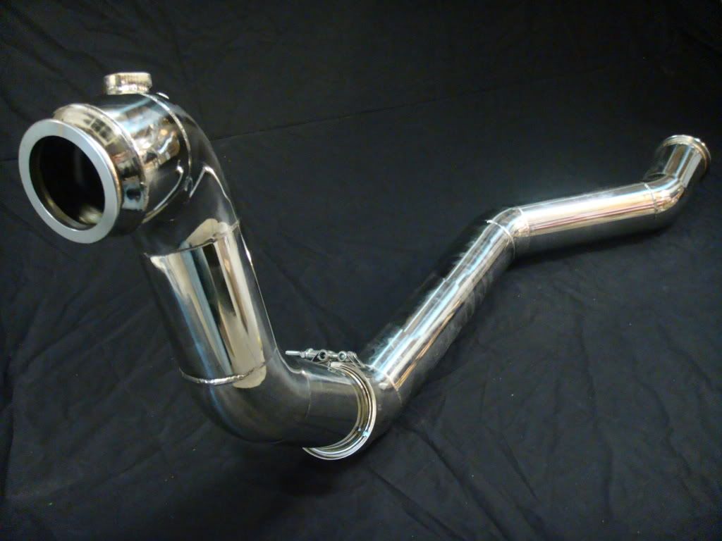

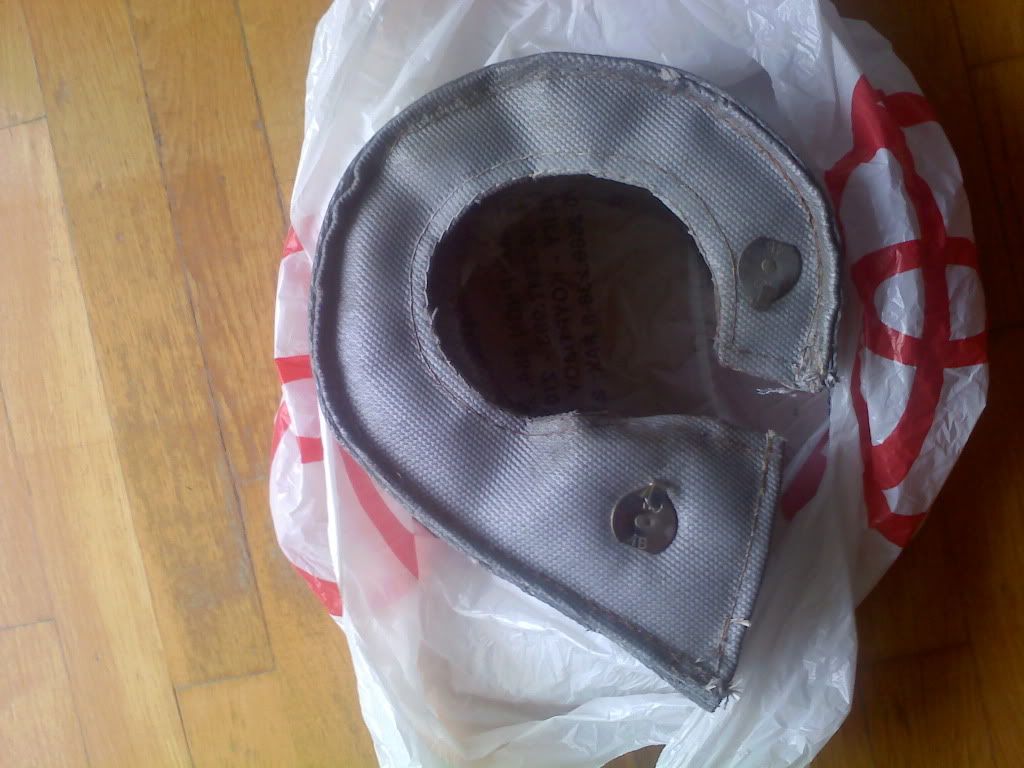

Downpipe - Mid pipe: 4" DP and 4" midpipe (ebay) Very good quality!

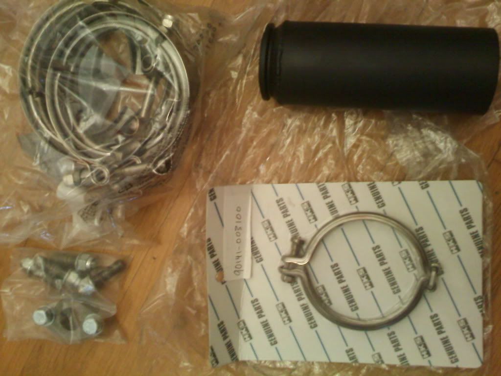

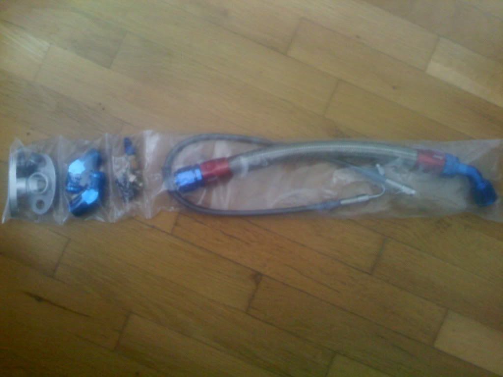

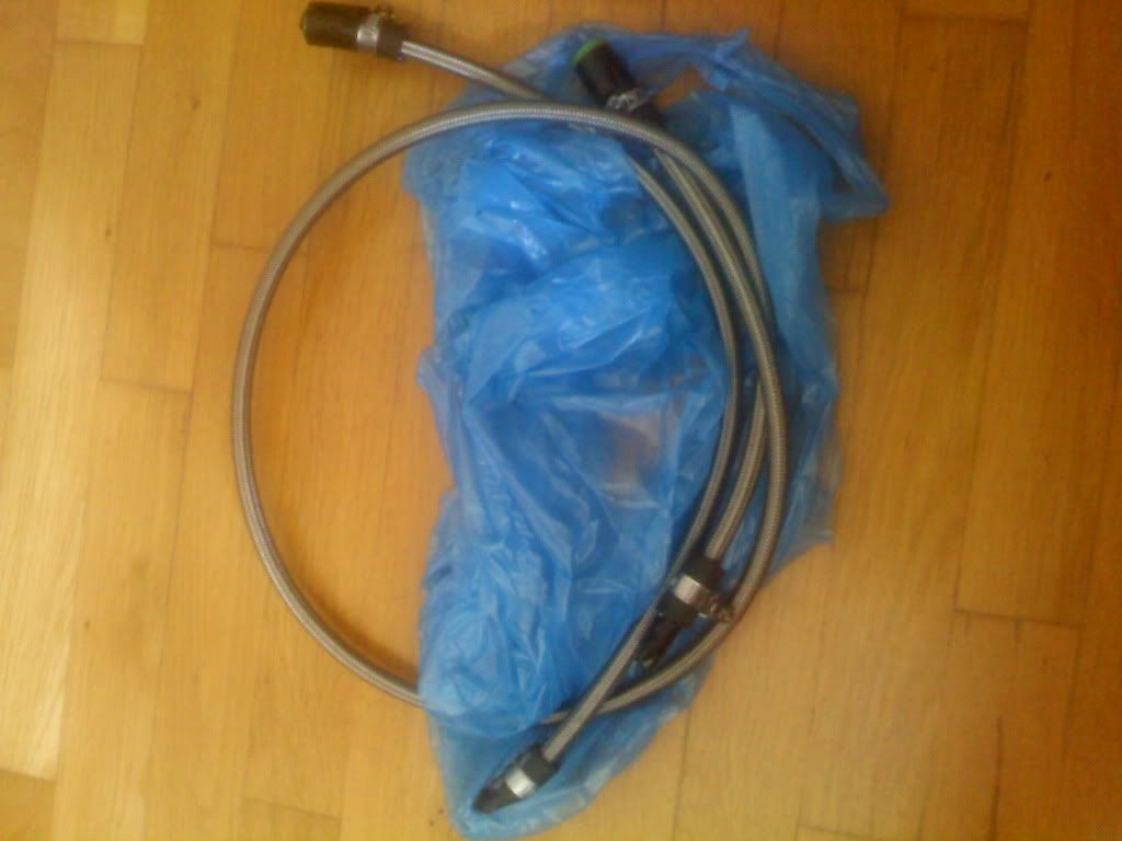

Other single turbo parts:
Boost logic oil feed / return lines
Boost logic 3' to 4' adaptor
Boost logic T4 turbo blanket

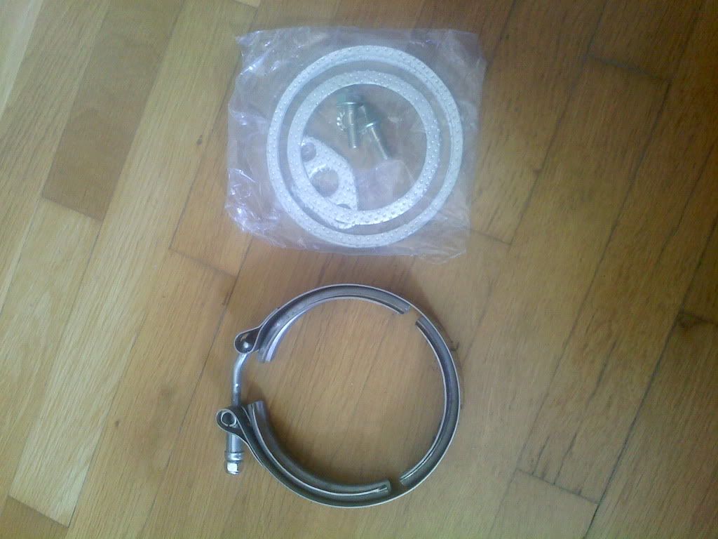

PHR heat coated screamer pipe,HKS WG V-band clamps,HKS Exh.manifold studs & bolts,
and exhaust V-band clamps 4"

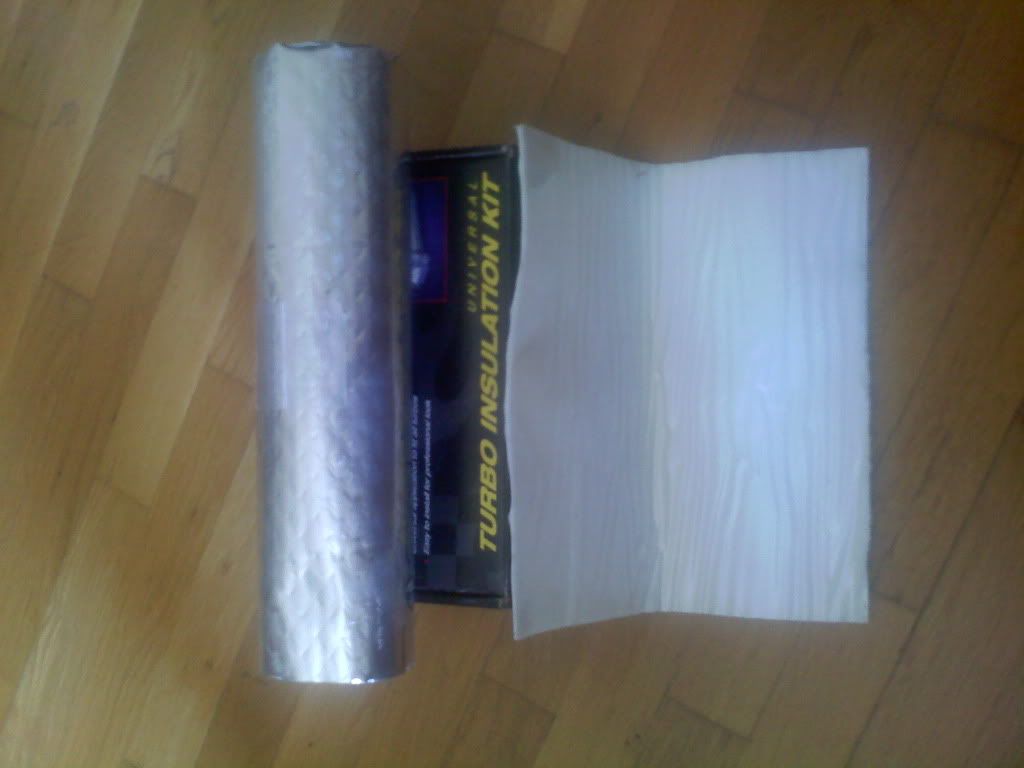

DEI turbo insulation kit / heat shield

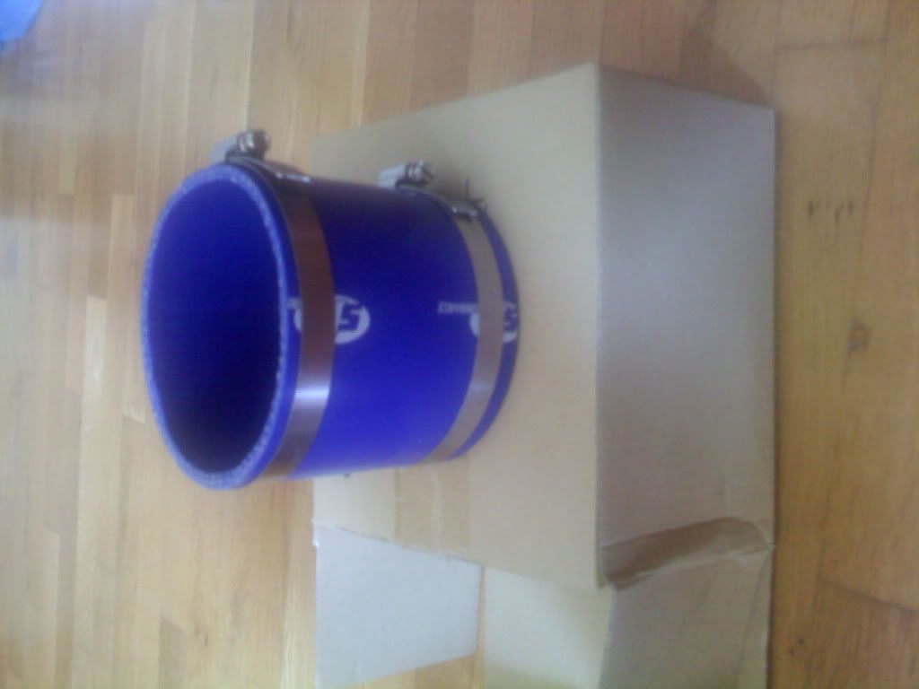

Turbo 3" V-Band clamp,4" silicon coupler & clamps,SS braided wastegate lines
And some other miscelenious stuff like vacuum hoses,coolant hoses,
hose's heat covers,clamps,PCV hoses for Greddy oil catch can,
custom pipe from turbo to IC with 2.5' silicon couplers and Heavy duty
T-bolt clamps...

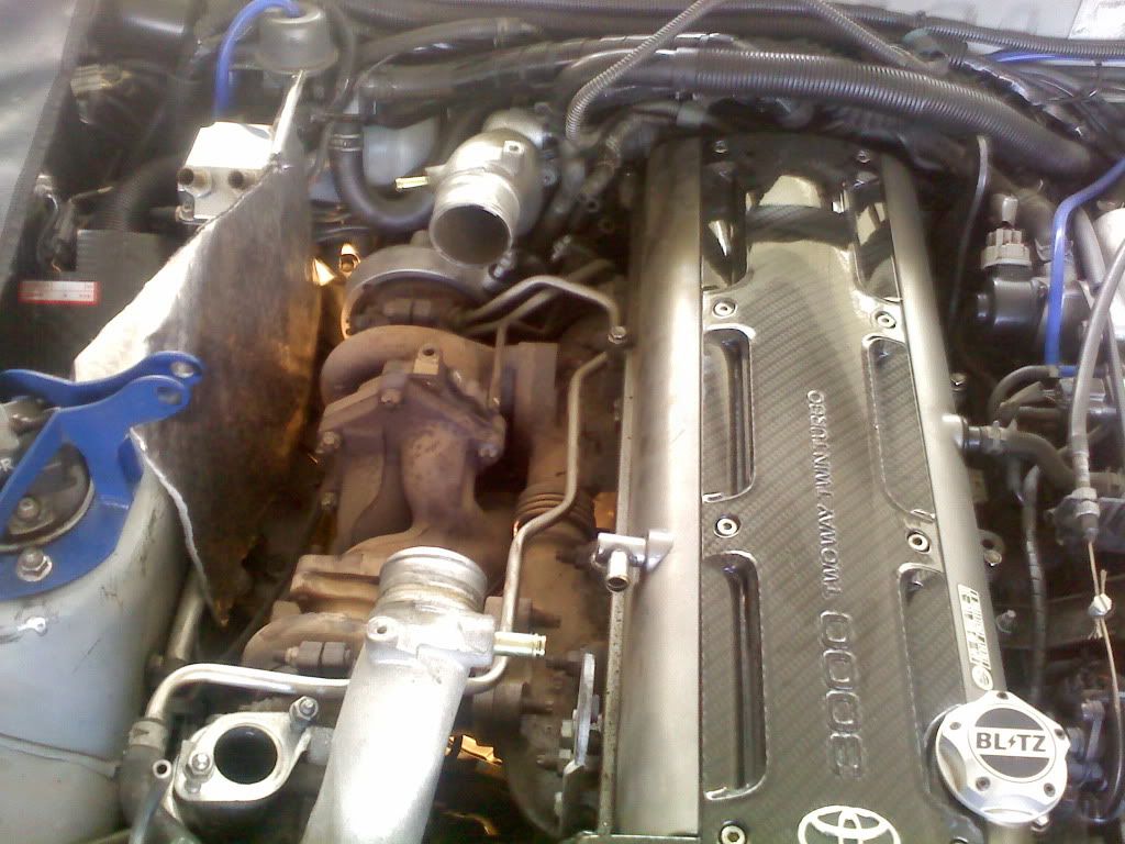

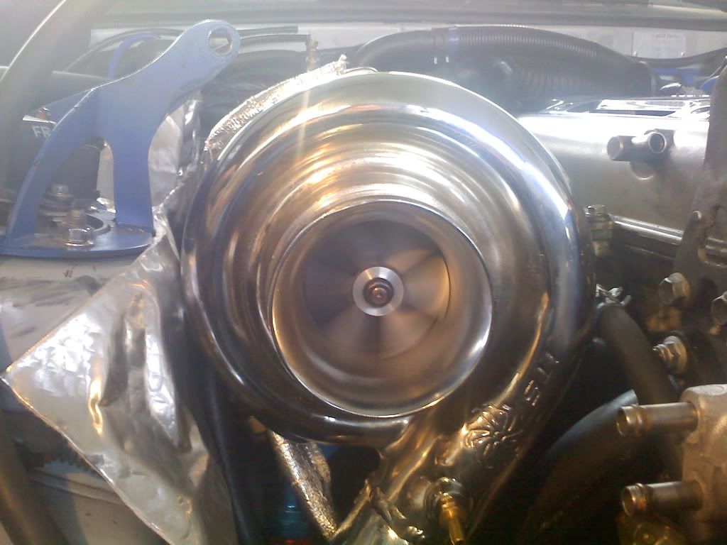

So with all the... my choise Turbo 'kit' parts in hand ,the installation took
place. Taking out the stock twins is a PITA :icon_evil
After 7-8 hours they were out! :naughty:
And now time for the single setup! :love::biglaugh::sarcasm:
SupraClaou
Sep 1, 2006
846
4
Athens,Greece

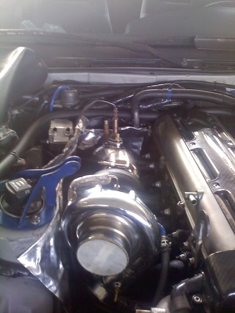

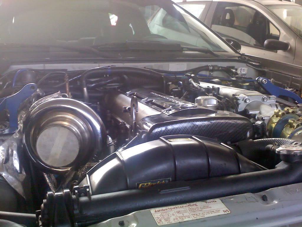

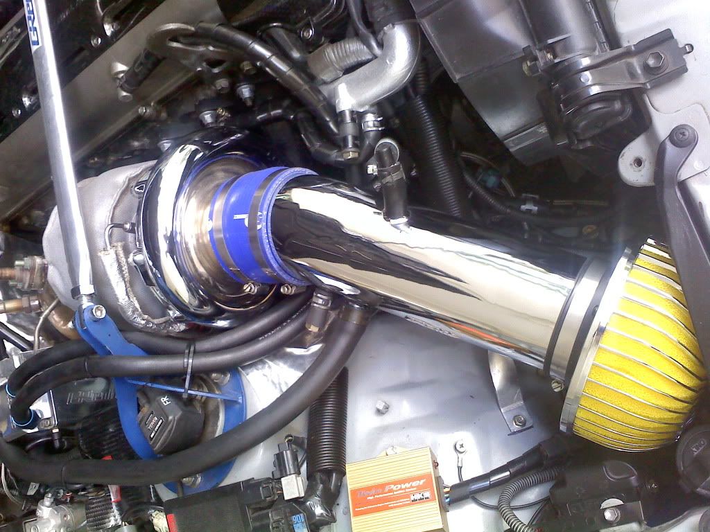

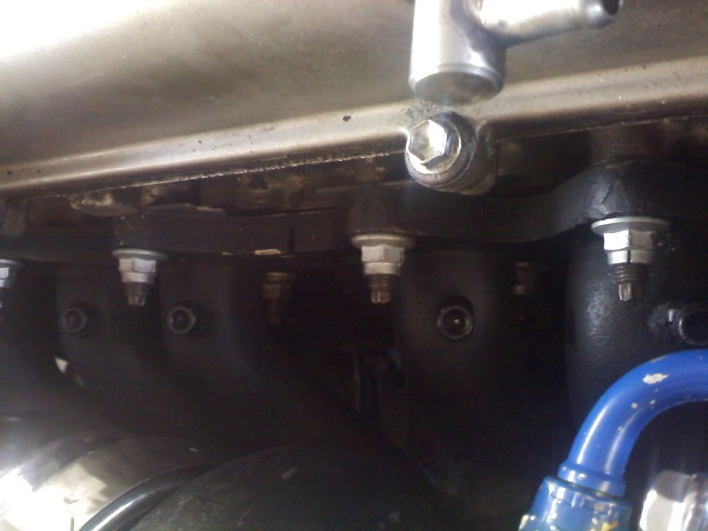

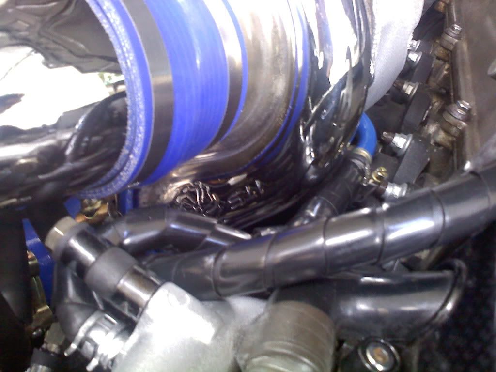

I've installed all the single turbo parts in about two days...
I didn't have any big issues...though I had to hit in 5mm a small spot
on the HKS exh. manifold to give a safe clearance from the chassis.
Also I had to take off the exhaust head studs to fit in the HKS manifold...
For my surprise,the ebay 4" Down pipe bolt on almost perfectly :sarcasm:
Though the 4" mid pipe needs to be re-routed at a welder :naughty:
The Greddy intake pipe fits perfect also_Oil lines looking good,and
the wastegate seats nice. I have to mod a little bit the PHR screamer pipe so
it won't shoot flames on my crossmember :sarcasm:

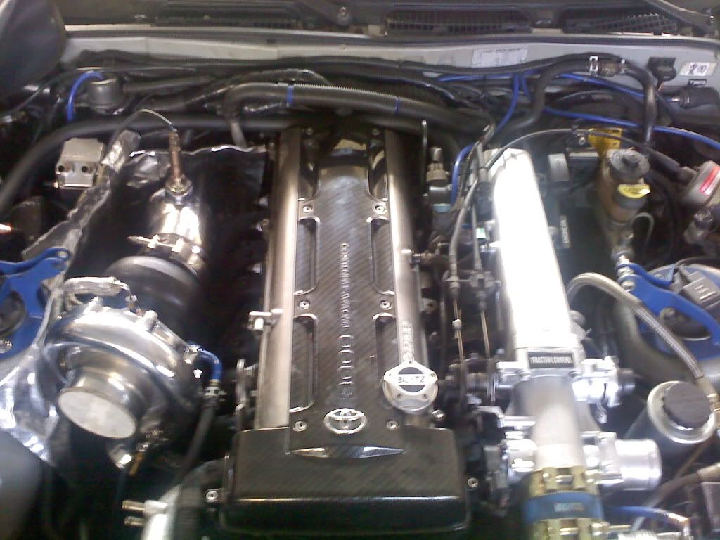

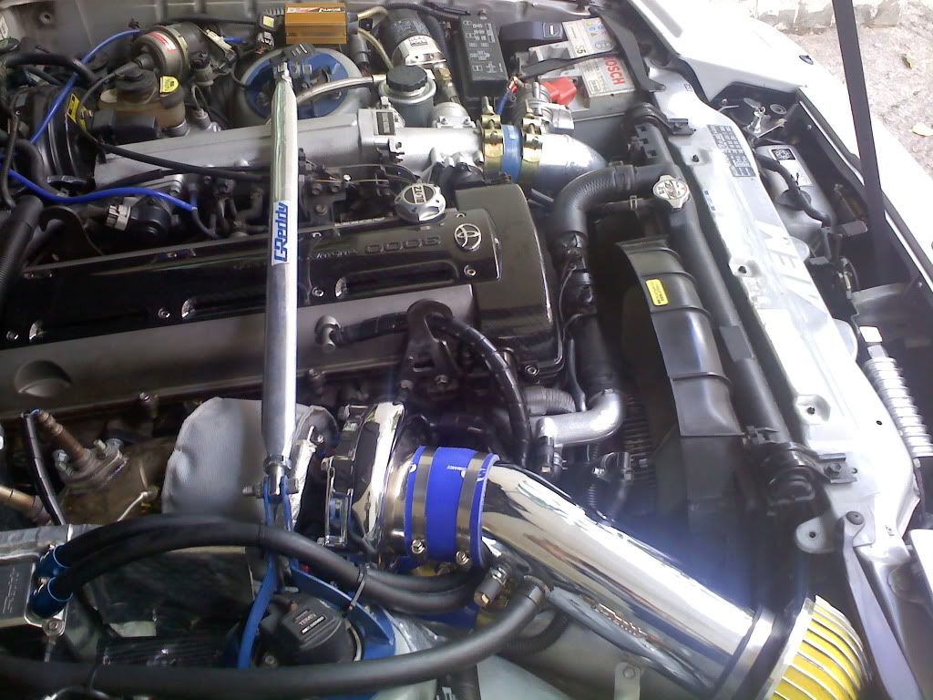

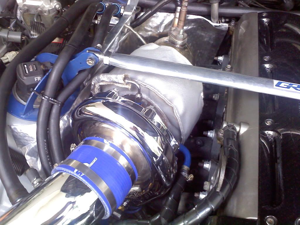

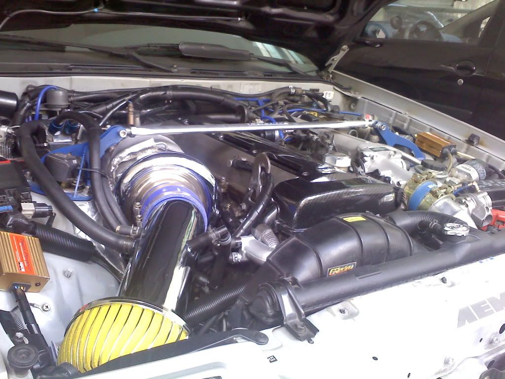

And last the finished 'product'...Completely installed and ready to boost',
not much though (only 7-8 psi) cause I am on stock fuel system :cry:
The only thing left is the Greddy oil catch can to the PCV system to
get the proper hoses and installed them in.
I am waiting for the performance fuel in a week or two.
Soon man..soon! :biglaugh:
Enjoy :sarcasm:
Somewhere I have a small video,when I first cranked the Single setup
without the midpipe being installed! What a noise....sick thing indeed :biglaugh: I'll try to find the video end post it up :sarcasm:
I hope it's good quality.
