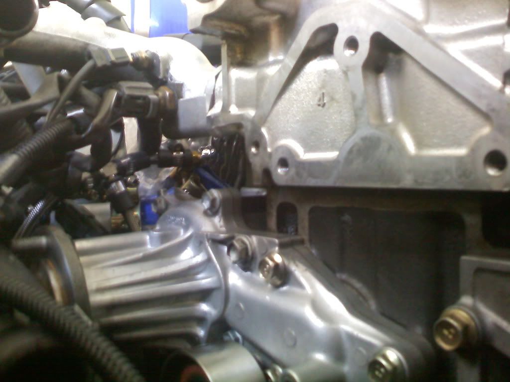

After 2 hours of checking all electronic components,I found out that
I HAD A BLOWN WIRE (B-R colour / +12V Plus from EFI main relay) at the C1 (gray plug) which is located near the fuse box in the engine bay!! :aigo::aigo:
Couldn't believe my eyes guys.Crazy stuff indeed. :naughty:
I think that this happened cause the battery was (for 3 days) 'drying out' due to the 'ON' position on the ignition switch.
And after blew the B-R wire at the conection where I did the hybrid 7M/2JZ wirring for my 2jzgte swap.
Tomorrow I am going to fix it up for GOOD! :biglaugh:
I am going to make sure that every wire over there will be isolated and
covered with (double) wirring loom protector.:biglaugh:
Has anybody experienced anything like that before?
Near the C1 plug,it is located the oil filter due to an oil filter relocation kit.
Maybe the heat from the oil filter could have done this...is it possible?

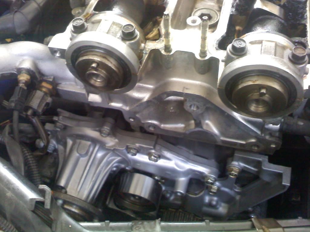

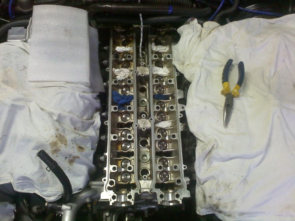

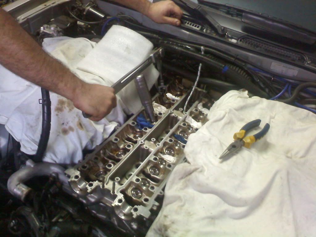

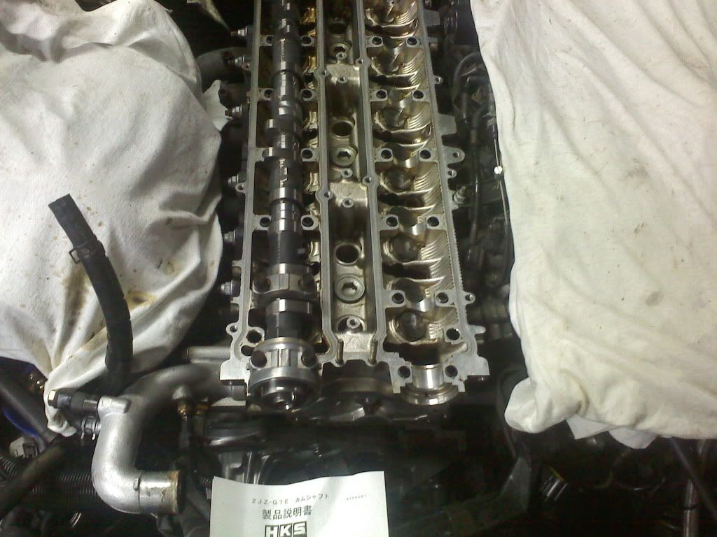

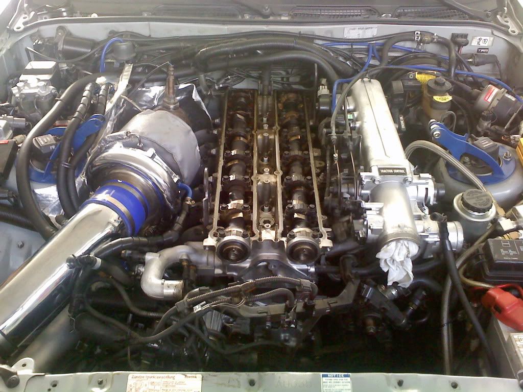

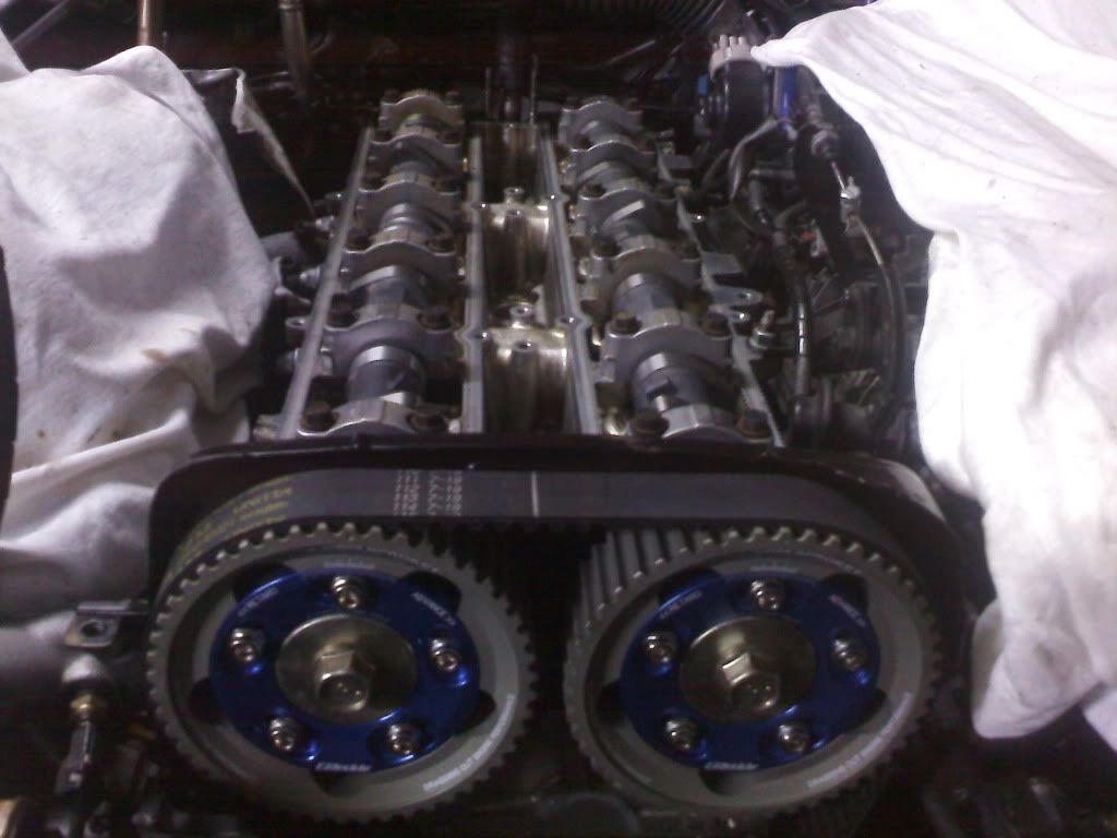

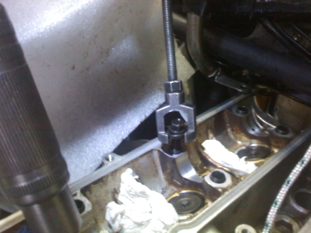

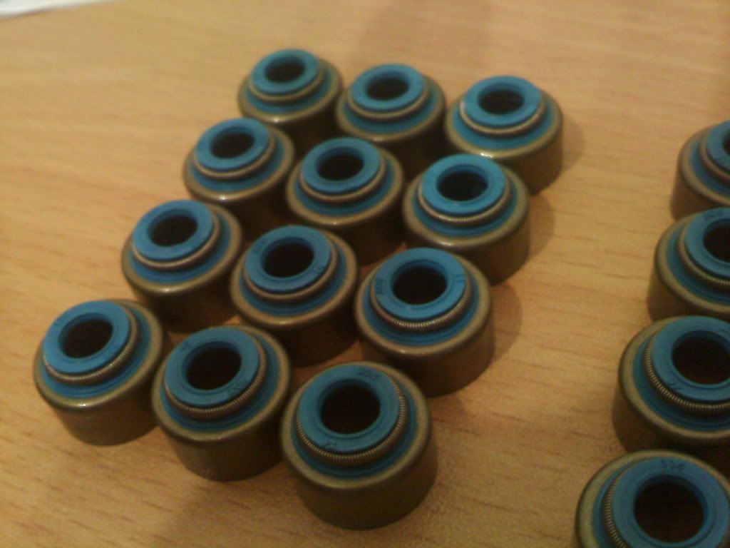

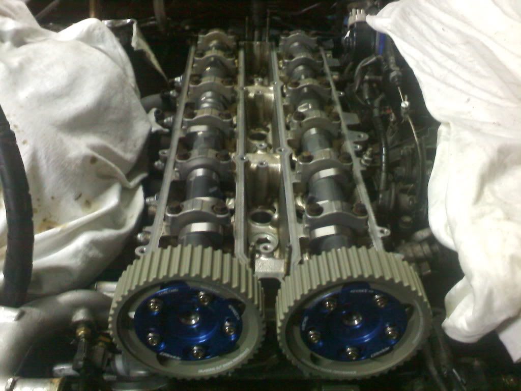

Here are some pictures of the work on the head !
View of the oem cams,gears,seals,etc.,
Cleaned the area near the cylinder head... Like new again :biglaugh:

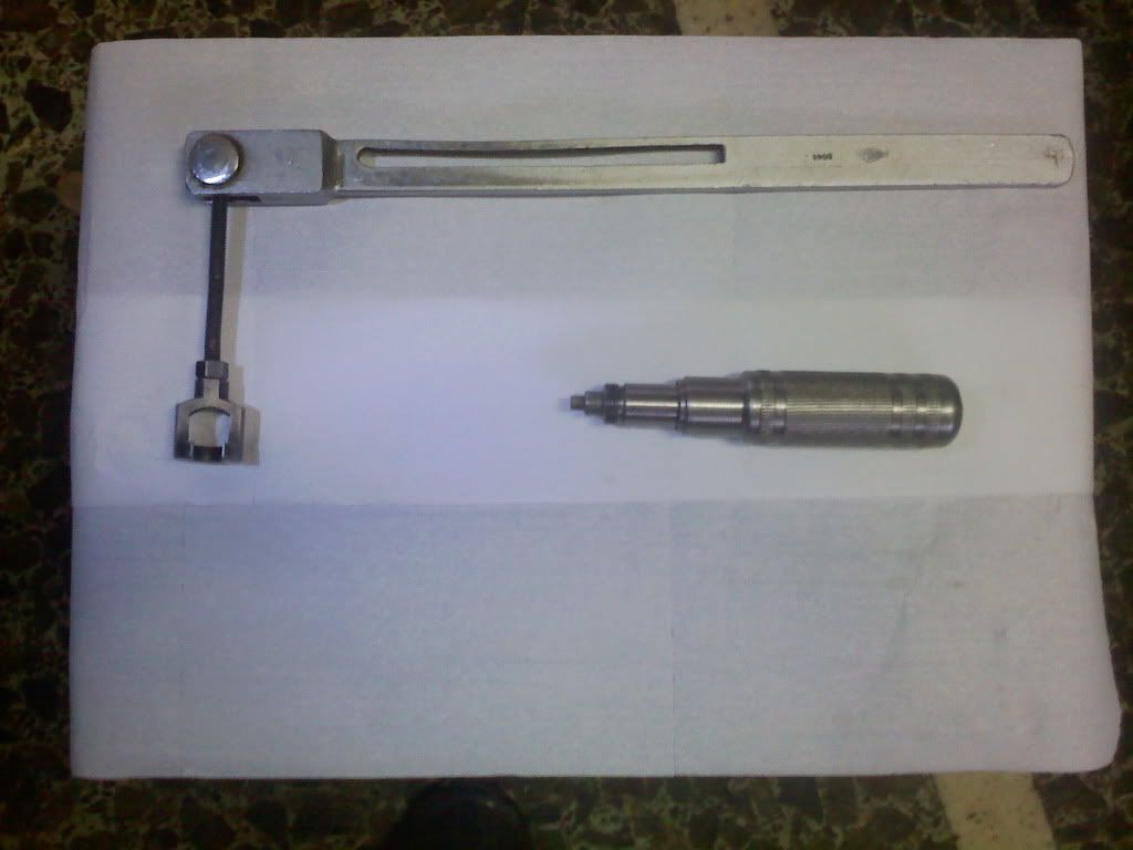

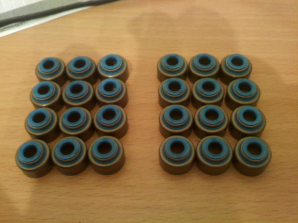

Ferrea valve stem seals to replace stock worn seals
Tool to push the BC springs in...:naughty:
BC Titanium retainers are in the game.... :icon_bigg
HKS 264 Cams
Greddy cam pulleys
With timing belt on
Engine ready...

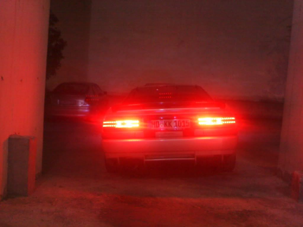

Also a nice mod to the rear lights. I installed some red leds..two stripes of
45cm each. Black colored as my carbon sheet add on (regulus look). They are very bright looking leds! Very coooooool :love:
I will make a video soon,cause pictures can't tell how nice/cool they are!

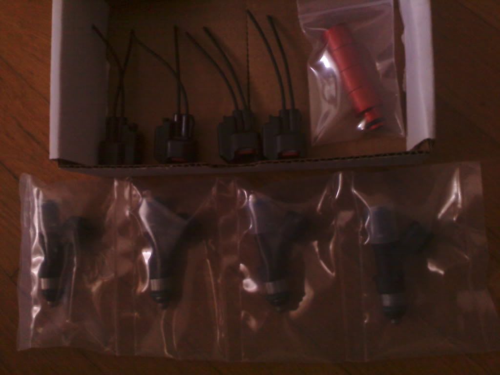

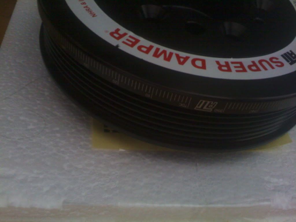

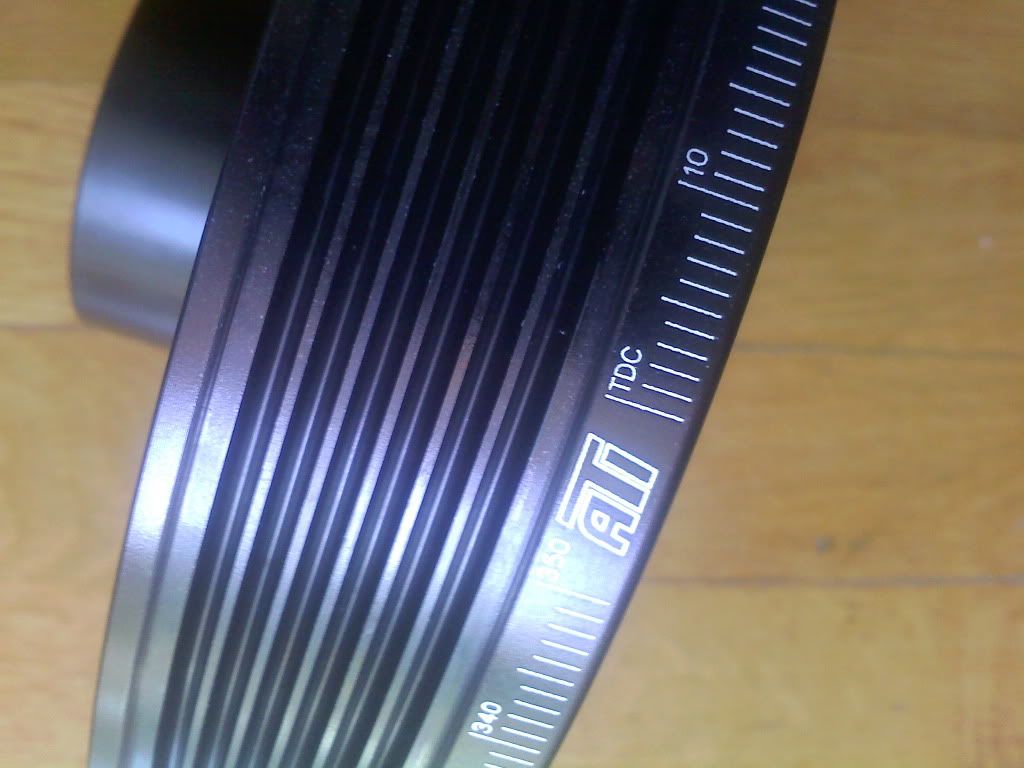

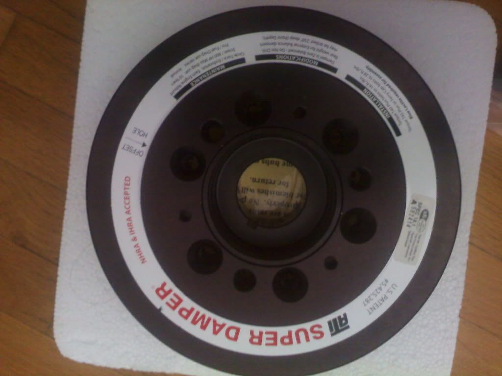

Just got the ATI crank pulley damper
(thanks Jeffery @ Boost Logic)
And the 1000cc Bosch saturated injectors & clips/wiring
(the other two injectors are in a different box,to complete all 6 :icon_bigg)

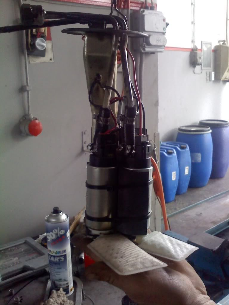

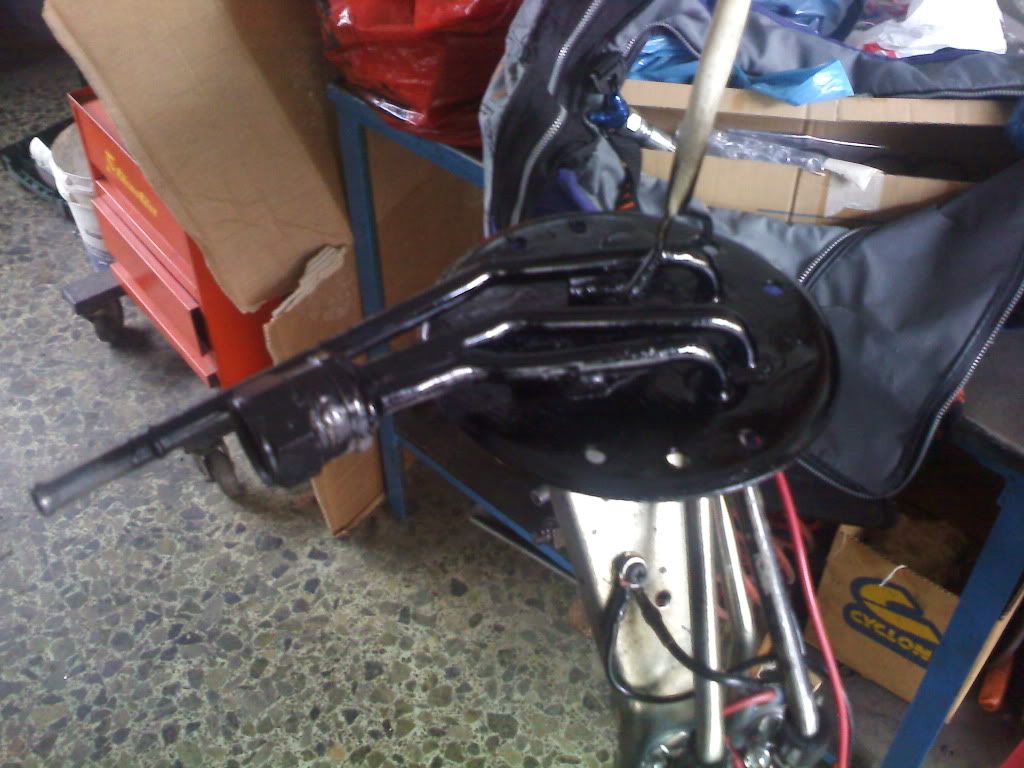

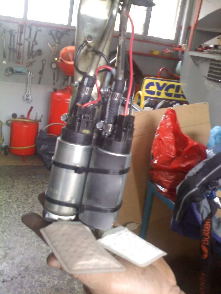

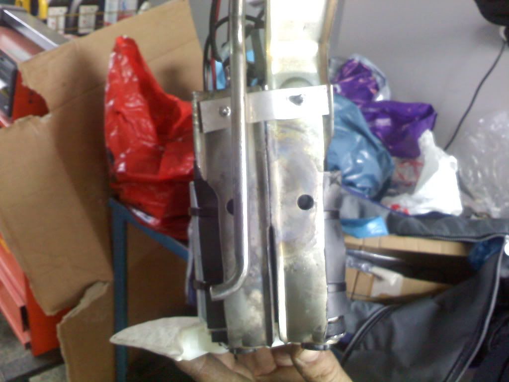

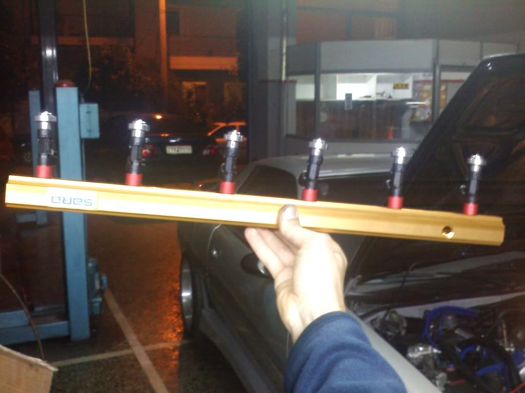

Fuel kit almost ready....
Sard rail with the 1000cc saturated injectors
Custom fuel pump hanger: Dual stock -5 AN lines from the pumps
and out from the hanger to a -8 AN fitting. I am keeping the stock
return line. For the moment I am going with two walbro 255 GSS341
pumps. Just for beggining to see how all parts are working with the single
turbo setup along with the motec M600 ecu . Will be boosting about 13 psi
for the moment,and when everything is ready to boost more than 14 psi I'll
get two high performance 265 ltr/h Sard fuel pumps!
