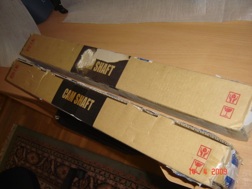

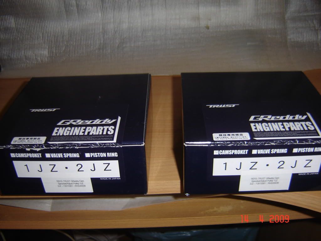

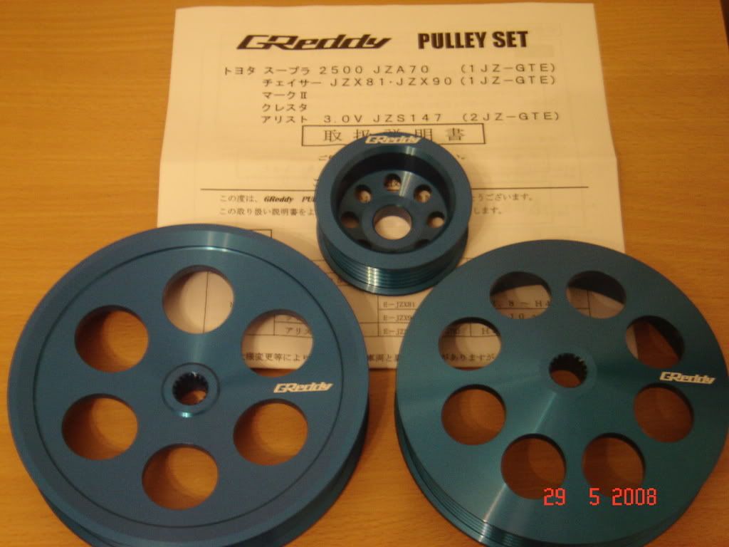

New parts arrived yesterday...:biglaugh:
Ready to give some nice tune up to the 2jz :sarcasm:
Some parts and their pictures...

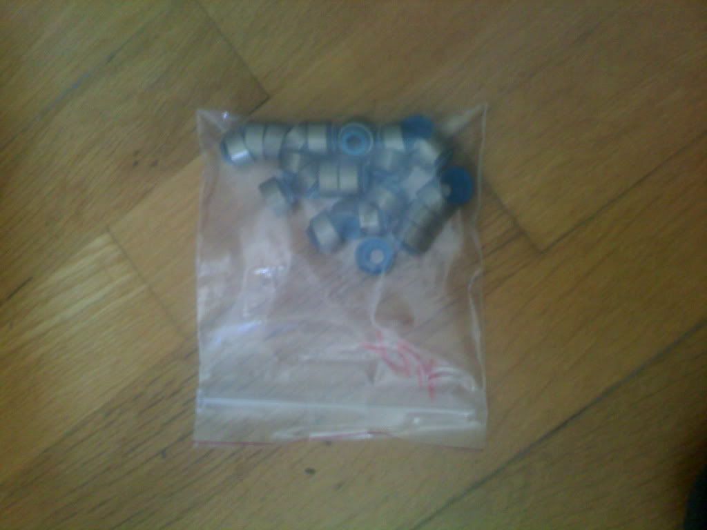

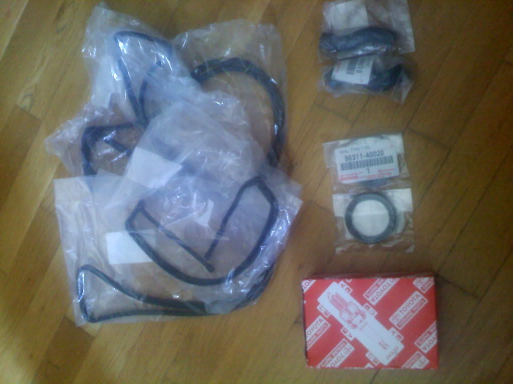

New oem parts (cam seals,cam cover gaskets,PCV hoses,spark plugs,etc.,)
Ferrea valve stems

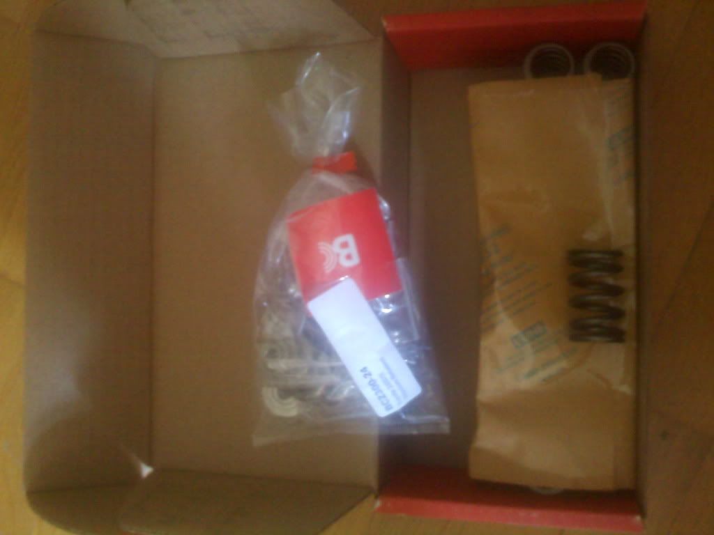

BC performance single springs with titanium retainers
HKS 264 camshafts

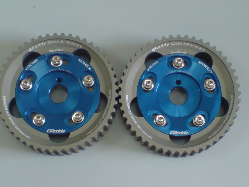

GReddy cam pulleys

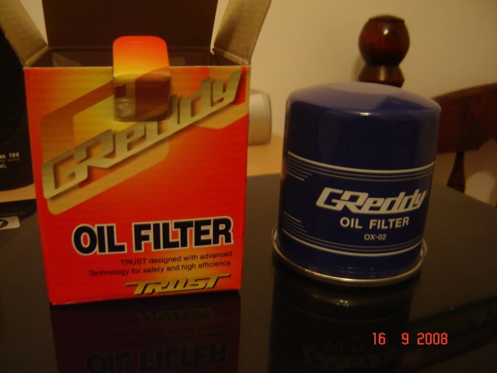

GReddy oil filter

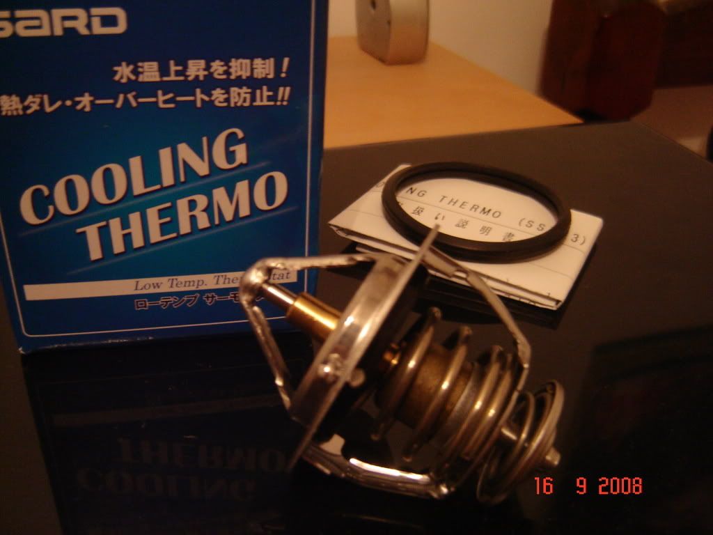

Sard cooling thermostat 68' C
Blitz radiator cap & Sard magnetic drain plug
GReddy lightweight underdrive pulleys

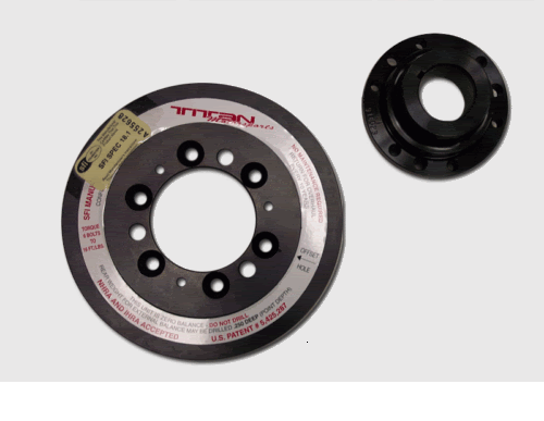

Titan crank pulley (is on the way)

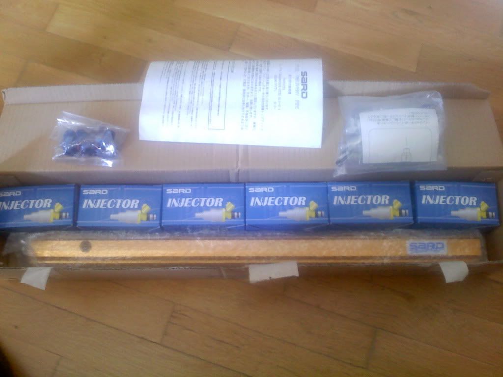

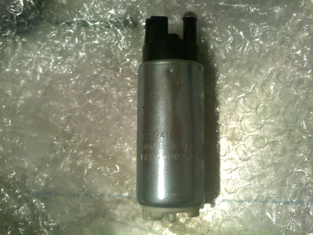

More parts: Just got the fuel kit (almost)
Sard -8AN top feed rail with dual -6AN feed ports and one -6AN return port.
Sard 800cc top feed high impedance injectors

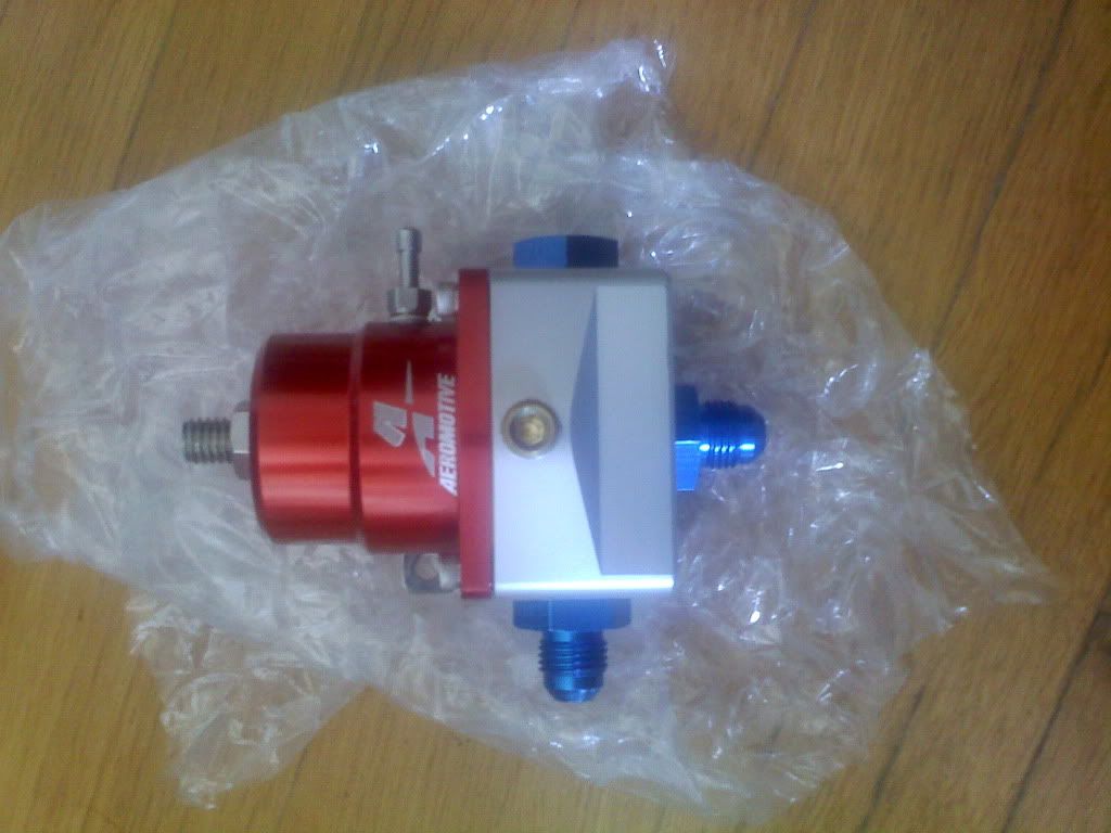

Aeromotive fuel pressure regulator

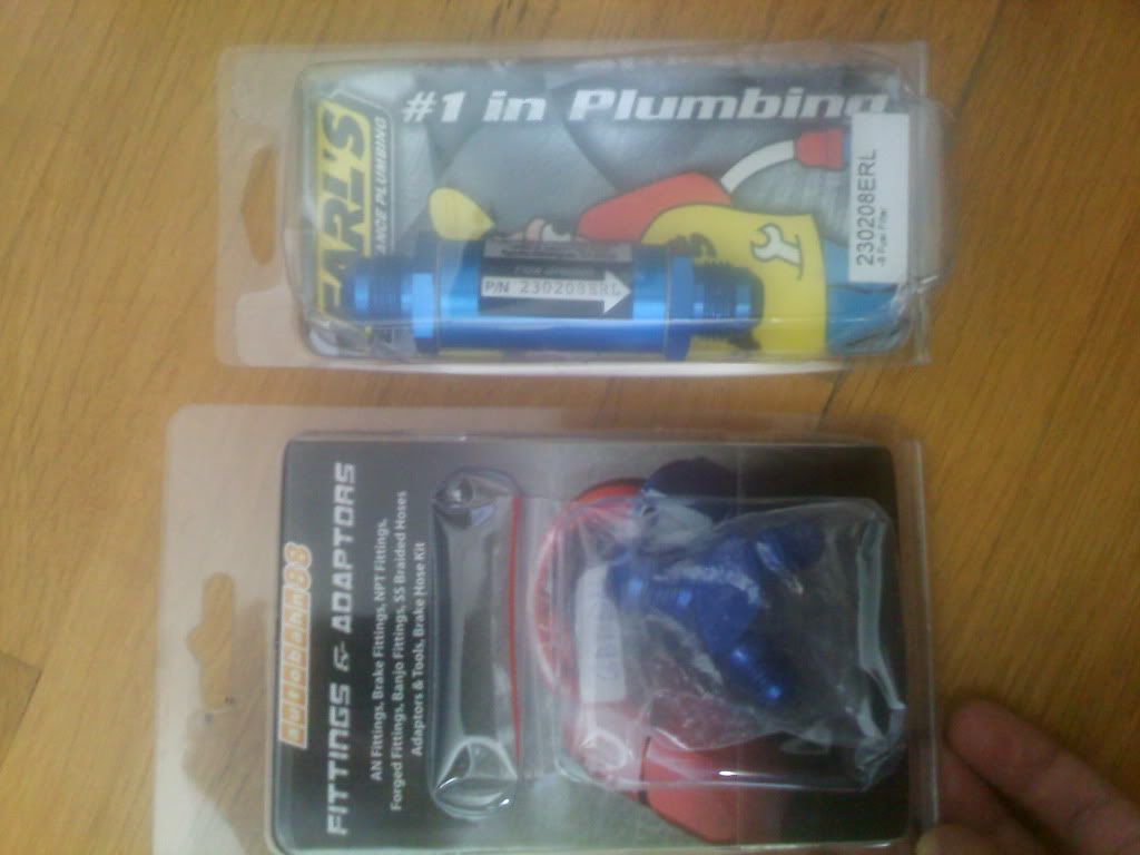

Earls fittings and an inline Earls -8AN fuel filter
o
-8AN feed line and 2 -6AN feed lines from firewall to the dual entry fuel rail
2x Walbro 255 GSS341 HP fuel pump
I am thinking to sell the 800cc and get 1000cc and also to sell the walbros
and get 2x Sard 265 L/H fuel pumps. :icon_bigg

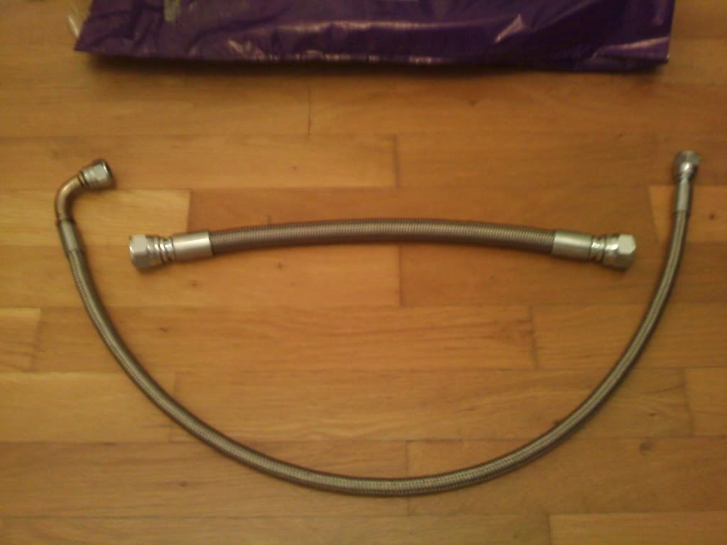

I've just ordered the ss braided teflon fuel lines...:naughty:
And the last part is to customize the stock fuel hanger to fit.
The fuel system will be like that:
Two -6AN from from the pumps to a 'Y' block with a -8AN outlet on the top
of the stock hanger. Then one -8AN line to the inline filter and then another
-8AN feed line to another 'Y' block splitter with two -6AN outlets.And last
these two feed -6AN lines to the dual inlet ports of the Sard fuel rail.
One -6AN return line to the AFPR and another -6AN line to the fuel tank...
I will update soon on the remaining fuel parts...

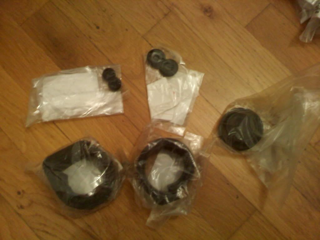

New stuff came today....

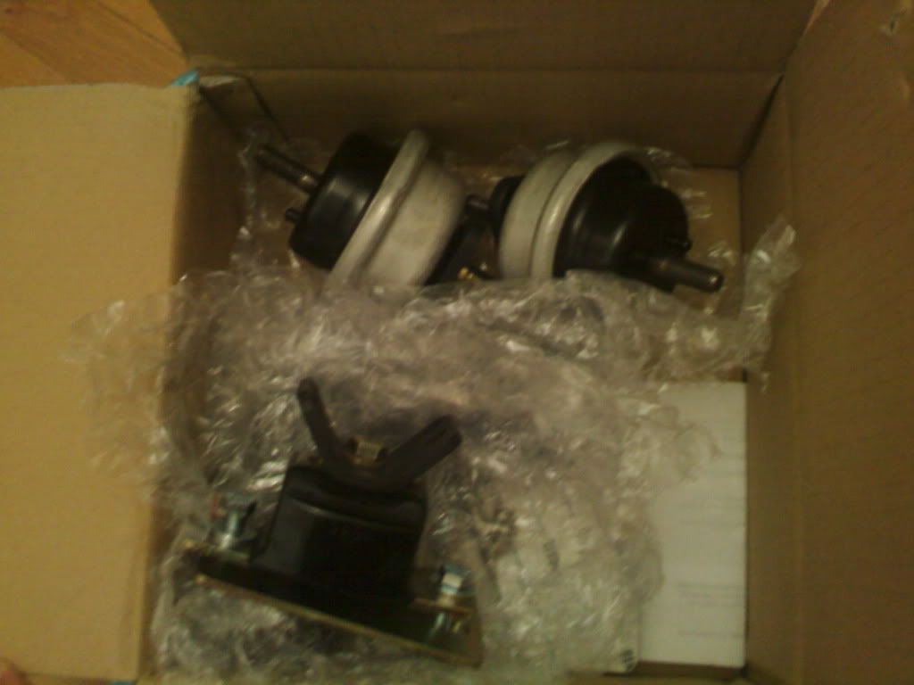

TRD motor mounts and BIC poly trans mount

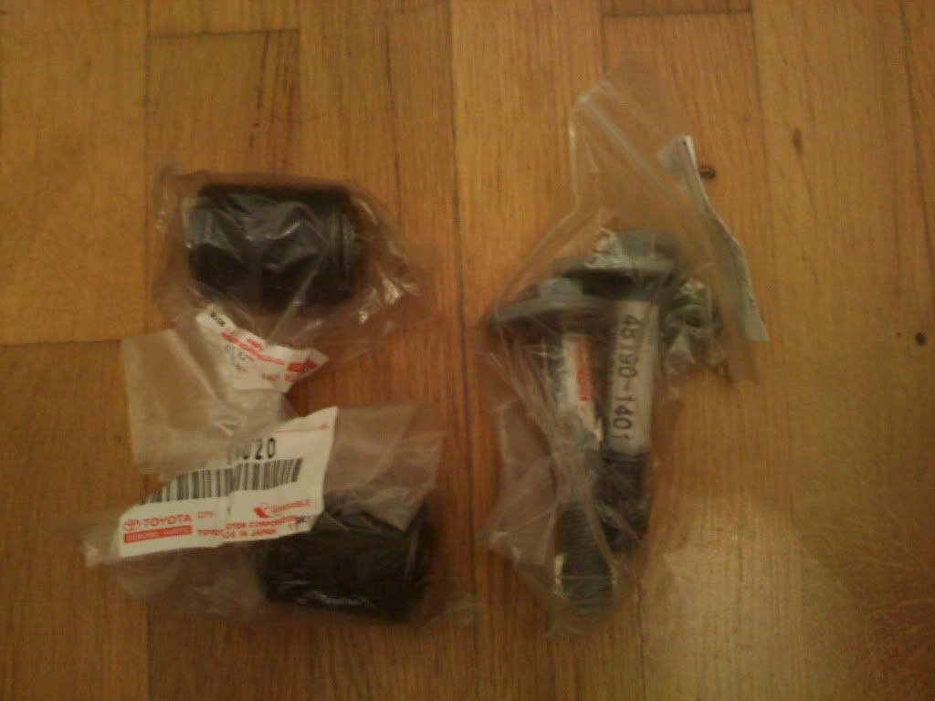

Toyota new oem rear bushings with adjustable camber/caster bolts
Steering rack toyota new insulators and front crossmember gaskets/plugs

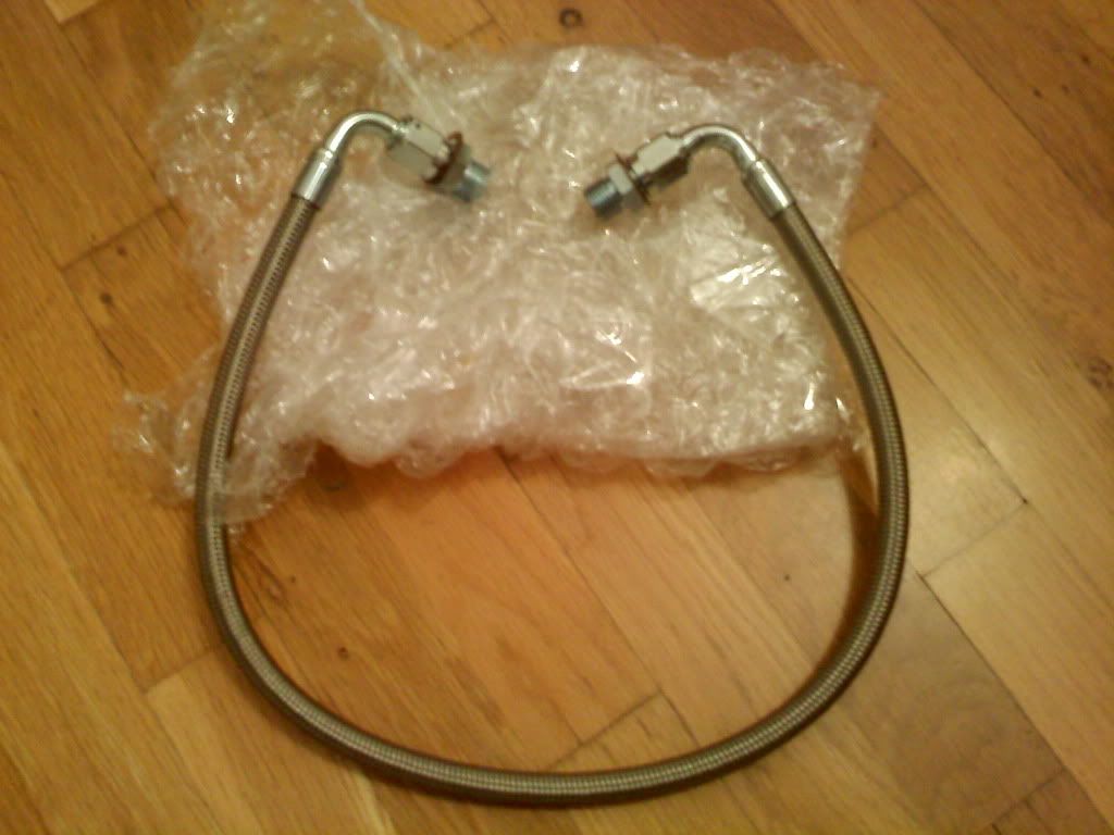

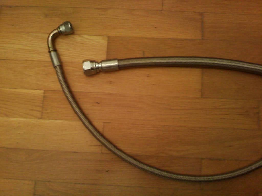

Driftmotion power steering ss braided teflon high pressure hose

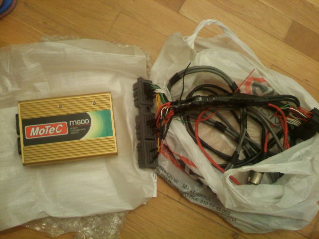

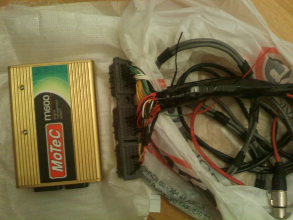

And the engine management standalone system that I desided to use :biglaugh:
MoTeC M600 ecu with custom made wiring loom for 2jz-gte.
It has almost all systems enabled : traction control,launch control,2 step,anti lag,
data log,pit lane limits (track/circuit),and switch for A to B map/boost up control...
I just need to get the 3 bar MAP sensor and the Intake Air Temperature sensor,
and the wiring loom for connection to a PC for tuning! :naughty:
