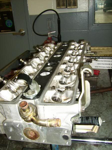

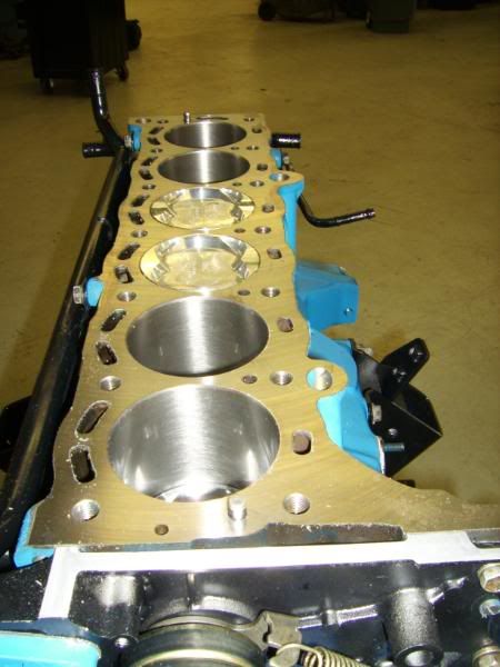

MORE PROGRESS! :evil2:

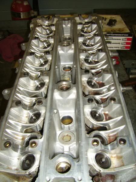

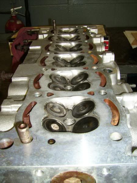

finished putting in all the valves!
put some little thing back on the head...

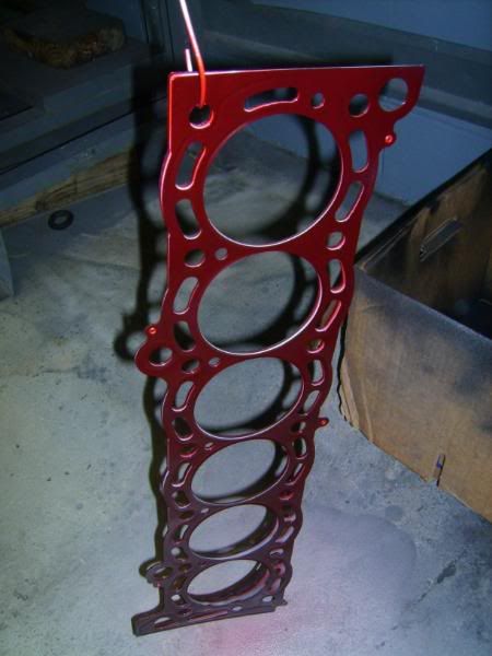

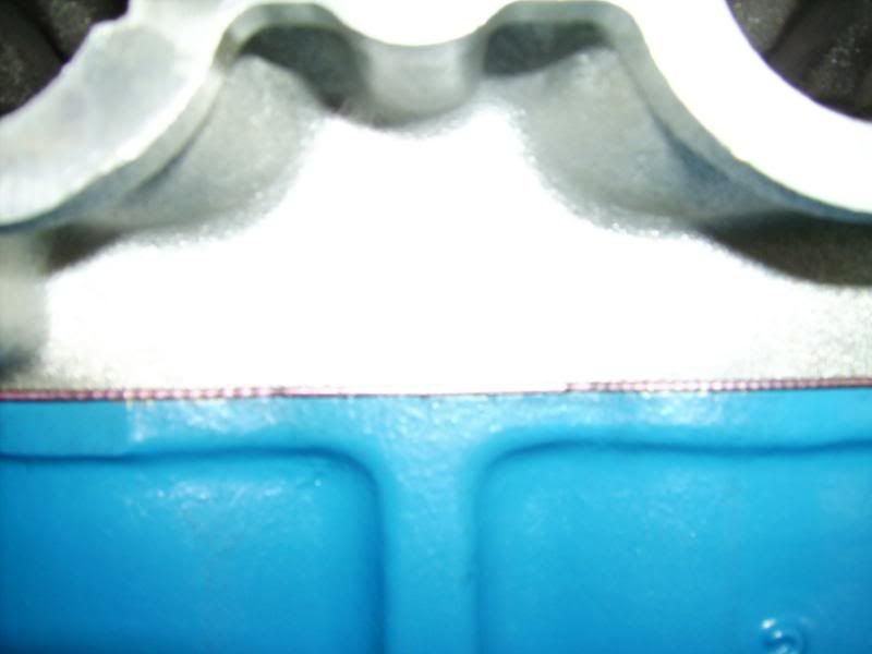

cleaned the block and head gasket surfaces. don't worry...i blew off all the fuzzies :biglaugh:

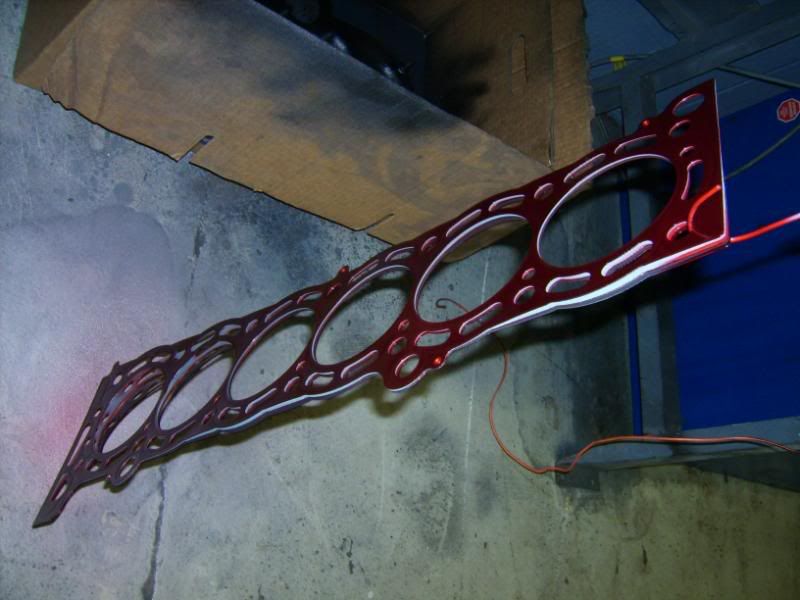

cleaned the hell out of the head gasket and sprayed it with permatex gasket spray and let it hang for about 10 minutes or so...

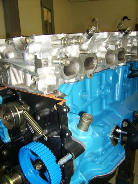

got my buddy and we aligned the head up perfect and placed the head on the block. i left NO fingerprints. i was very, very careful!

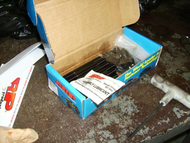

dropped the head studs in and wiggled the washers in...AFTER ARP lubing of course :icon_bigg
and torqued that bitch to 150ft/lbs!
haha JK! i torqued them to 85. i did 50 in sequence, then 60, then 70, then 80, and then finally to 85ft/lbs

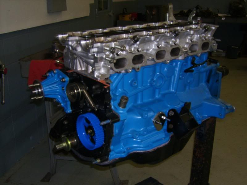

so now my motor looks like THIS! :love:
well done t3d. well done :biglaugh:

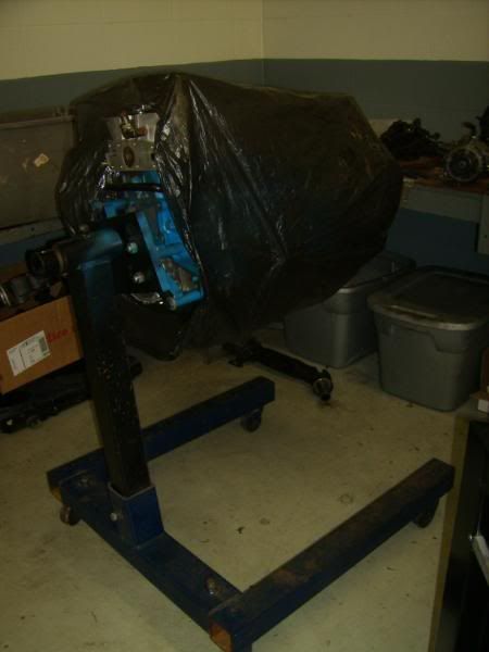

and alone she stands 'til monday :cry:

oh god......
PLEASE PLEASE PLEASE....tell me that wasnt a BRAND NEW MHG?
youre NOT SUPPOSED TO SPRAY THAT GOD DAMN PERMATEX OR ANYTHING ELSE ON A BRAND NEW MHG... it has its own coating to seal with for first use....
:nono:
Also did you happen to remember to put FIPG on the two spots on the front timing cover that you are supposed to? People tend to forget that.

there was nothing on the gasket and i cleaned the hell out of it first and YES i did remember to put the sealant shit on the the spots of the cover. it's fine:icon_bigg
wasnt it a brand new mhg? what color was it? in fact didnt i sell/give (whatever i dont remember lol) you that mhg or is it another one?
haha no i ended selling that one. it was the Greddy mhg. so, there was nothing on it.

If you are using a brand new mhg it comes with a sealant coating on it already. You are not supposed to apply anything to it.
Hmmmm im pretty sure the Greddys have the coating also... was it black or silver in color? hopefully youll be ok...but ive found that applying that permatex crap to new mhgs causes nothing but problems.

it was silver. but why would it cause problems? it's just like a safety layer?:dunno:
kotu100: don't worry man. i've taken ALOT of picture, and i have ALOT more to come as i finish putting the motor together :biglaugh:
-t3d
If it was silver you should ok. And it causes problems when theres too much of that permatex crap on it and it likes to clog coolant passages.
You should be ok though.
