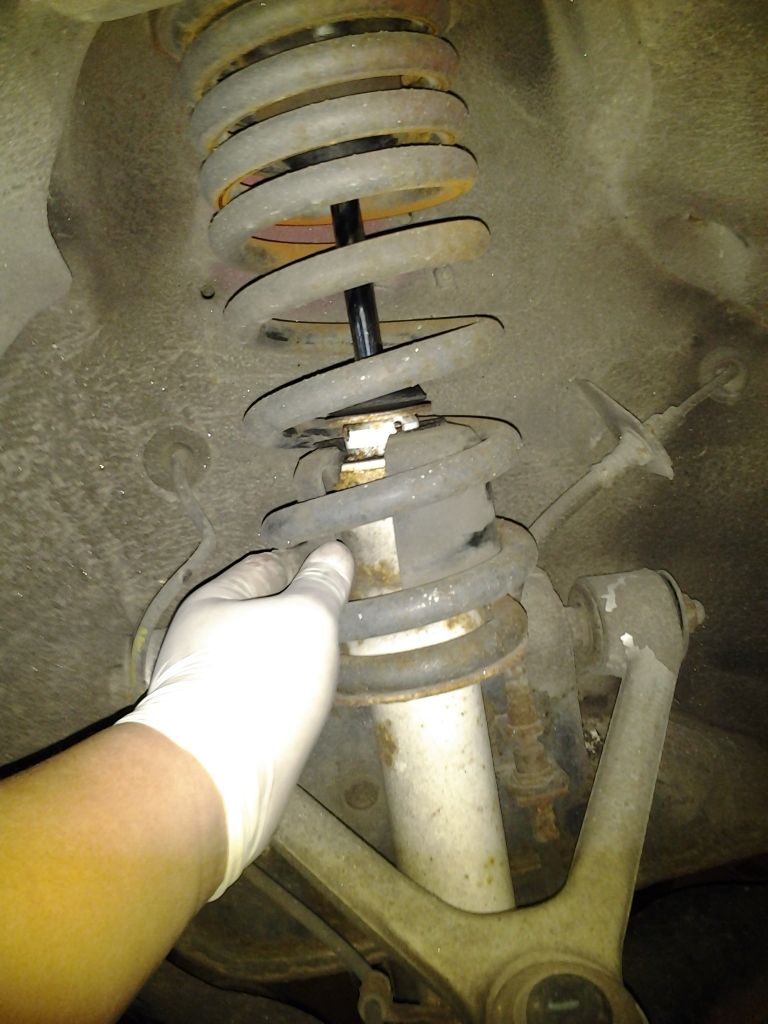

I was wondering if I need this part right there in the middle. Its the black thing inside of the spring. Its spilt in and and the other side doesnt have it. If i dont need it, im gonna take it out. The picture is of the front driver side. Its the part that im touching.

Its a dust cover. Not totally necessary. Its supposed to be attached to the bump stops tho. So having it at the bottom is pretty useless.
