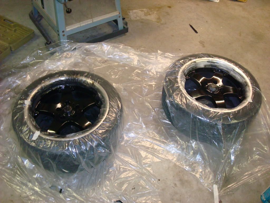

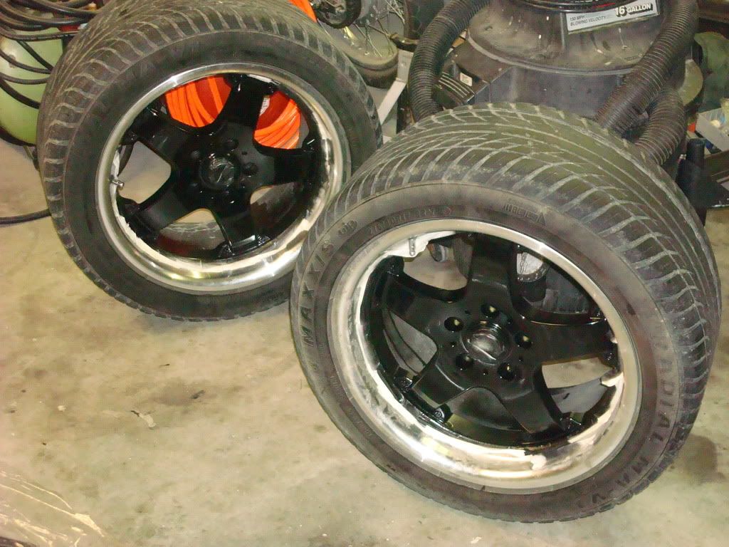

Painted my rims tonight, they look sweet! I also tinted the windows the other day. Cost me 40 bucks for the tint, got 20% on the front two and limo on the back.

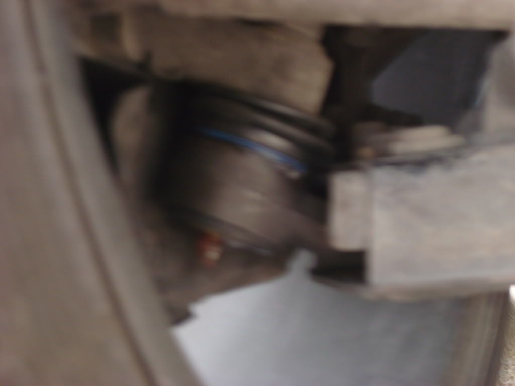

I got my ball joints in and got them put on today. Got the pair off ebay for $50, compaired to $90 from autozone just for one. Looks as if the previous owner had replaced them at one point. The drivers side shock bolt was in backwards, and the lock pin looked more like a nail. The grease fitting had fallen off one, and neither had any sort of grease left in them. will post pics in the morning. Peace!

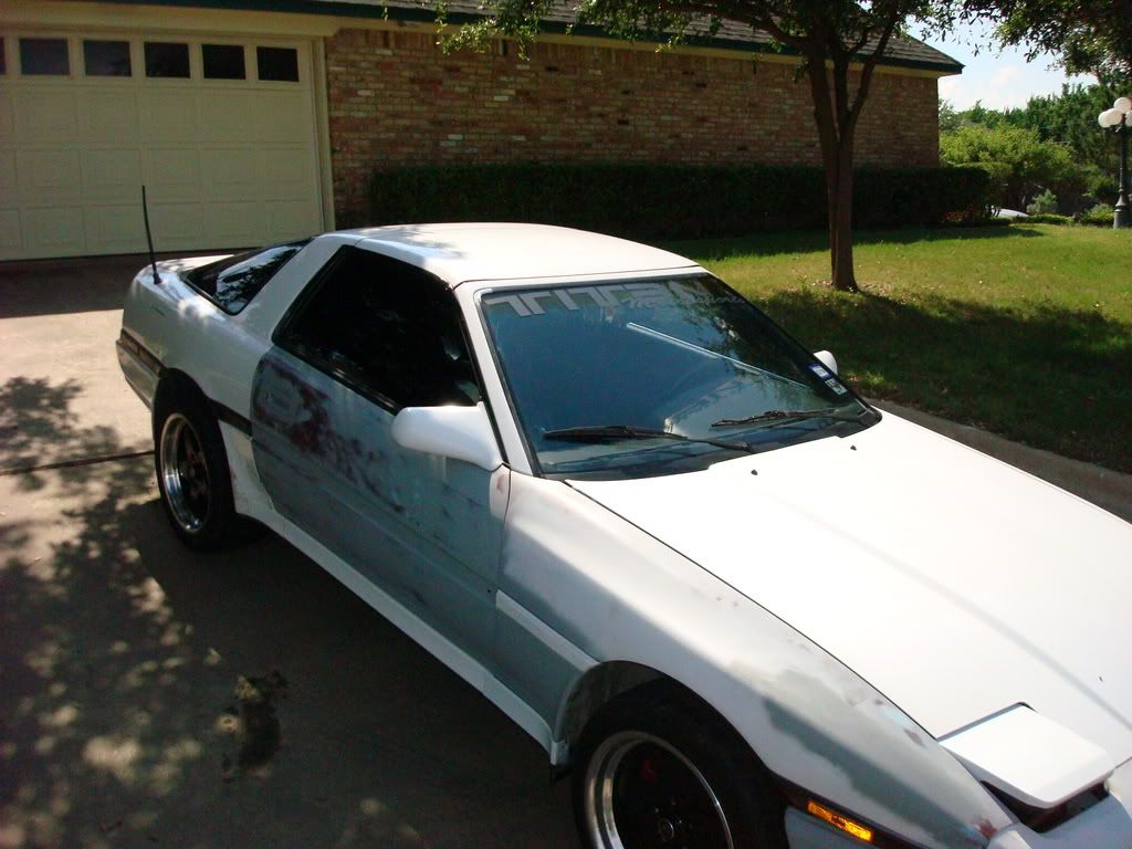

Picked up my mirror, light and trim from paint today. Its a little bit brighter than the other white but i can live with it for now.

This is really coming along! I'm impressed with how much you've done.. I wish I had the patience and ability to do this sort of work.

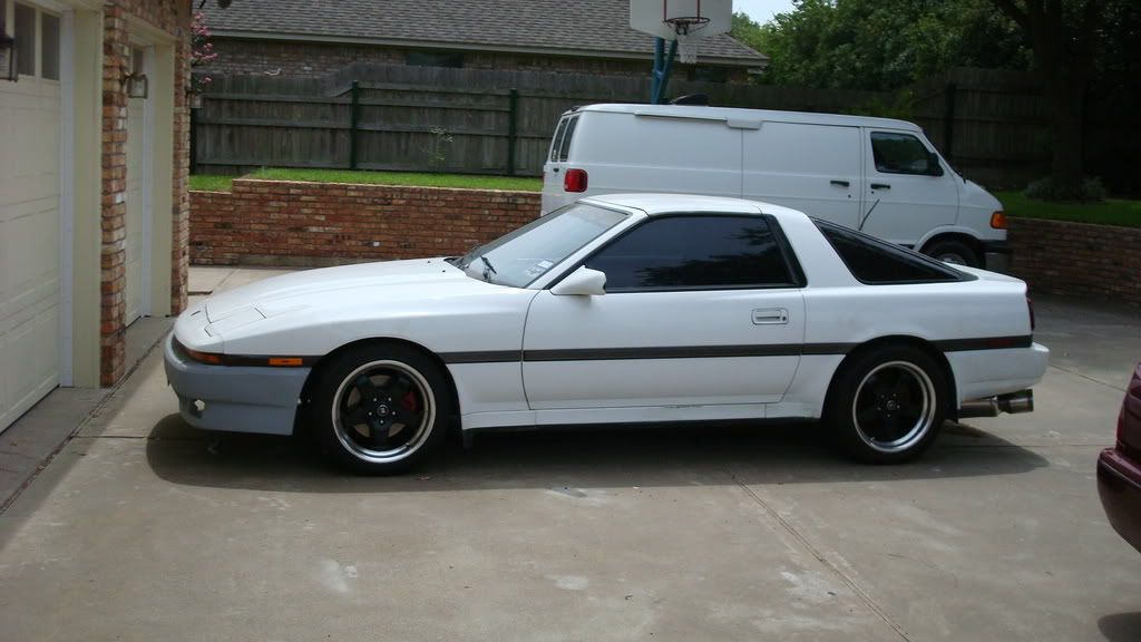

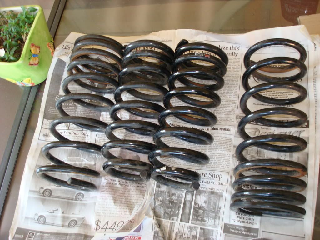

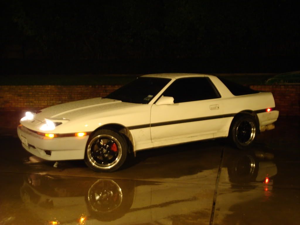

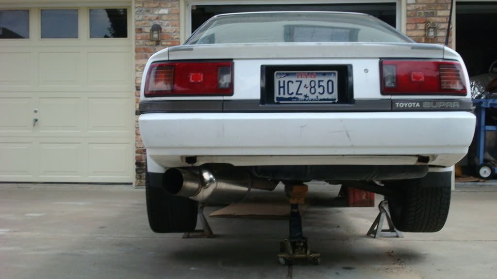

I know it has been a while, but i got back on the project today. I installed a set of rs-r springs. Im very suprised at how nice the car looks now:naughty:

WAY better stance! looks pretty nice now, its certanly coming along. Dont let the Turbo guys peer pressure you into anything. There is nothing wrong with an NA mk3 so long as you dont treat it like a race car.

Took the sup down to the tire shop yesterday to get a front and rear alignment and found out that the passenger side tierod was bad. I ordered both inner and outer tierods for both sides on ebay, got all four for about 50 bucks. I also decided to go ahead and replace the clutch while i have the car on stands. Got the F1 racing clutch also off ebay for $180. Parts should be here sometime this week.
Did a little editing with the picture of the new stance.

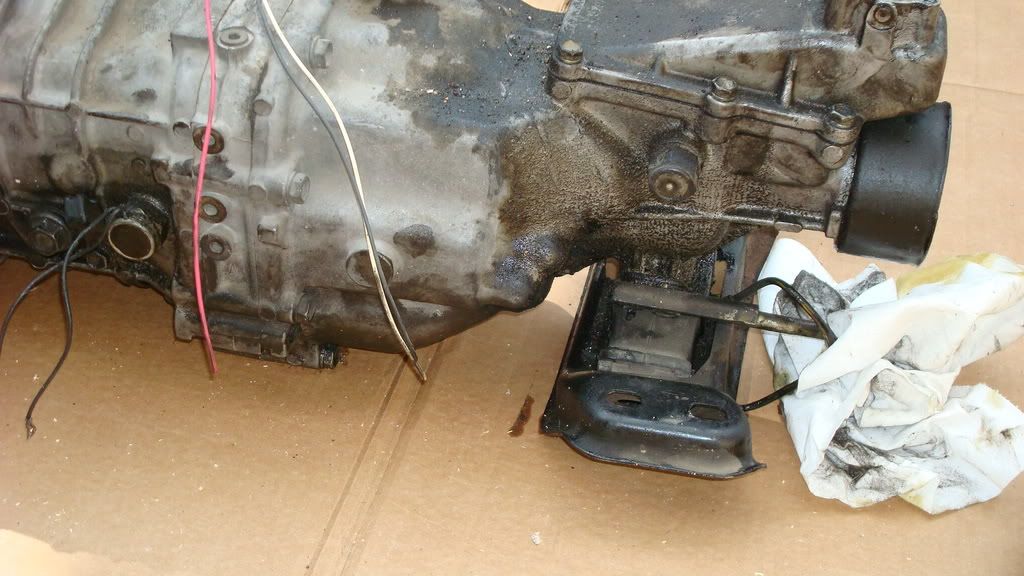

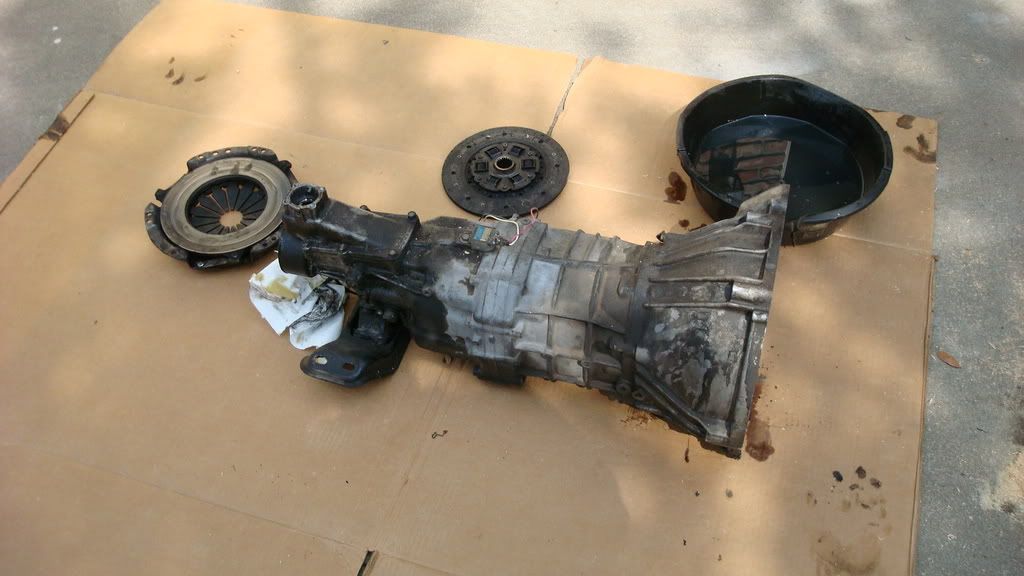

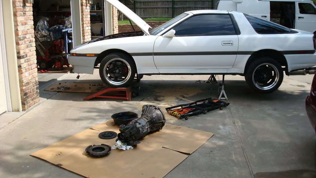

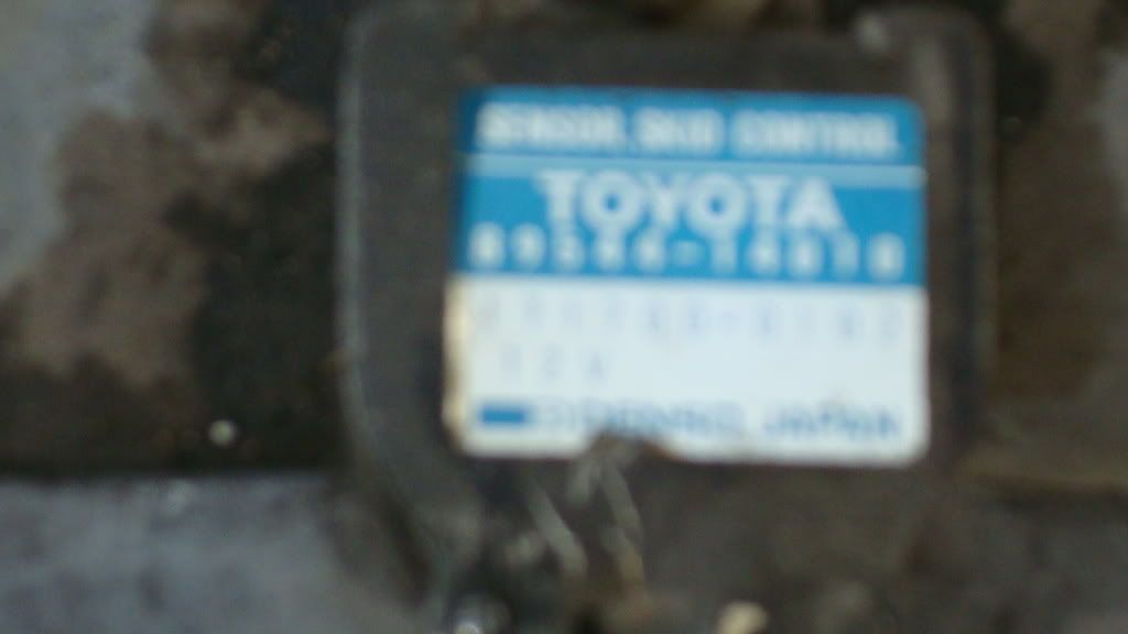

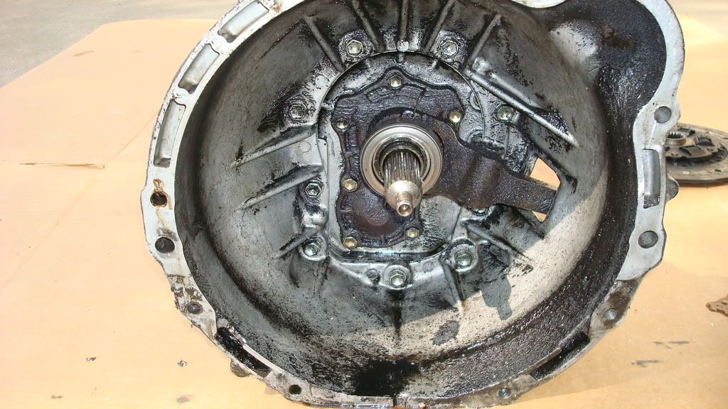

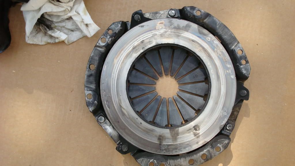

Got the tranny pulled out finaly. The top two bolts on the left side are ridiculously hard to get to! Oh, note: Drain transmission oil first before removing transmission! I found out the hard way that the oil will just poor out the back once the driveshaft is pulled:3d_frown:.
Can anyone tell me what seals i should replace? It looks like oil was leaking from the rear shaft, also found some oil inside the bell housing.

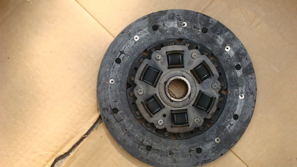

Clutch disk, whats left of it.
Traction sensor??????

I always replace the engine rear main seal every time i remove a transmission, even if it isnt leaking. Check what kind of fluid that is in there and decide if you need to replace the input shaft seal of the transmission. I would replace the output seal as well just to be safe, who wants to pull out a whole drive shaft for one seal.
BTW i think the turbo transmission uses a pull type pressure plate, so it looks like you have an N/A transmission, correct me if im wrong.
P.S. I can smell a bhg with that universal upper hose that close to those cam gears!
