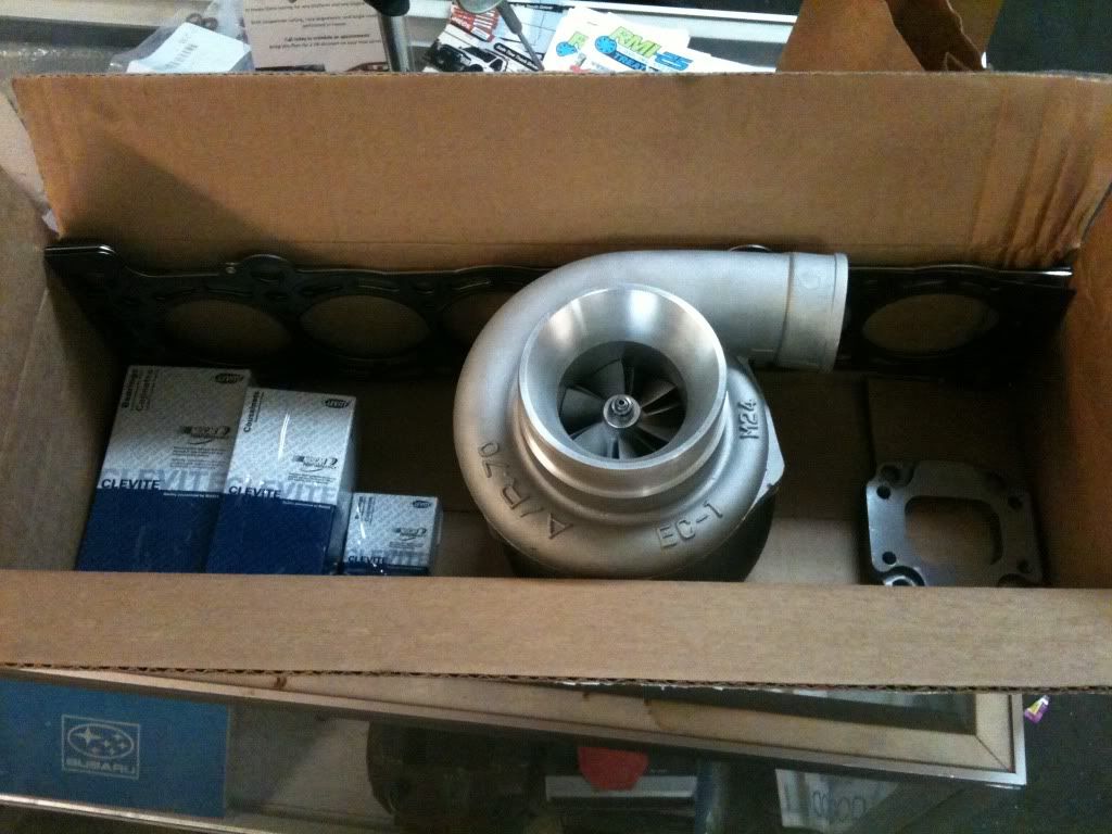

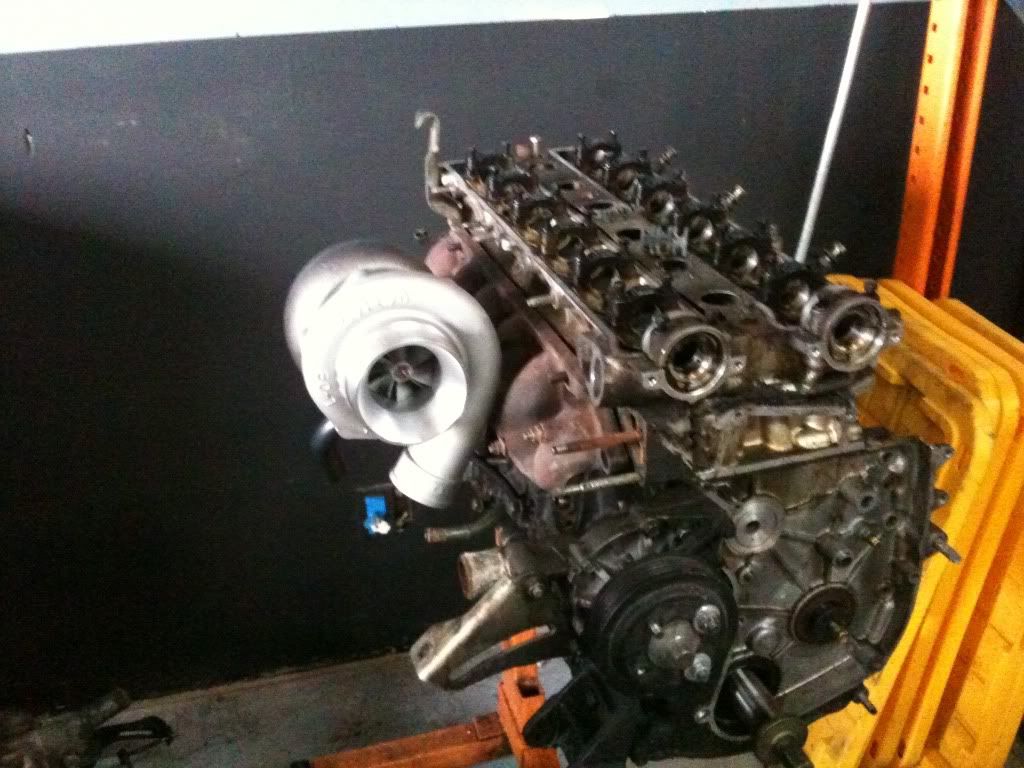

So here is the current list of specs
7MGE Block .20 over and Surface decked
7MGE Head, stock valves, surface decked, all valves lapped and checked for leakage. DDS Performance valve springs, seats and retainers. DDS Performance mild bowl job. Stock GE cams's, Adjustable cam gears
JE's 9.0:1 FSR Forged pistons 83.5mm .20 over, Slip fit wrist pins
Eagle H Beam Rods (ARP bolts) (Slip fit wrist pins)
Cometic 1.3mm Head gasket
Stock 6M crank (STD size Main and Rod)
Clevite 77 (NDC) STD Main, rod and thrust bearings
OEM Toyota Oil pump (shimmed 5mm)
OEM Toyota timing belt and pulley
RC Engineering 1200CC Injectors
GT35R .82 T3 Exhaust housing
Stock ECU W Greddy Emanage Blue and Lexus AFM
Stock Exhaust manifold with 38mm External wastegate, Open Dump
CNC CT26-T3 Adaptor
Stock Intake manifold
DDS Performance Custom Mandrel bent turbo back exhaust
DDS Performance Custom Mandrel bent and tig welded aluminum intercooler piping
Tial Q 50mm BOV
Stock A340E Auto trans (Custom shift kitted Valve body)
3000rpm re worked stall
Engine will be blueprinted internally with a micrometer and bore gauge. (I was taught to never use plastigauge unless I really have to) Cams will be degree'd with a degree wheel and dial indicator.
Will update as I go! List is looking nice
