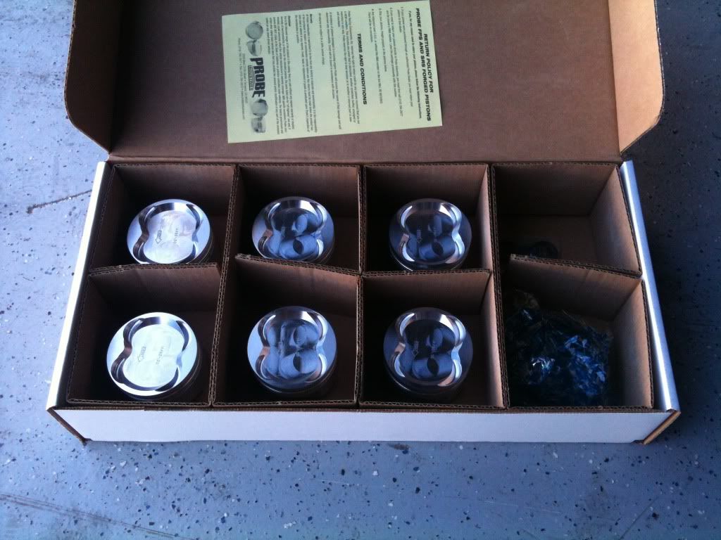

So the plans now are to build a setup that will get me into the 10's I have gone through a lot of options and decided to go with a mild bottom end, forged pistons and stock rods. Fully blue printed engine and built to race specs. Since I was NA-T I was high compression, being there are no off the shelf available NA forged pistons I am going with probe GTE pistons which have a compression ratio of 8.4:1. I will be removing as much material off the head and block as possible to raise the compression along with the thinest head gasket available.

Anyways thats it for now. The pistons and gasket set are already ordered so I can get started on the machine work of the block and start assembling it. Should be ordering the turbo end of this week and planning on having it running by the middle of the month. December 4th is Import face off and I will be there dialing it in! Can't wait, its coming up quick!
