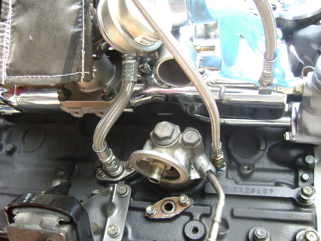

I took a picture of the oil feed and return so you can see it. This is the only thing close to difficult, and it is easier than the CT26. Although the turbo is bigger and flows more, the total mass is less, and you can actually see and start nuts on the studs somewhat easily.

IJ.;1581036 said:
That dip in the drain hose may be problematic Nick.....
Welcome to the GOM ;)
Eh. The return was not bolted in. The nuts were just started, it straightened out more when clamped down. Thanks for noticing. :stickpoke

Nick. So there was no problem with the oil drain hose? When I tightened mine, the kink actually got worst.
I remember my friend had a kinked hose on his oil return for his 240Sx and it destroyed the turbo.
I got a new line that's 1 inch shorter.
Here's how it looks now.

I attached the line to the turbo first. When I tightened it, that pulled the flange closer to the block, and further away. It and the water line could be a little shorter. But I don't think either is an issue.

Mine did the opposite. I tighten the 4 bolt that bolt the turbo to the manifold last, which made the line bend even more. Well as long as it's not kink, that's all that matters.
Yea. All the line were a little too long on mine also. The other lines have swivels so it doesn't matter.
