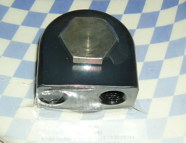

I took a picture of the elbow, if for some reason nobody has seen it. Nice piece. And my intercooler hose problem defeater, aka Canton adapter in 18 x 1.5.
I still have to get A/N adapters for the NPT, and a smooth bend in some places.
I will do the intercooler and turbo at the same time as fixing the oil cooler imperfections. Next year or so.

I wanted to give a thumbs up to SupraSport/LIPP. Not just for the Boss Jr and their dedication to our hobby, but the CT26 install kit. The lines are suuuweeeet. The OEM hard oil line for the feed and return is just a pain. The install kit is all that and a bag of chips.
I am also putting on my Canton Adapter in place of the Permacool unit. The Permacool interferes with the intercooler hose, as some of you have already found out. I will take a picture of the Canton installed if you haven't seen IJ's or somebody elses. It goes down, and saves space bigtime. That and it isn't a brittle aluminum alloy. For as brittle as the Permacool piece is, it isn't even strong.
