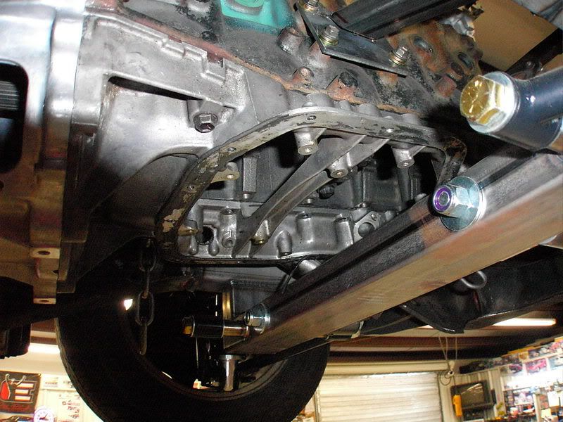

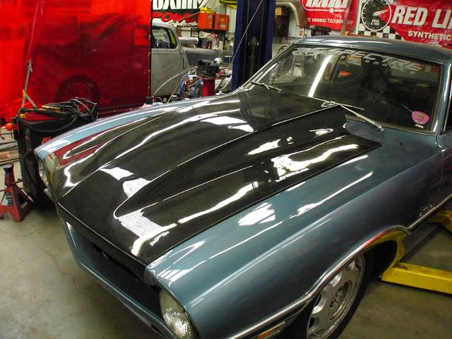

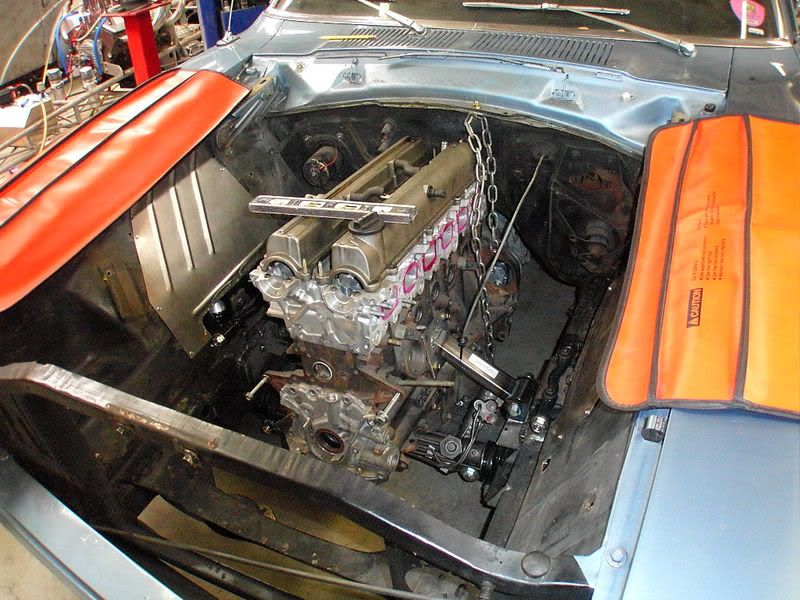

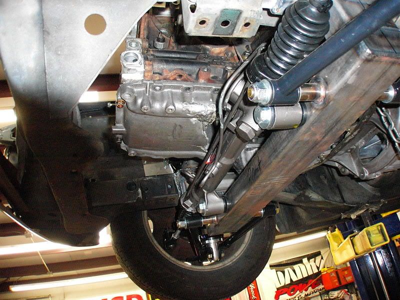

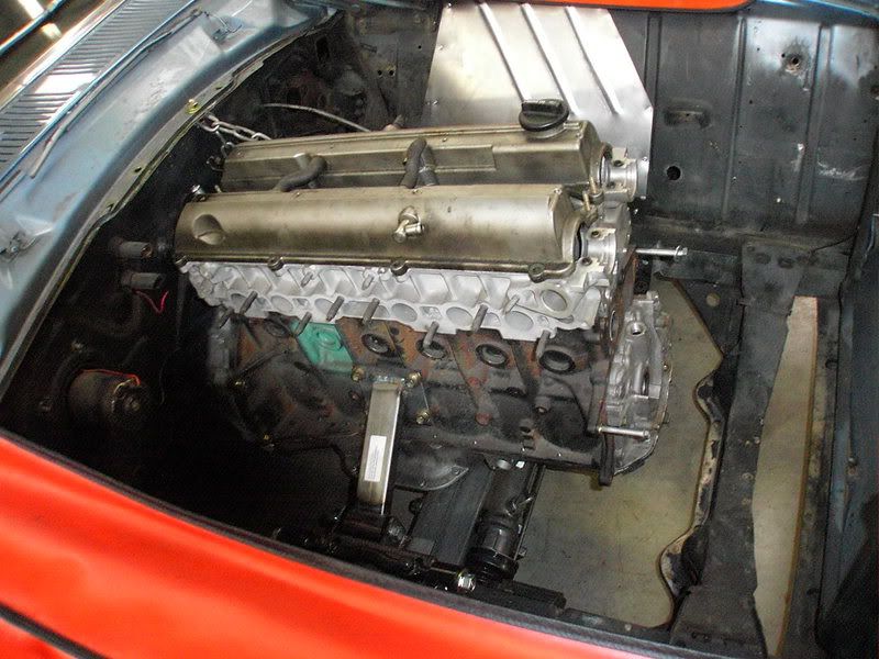

More pics from the weekend. A sump pan will need to be fabricated, but that's not too big of an issue. I don't think that a top mount IC will work without butchering this awesome hood that they shipped us. A smaller front mount will work in the grill area above the bumper though.

hell yea...love the fact that ur getting this done. hehe theres a lot of room in that engine bay...
In that case you could have raised the engine up since the hood isn't going to hit anything...
Then no hacking of the oil pan, but the angling of the driveshaft, and the tranny tunnel might have been an issue...
I see plenty of room to mount an IC between the radiator support and the grill. Now the only question is: Do you leave the IC glaring out of the grill, or do you black it out and let people think it's slow?
Damn that hood is cool though, CF is tuner car style, while the cowl induction style is pure hotrod...

Poodles - we couldn't raise it any higher without butchering the trans tunnel.
tlo86 - Boost Logic loaned me a pan setup to do mock up. Look at the hole in the front of that sucker.:biglaugh:
I just got a PM on one though, so all is well.
