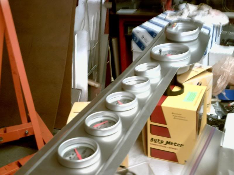

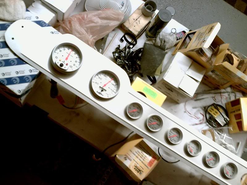

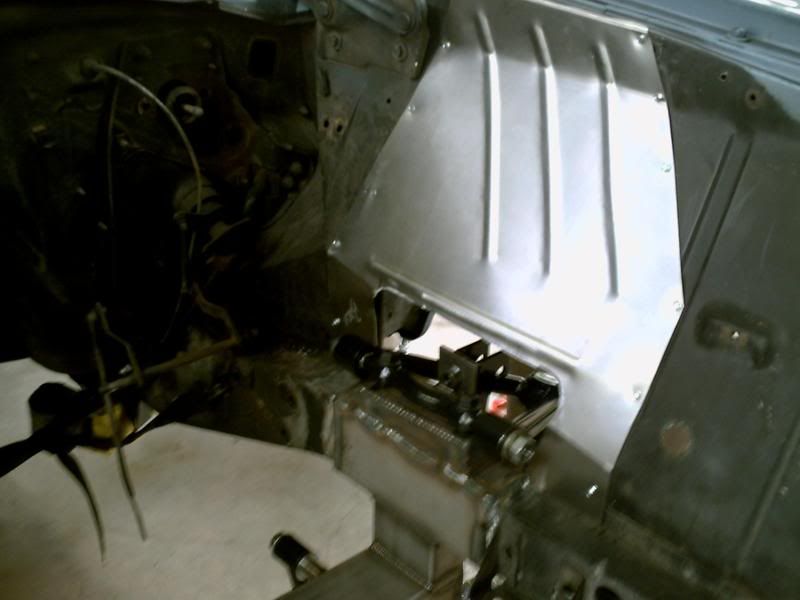

I cut out the dash and I am building an aluminum dash panel:

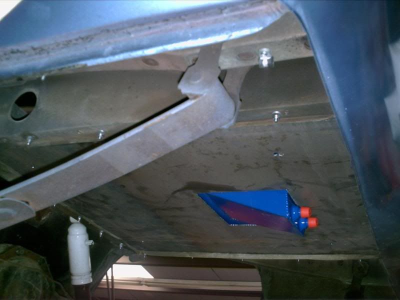

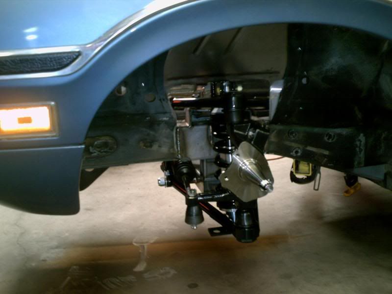

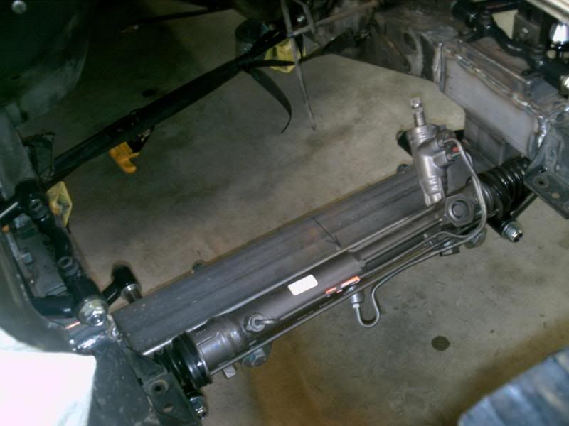

Cut out all of the suspension and installed the Mustang II front end. Once everything is fitted, it will all come apart, the inner fender panels will get welded in and it will all get painted gloss black under the hood:

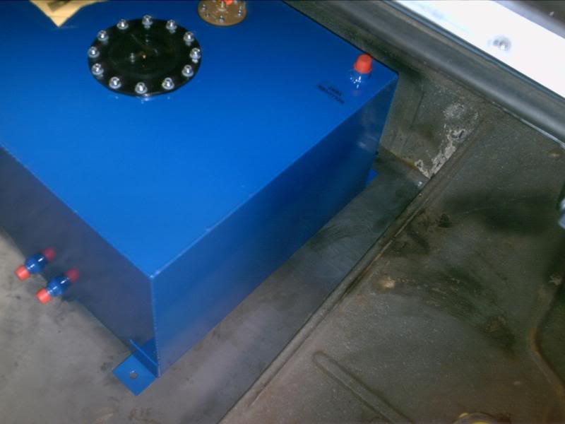

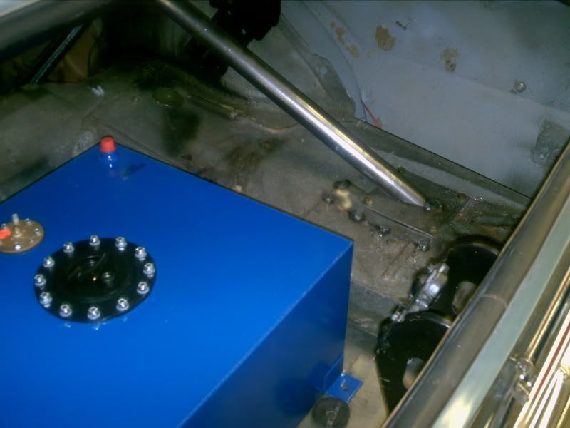

We decided to go with an aluminum Fuel Cell to simplify the fuel tank issue:

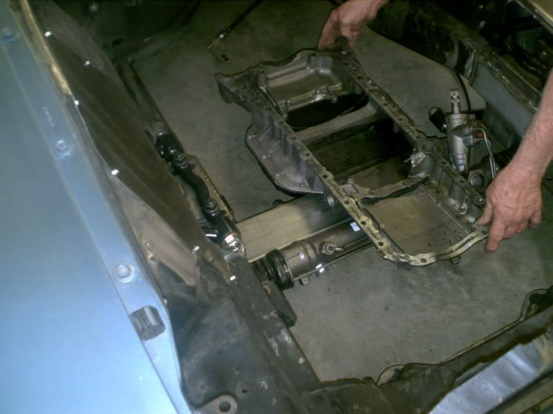

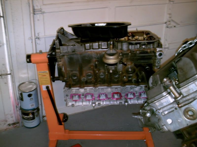

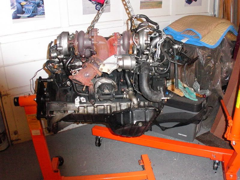

Yesterday I put together an old block assembly for mocking up the motor mounts:

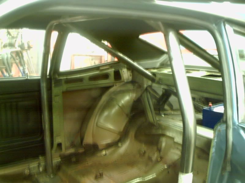

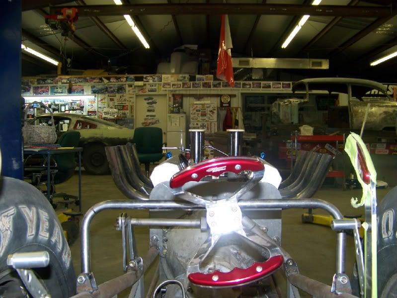

Rollbar went in yesterday:
We're having issues getting the engine in the bay. The sump is about 8" too far forward, need to find someone that can build us a new oil pan.

Lance,
Have you guys tried a mid-sump oil pan from a Lexus SC or Supra? The sump was much further rearward in the 2JZ powered Sc's and Supras. It's not going to go the whole 8 inches back though, but its worth a try considering the fabrication involved in a new oil pan.
How does the shifter positioning look? Could you maybe get away with an offset motor mount and move the whole assembly a bit more rearward? If that is the case then chances are you could use a midsump.

could always notch the crossmember, but that's a lot of work... but it might be easier than making a new pan as the only one I know of that has done that is RonR...

look's like a supra pan he's holding on the frame in the pic.

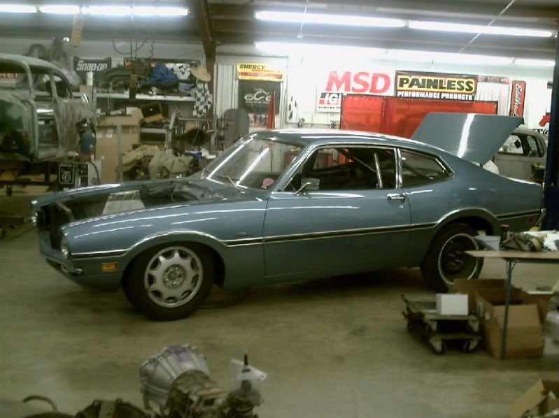

The shifter fits perfect. That engine bay is really small. The back of the head is about an inch from the firewall, and the front will be close to the radiator. The oil pan in not too big of an issue. We only need to re-make the sump pan, something that kicks back just enough to clear the cross member before it drops into the sump area, and extend the pickup a bit.
Our biggest hurdle now, is there is no room for a decent size intercooler, anywhere up front. I looked at it last night and came up with a crazy idea of sticking a small one behind each headlight and feeding them with scoops, and maybe a small one up front, then piping them all up in a series. I'll put it on the lift Saturday and see what will fit, and see what coolers are available. Any ideas are welcome.
I hate the side moldings. The thing is, I won't have time to paint the car, but that's okay, the paint is really nice that's on it. I was thinking of removing the moldings and perhaps airbrush a brushed aluminum stripe along there, then put a rivet or bolts in each of the holes left from the moldings. I'll dream up something cool, we will be putting their logo stripes along the sides anyways.
