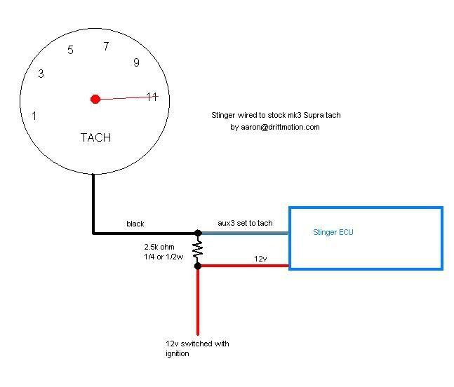

Aaron - My stock tacho is running a little out of sync. reading 250rpm with the ignition on without the car running! It also seems to get progressivly more out of spec the higher I rev it. Do I need to wire it in the way tou suggest below?
Yes, that circuit will make the tach read correctly.

Had to add a 1kohm resistor to make the Motec drive the stock tach :)
Was that a specific value that Motec recommended, or did you experiment with a few values?
I figured that having the least load on the tach output of the ecu, while still maintaining stability on the meter, would be the best way to go. I used a pot and went from about 1k all the way to 10k and it worked about the same, but I figured 2.5k would be about right.
