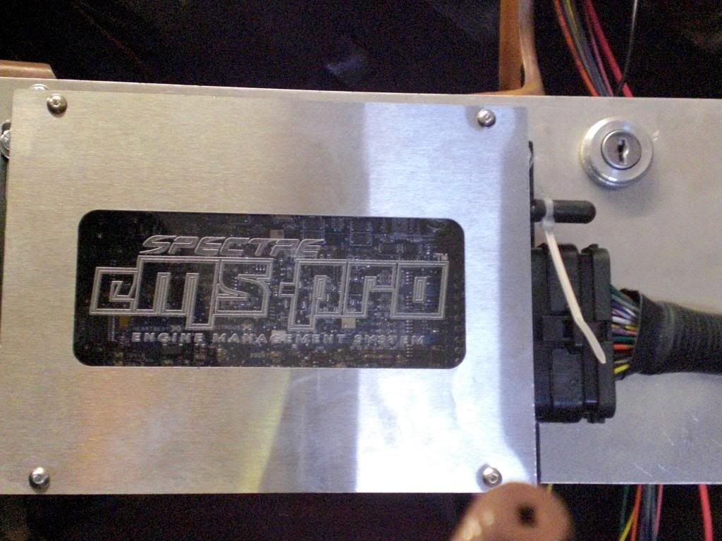

Just a couple of questions. One, In your sig pic, it looks like you have two shifters. Why? Also who made your roll bar kit? If you go with the Megasquirt, look into going with a V2.0 or higher and use a Ford EDIS 36-1 wheel and VR sensor not the CPS. Its super cheap to buy new and even cheaper to get off of a junkyard car. Use 94+ Ranger 4.0L or pretty much any 6cyl Ford from 93-2000ish. This method is good to 7000rpms with out break up. Looks very nice. Yall should think about building $2008.00 Supras for sale. haha
This is a version of Mega Squirt The EMS PRO. THis would kill your budget. ITs just for the pic.
