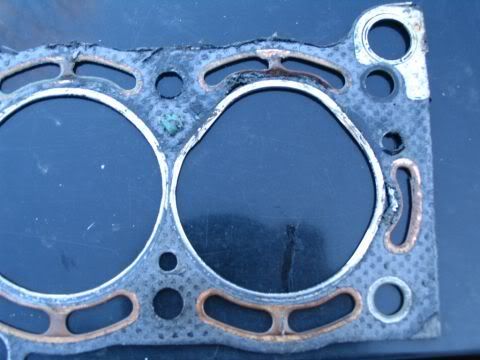

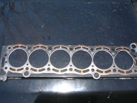

Ok, as an update, i finally got to work on it this weekended and got the head off today. I took some pics of the head gasket.
This looks like it could be the culprit....
Just by the look of it, it seems like it was banged or something while being put in which tells me it had a hg job before. any thoughts?

That is the classic failure mode of our swiss cheese gasket. The fire ring lost clamping force (check for grooving in the clamping surfaces) and was pushed by the combustion pressure away from the cylinder since the only thing stopping it was the tiny rib between the two water holes.
Clean off your deck and head and measure the fire-ring indentations around each cylinder with a straight edge and small feeler gauge. If its bad you will need to resurface the block. The head will have grooves too but those will get cleaned up when you resurface it.
Torque the stock bolts to 72 ft-lbs. You can also consider getting ARP bolts for more clamping force.

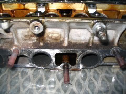

It also looks like your exhaust manifold was leaking a little. You would be well advised to heli-coil those studs. Much easier now than after its all back together and you strip a few when torquing the manifold nuts to spec.
heli-coil???

I am not saying you have to get the block resurfaced, rather check for damage and then make your decision.
These engines seem to always have some grooving from the fire rings shifting around due to the CTE mismatch between iron and aluminum. It's not a good thing because the groove reduces the clamping force in the area of the cylinders, which is where you need the most force. Measure it, and make your decision. If it were me, any grooving deeper than 1mil would be grounds for resurfacing. Pay close attention to that #6 pot, since it failed there last time.
If you want to learn about heli-coils look here.
http://www.supramania.com/forums/showthread.php?t=14788&highlight=heli-coil
