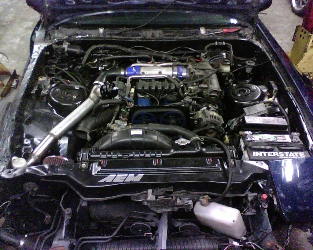

Been working pretty hard on the car the last couple weekend. The new intercooler piping is done. I bought a tial bov and welded that on to the new piping.
Found a break in the temp gauge wirng so I ran a dedicated wire stright to it.
Finally with help from jetjock figured out the wiring isses with the stolen maf. The problem was I was using a wiring diagram from mitchel and it was wrong. I figured out the right wiring and its all set now.
Compresion tested the motor all cylinders were 130 so there goes any fear of motor damage.
Replaced intake manifold gaskets.
Smoke tested the car again no vaccum leaks,smoke tested the intercooler piping no leaks.
So basically its done....again. Oil pressure stays good,holds temp perfect, no leaks,idles perfect.
Took it up and down the road a cople times. She drives awesome.

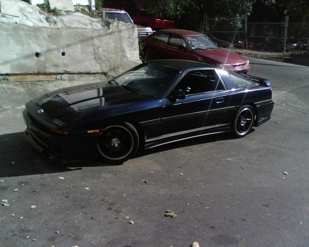

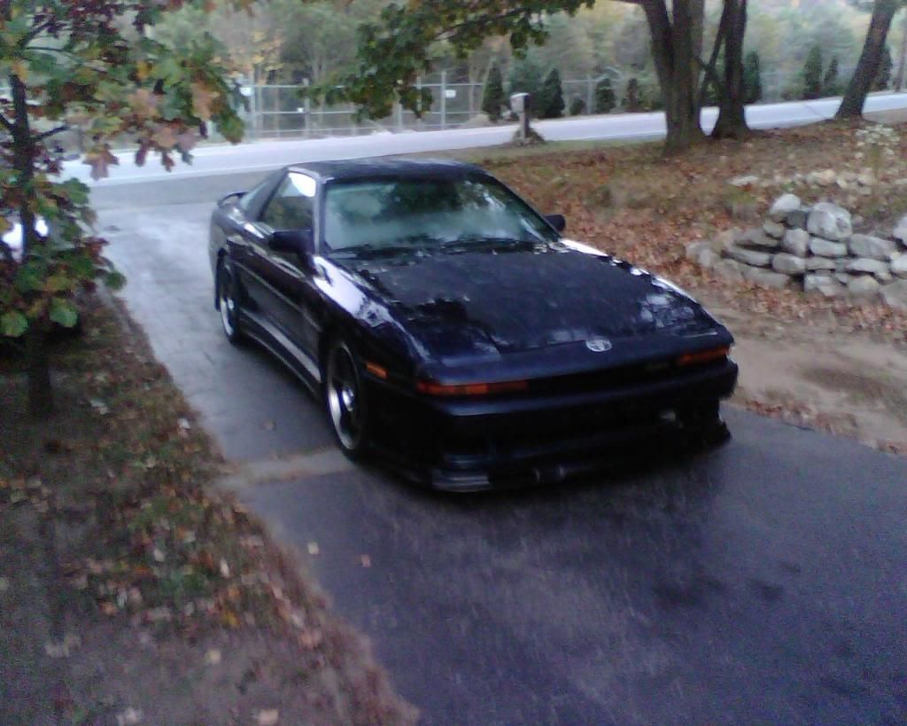

small small update.
alot of little boring things have been put togther the last couple weeks. body stuff, lights, coolant resioir yada yada. i did start finishing the kit and gave the car its first bath in 10 months. this weekend the pinstiping come off and maybe the fron lp.i am fabricating mounting braket to mount 89 and up lips on pre 89 cars if anyones interested.
pics are from my phone sorry:3d_frown:
a couple local guys came down and chilled for a little. had to snap a pic.
:biglaugh:

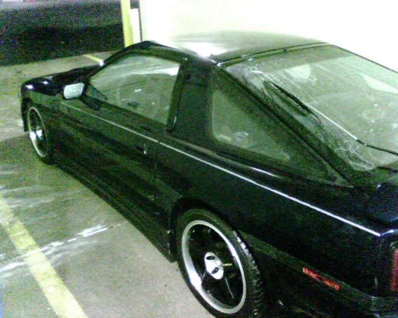

i just have a few pics for now. i parked it for the winter. i am contempating selling the built motor. i have started to get the 2j ready. just havent decided if it will go in this car or a new chassis. anyway:
about a month ago and a half ago. everythings cleaned up and finished this was lke 90 percent done.
Low
thats all i have now. prokect rebuild burnt car complete...project 2j that bitch next maybe???
