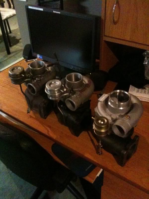

my turbo's at the post office collecting it tommorrow, ill post a comparison picture between a ct26 stock, 57trim and this T61. not sure how long till i get it inspected...

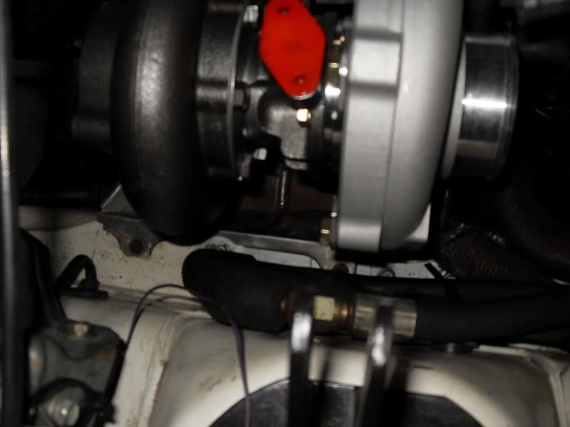

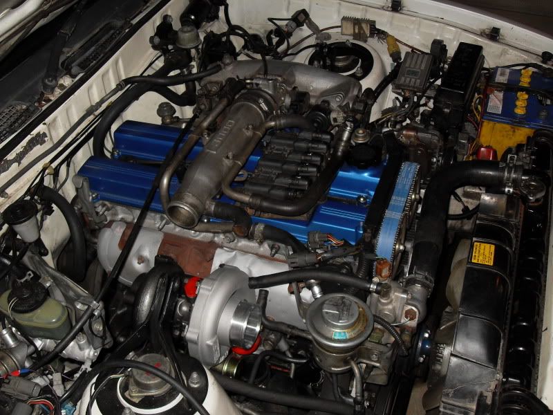

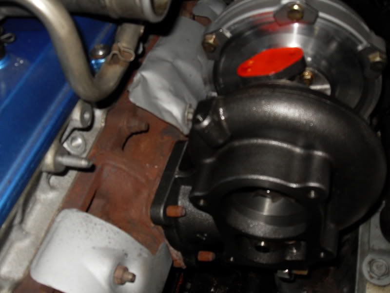

got my turbo, doesn't look too bad.. took some test mounted photo's.. im running a ct26-57trim for now

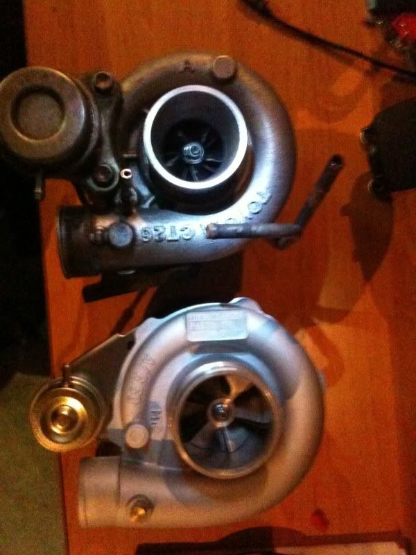

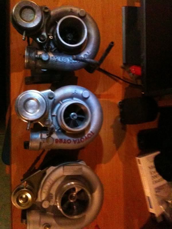

here is a comparison between a CT26 (stock), 57 trim ct26 and the T61

It looks to me like it's just a hair larger than your 57 trim in pretty much every dimension, but it might just be the pics. How would you say they compare size-wise?

Poodles;1428523 said:
That's the wastegate actuator and size doesn't matter (boss turbos use smaller than stock ones as well)
does too!, my ct26 was creeping but bigger the turbo less manifold pressure

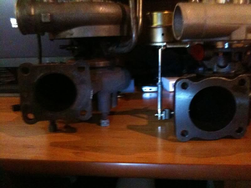

the waste gate port is about 2mm larger than the ct26 port
the housings look not too bad :) see what the turbo builder says.
it bolts up perfectly, clears everything, and WILL fit stock i/c piping it came with oil fittings aswell, some bolts and gaskets.
i'm running a ct26-57 trim atm until i can get this inspected /checked or rebuilt.
sorry for the quallity of some pics, digital camera ran out of batteries and used my phone for some.
as for shaft play it feels tight,
stock ct26 vs t61 rear

Black;1428653 said:
Hi, great photos :thumbup:
Keep in mind what Poodles said!!! Do not use stock elbow!!!
i've got a 3" Dump(to the cat) with a divorced waste gate pipe which joins in 1m after the turbo
is there anything anyone would like me to take a photo of?
i hope to take it to the turbo builder within the next 2 weeks
BTW the inducer is 3" so im betting the stock accordion hose wont work as one end is 3" and the other end is smaller (2.75"??)
my ct26 57 trim "looks a touch smaller" but really the inducer is smaller on the 57trim, but the t61 is massively bigger than the stock ct27
I'm not sure if you can notice but the rear housing is larger for the t61.

Stock accordian pipe MIGHT stretch like they do to run a lexus AFM. What DDP do you have? If it has the tab that sticks out you're going to have to cut it off and run a gasket kinda like what's shown in this auction: http://cgi.ebay.com/ebaymotors/Down...r_Truck_Parts_Accessories?hash=item2c50840d00
My worry is that a DDP might not line up correctly and I see the company that make the turbo also sells a bigmouth downpipe...
I can check if the accordion hose will work, i think it will tear the 21 year old piece of rubber to be honest.
my DDP was custom made, so i don't have to, need to check that it will seal against this new turbo first and modify it if needed..
is it just me or do the impeller blades look a little rough cast?
Just a hair huh. I just took a look at the pics and DAAAAAAMN. The compressor wheel on the 57 trim look like a joke compared to the t61. If its not exactly 61mm it looks pretty darn close IMO. Ill be checkin this thread on monday for any updates. Keep up the GOOD work on the info and pics :beer:
