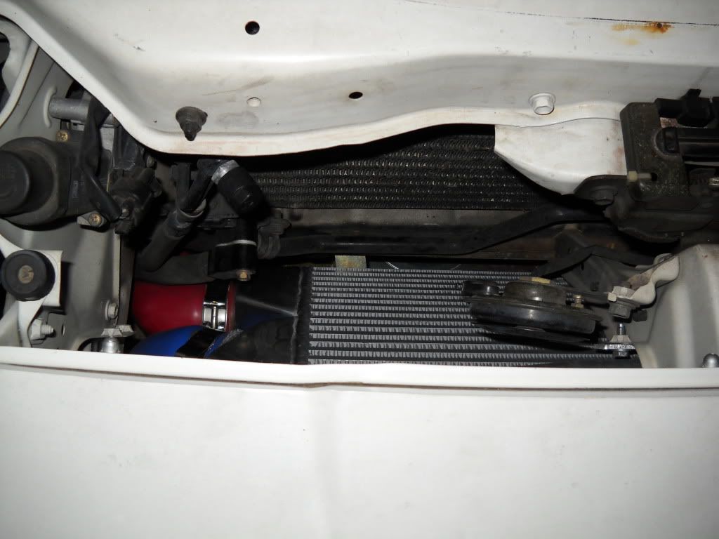

Great news... I just got the new charge piping and intercooler installed, and should have it on the dyno in two weeks @ 19 psi. You mentioned you finally got your boost leaks fixed as well, so any updates on how it's running? I'll post pictures of the new setup in a day or so and have the dyno results everyones been wanting hopefully by the 15th!

The new setup with NO boost leak. The wastegate on this turbo blows! It's extremely stiff, and I'm still havin a bit of trouble getting the turbo to spool at a decent rate... Dyno run is comin next on the 14th @ Intec Racing!
