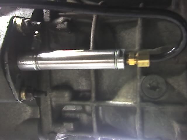

ok, i was at the junkyard saturday and a guy pulled a slave from a jeep and it looks like it would fit the t56 perfect, but its plastic which i dont like. sooooo, instead of modding the r154 slave to fit i figured id give this slave a try and did some searching. here is what the jeep slave looks like that is from the same jeep as the clutch arm pictured earlier.
then i found these 2 threads that shows how to make a metal slave to replace this pos plastic slave.
http://www.universityofjeep.ca/Tech/Clutch/Clutch_Slave_Repair.htm
http://www.jeeps-offroad.com/showthread.php?t=29056&highlight=slave+cylinder+mod

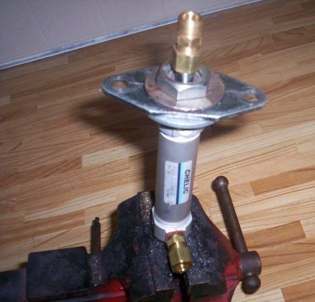

heres what it looks like after completed except ill make an adjustable push arm for the rod end of the slave that will hold the stock plastic cap so it wont wear out the clutch arm
and here it is installed ont he jeep. some guys grab the single action and some the double action. i will likely grab the double action and put a tiny bit of fluid in the secondary side then a 1in long fitting or so wit ha cap on it. the air will compress allowing it to work but the tiny amount of fluid will keep it lubed on that side as well. longer life. these peneumic cylinders are ~$18.00
and for the guys worried about what fluid would work on the nitril seal in the clyinder its been found dot 5.1 fluid will work and is compatable wit hthe rubber of the stock master cylinder and this cylinder. my mk2 master is a 5/8ths bore and the slave is 3/4in bore so it should be ok. im gonna buy the 3in stroke one to be safe and once its all hooked up ill install a clutch stop on the pedal if necc. if i went wit hthe internal slave from tilton id have to install a clutch stop anyway. also, for the inlet im going to use a t fitting so i can install a bleed screw to make it easier to bleed the system.

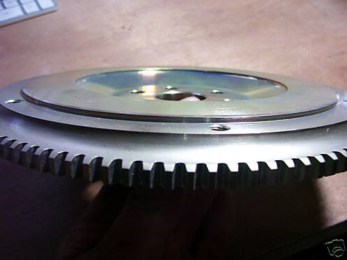

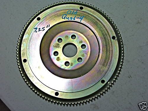

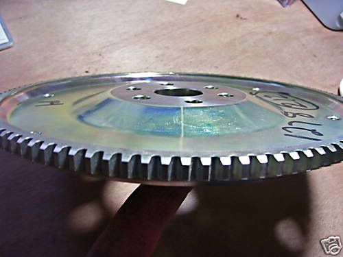

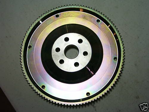

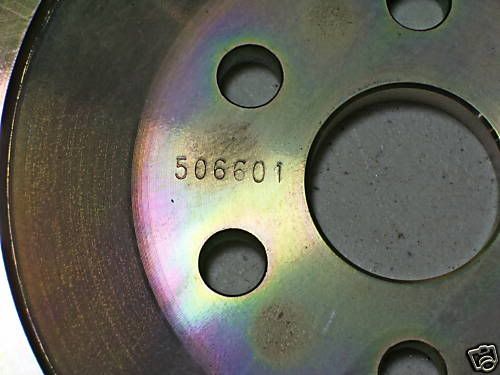

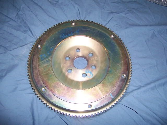

well, saw a flywheel i thought ight work, its for a quad 4. so i took a stock flywheel to napa and grabbed a quad 4 flexplate. 5 holes line up perfect. so all i need to do when this flywheel arrives is have 1 hole plugwelded and redrilled to the offset position and then the center hole bored out to match the 7m flywheel. i dont expect that to cost too much. and this is a brand new flywheel, not used. a major step toward the completion of my 6 speed swap. too bad its so heavy. it weighs 7lbs! ;)

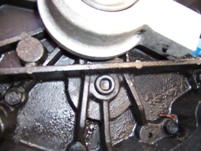

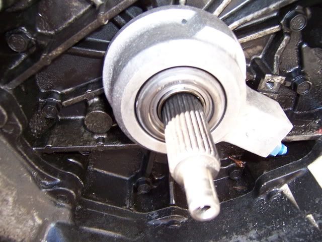

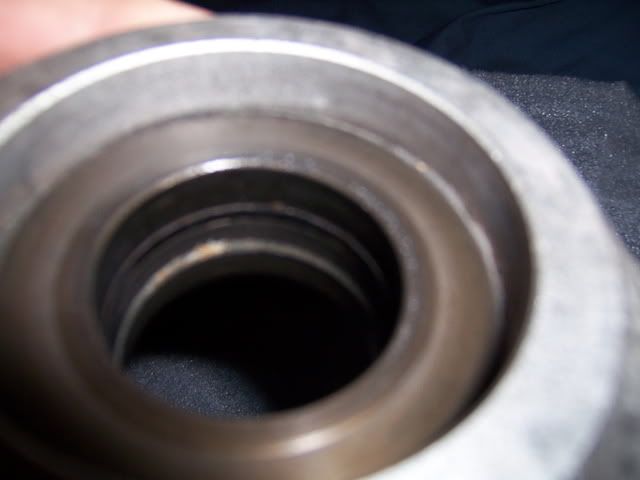

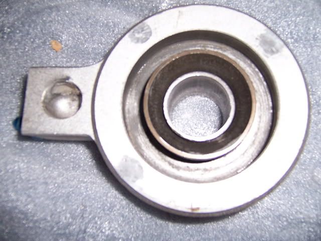

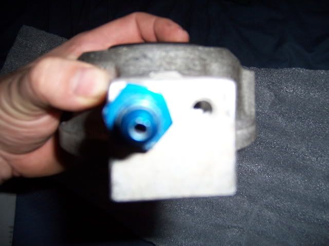

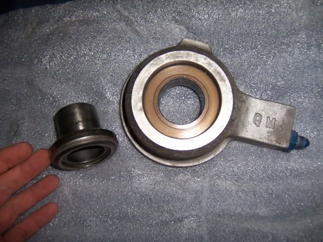

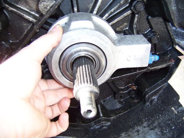

got another part in the mail today. won it on ebay for super cheap so had to buy it. ill prolly rebuild it before i use it just to be safe.

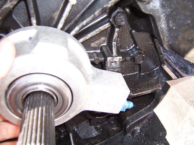

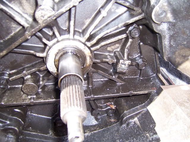

test fitted the slave on the t56 today. it fits. the hole for the release arm pivot is a lil off for the hole in the slave to fit over a pivot ball, but ill be able to use a piec of angle. bolt it to the slave from the side and then to the trans to keep it from spinning. pretty simple. only problem i see is there is a lil slack so it isnt perfectly centered. i need to find a tubular sleev that has the right outer diameter to fit the inside of the slave and the inner diameter to fit over the input shaft sleeve. itll be a pretty thin piece. need to take measurements to get it right. forgot my dial caliper. ill have to do that later. but anyhow heres the pics.

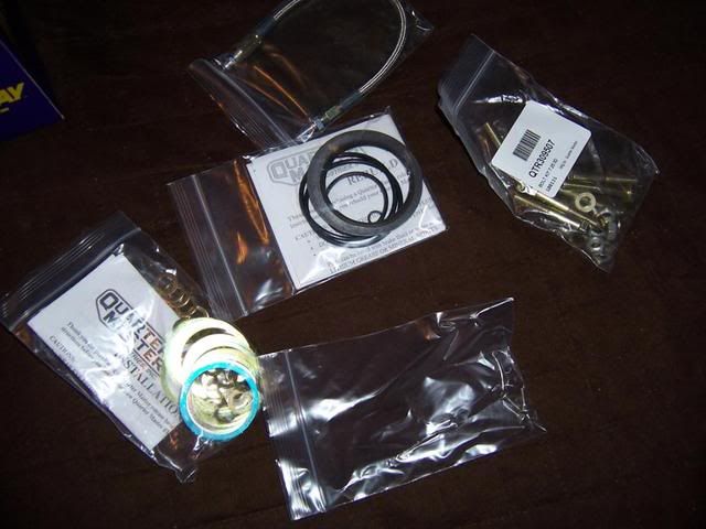

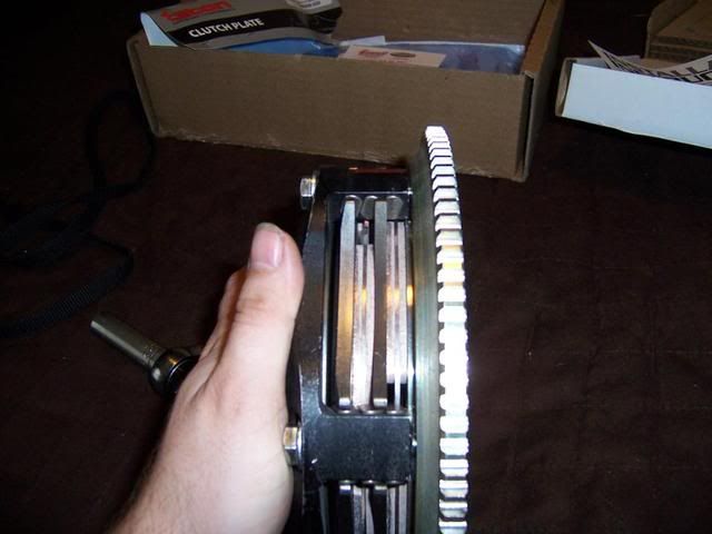

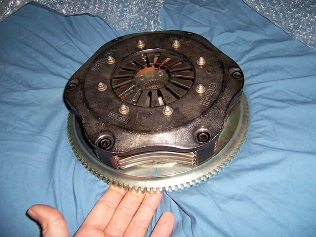

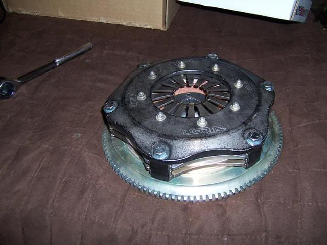

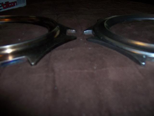

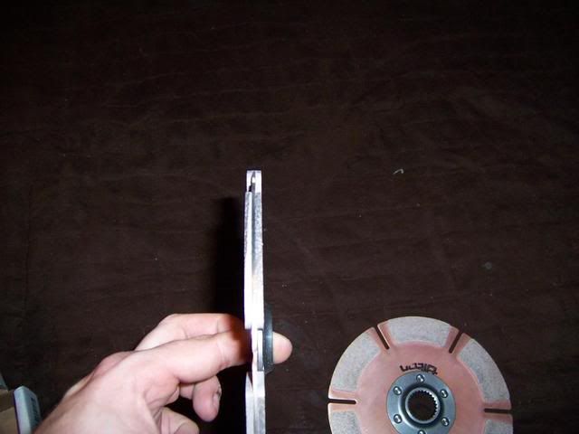

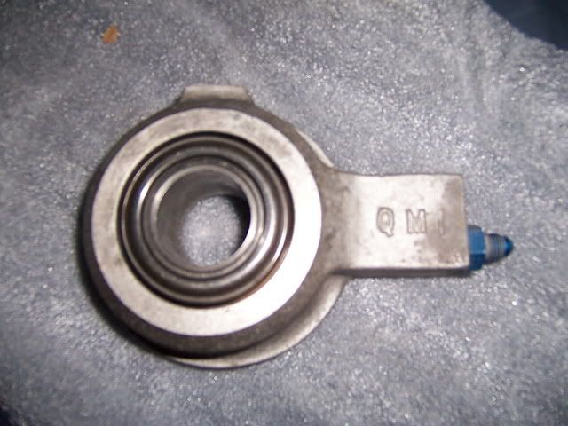

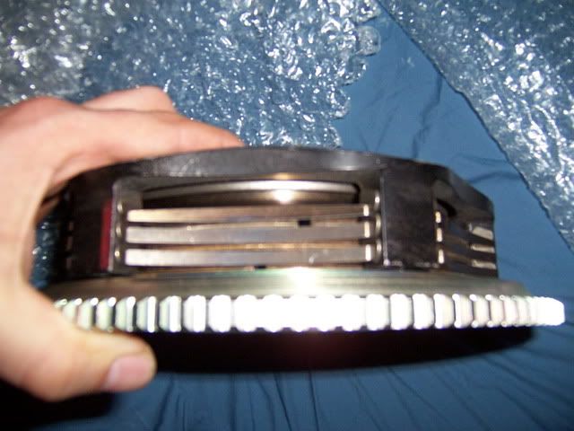

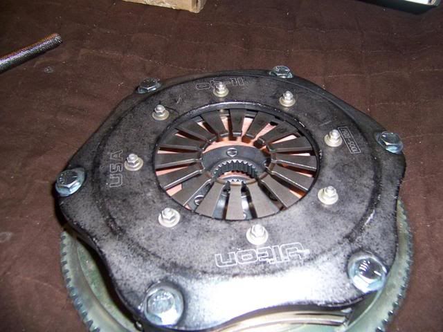

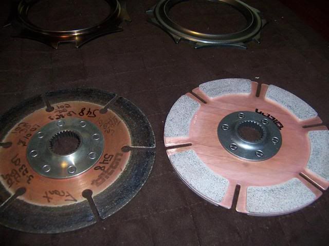

the bleed line and rebuild parts for my qm1 internal slave cylinder. also shim kit and clutch bolts.

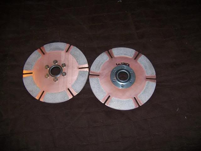

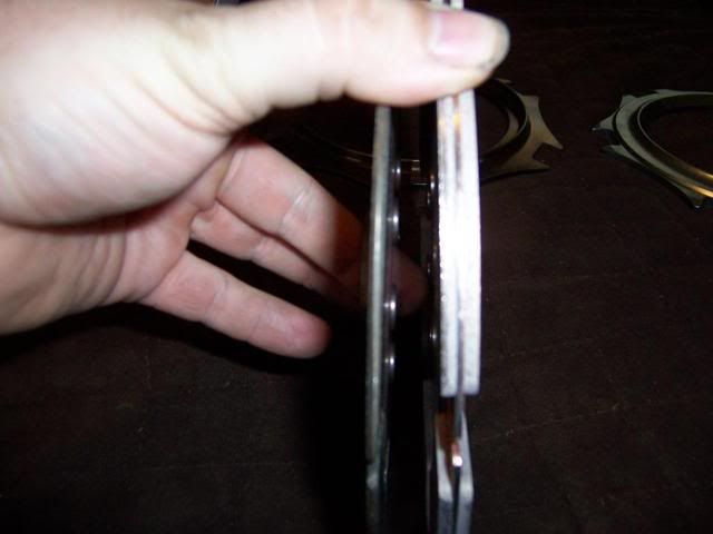

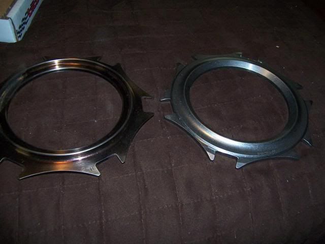

my tilton twin cermetalic discs for my t56 swap.

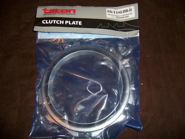

this is my tilton ultra high ratio pp spring
the parts laid out with the tripple plate metalic parts. twin disc cermetalic and tripple metalic both use the same cover.
and the twin plate setup assembled.
williamb82
Apr 24, 2005
907
4
Tampa, Fl.
well its these or organic ad the organic wont work for drag racing at all. ill live with these discs as this isnt my daily driver. thats what the ls400 is for ;)

nope. never did it on the 7m as ive switched up and am going 2jzgte instead. so it will be bolted to the 2j when it goes in. not much has progressed on the t56 swap. i have pretty much everything i need except the flywheel, which is ~$550. though im likely gonna pay to get the trans upgraded and switched to the viper rear housing and output shaft etc.. before it goes in.
