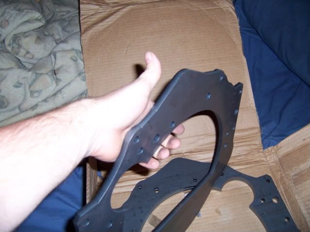

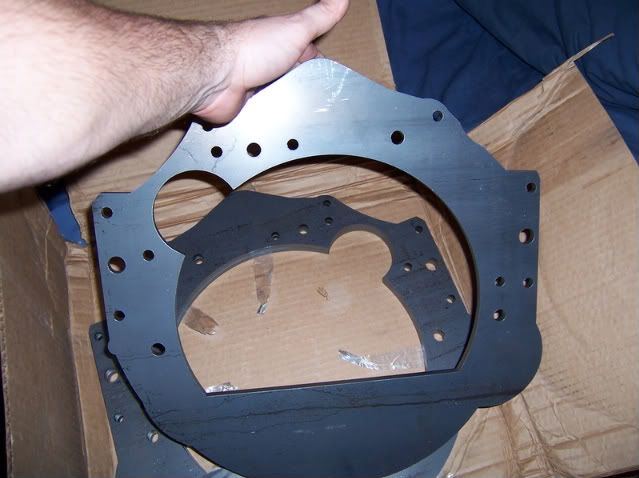

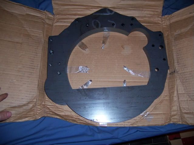

got my finished adaptors in today. ill post more pics when i bolt it to the junk 7m in storage for grins. lol. also, this adaptor plate only weighs 13lbs. so all those that said a steel adaptor would be too heavy, obviously it isnt. lol. ill be dropping more then 13lbs from the clutch assembly alone by goin with the 7.25in tripple setup.

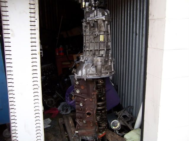

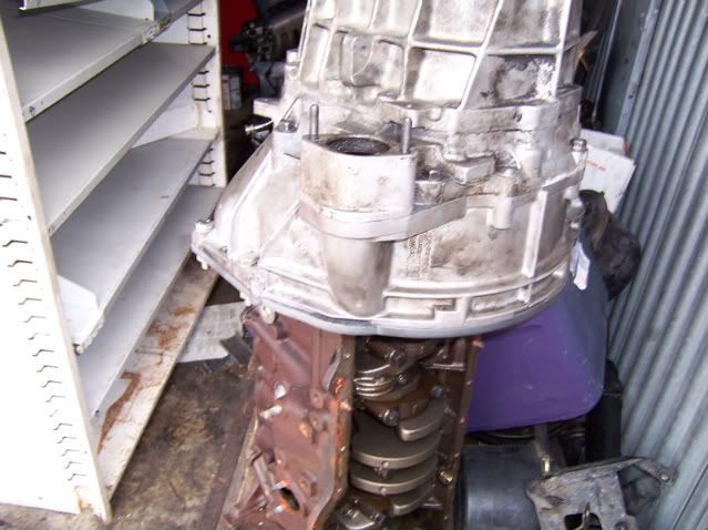

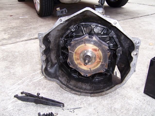

sunday arz from arizona (andy) came over as he was here in florida and wanted to check out my progress. he is an awesome guy. we hung out, fitted it all together so he could see himself its centered and take measurements for his z etc.... and i snapped these 3 pics. meant to take more but forgot cause we were brainstorming so much on stuff. that guy is a genious!!!! anyway heres the pics of it bolted on wth my permanent adaptor and also of my tripple plate clutch slide on just to see how it fits inside the bh as we were working on ideas for a release setup.

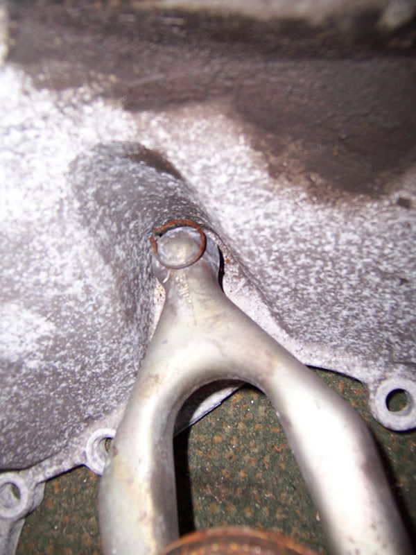

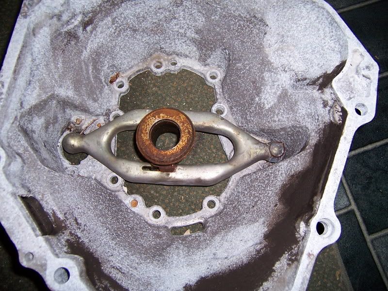

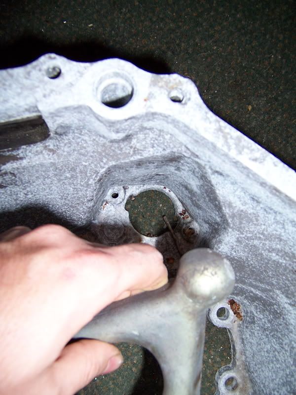

well i was searching ebay for slave cylinders and saw this jeep arm and thelightbulbs went off. i already had one outside from the trans we got for my bros jeep as his had a diff bellhousing and release setup. lol. heres the pics
im gonna try to bolt or weld a piece into the t56 for the ball to thread into to mount this arm then i can just mount the stock r154 slave as arz suggested which will be rather easy for me. itll be WAAYYY cheaper and also allow the slave to be changed later if necc. its from a 97 jeep tj series.
this is the link that gave me the idea. lol.
http://cgi.ebay.com/ebaymotors/jeep...009QQitemZ190214640421QQrdZ1QQsspagenameZWDVW
ill test it in the t56 this weekend to see if it will fit. i can shorten it easily if necc. it is steel. ill use a new bearing of coarse. i dont think itll need to be shortened though. lol. should work in the r154 as well.
