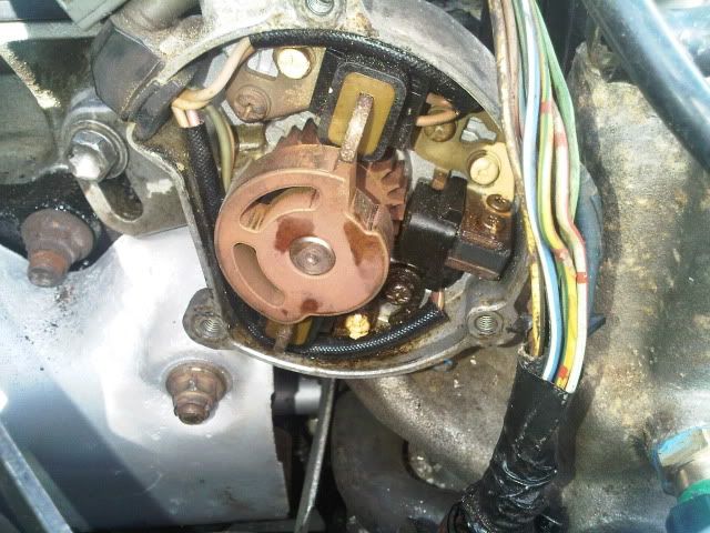

Thats what I thought. So I checked it, brought #1 piston to TDC and then went clockwise about 5* to make the notch mark on the crank pulley line up with the 0* mark on the timing belt cover. Removed the CPS and confirmed the notch marks are aligned. Reinstalled the CPS. Now I'm getting a spark on every crank just not starting. However, reading over Shaeff's Article it looks like I missed the step to turn the CPS one tooth in the opposite direction. I will try that in the morning and see what happens.
SupraRon
Jan 2, 2008
595
Canada
That I didn't check, but I went out to check it today.
This time around I installed the CPS with the cover off to see how it was aligned. I tried to start it up and still no go. Just cranking, but not starting. Anything else I could be missing??
SupraRon
Jan 2, 2008
595
Canada
Well after much fiddling and once again relying on Vic for his expertise, she STARTS!!!!!!! If you look at the bottom pic in my post above, I had the CPS positioned one tooth backward so that the tabs lined up. Vic shifted it one tooth forward and the startup was successful. I'll get a vid of it tomorrow as its too dark out now. I'm like a kid in a candy store! :D
