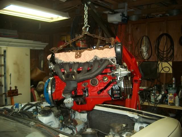

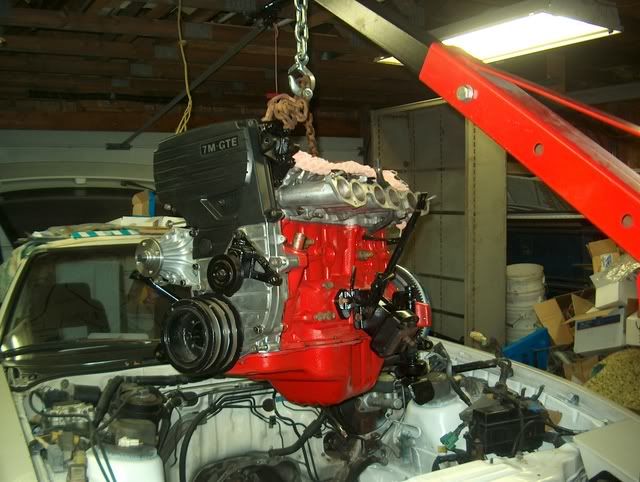

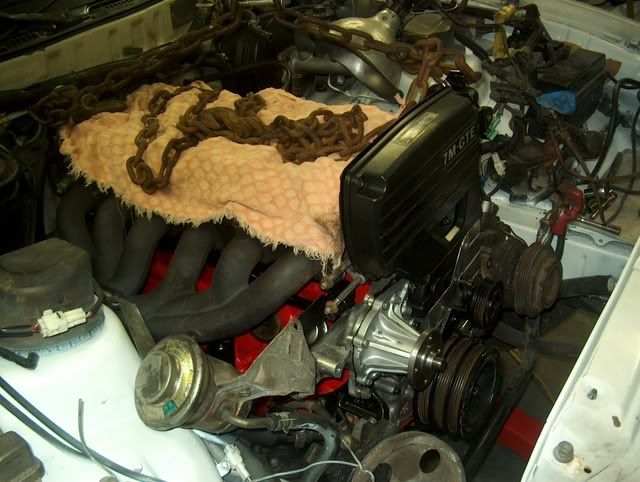

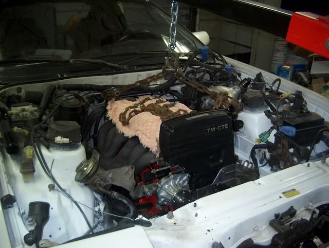

We took care of all the family get togethers sat and sun so this is what i did today on X-Mas while the wife slept in LOL, Put the RPS max clutch i bought from suprarich Store , fidennza flywheel, and Installed the motor in the car. I dont even want to add up all my receipts close to 8 grand i bet.:evil2:
