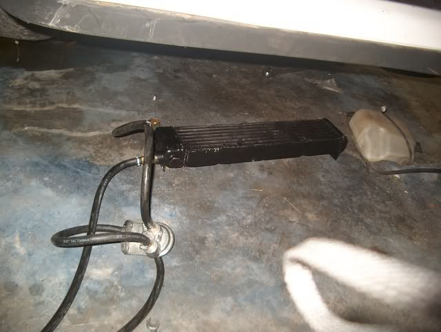

Well all did not go as planned because i could not find room for the oil cooler:icon_evil

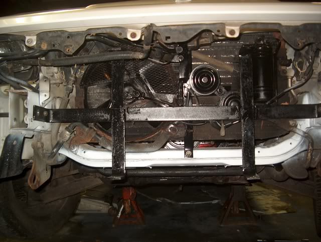

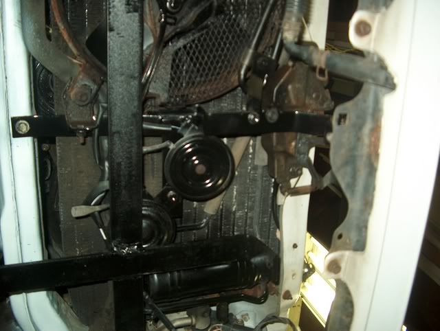

So i took pics for reign maker of the brackets for the intercooler and nose support i made.

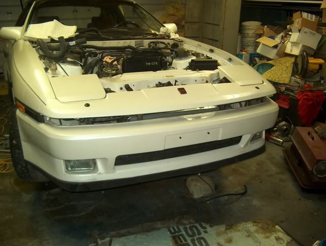

Then i tried my front bumper for fit. ,All went well.

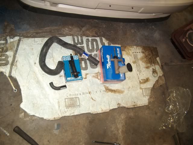

So i go down to the house to get a beer and low and behold look whos here FEDEX truck then i see this Blond babe in a fedex iniform.:evil2: So i asked her if she would like to stay for a beer but she had to go .Figures oh well she brought me this.

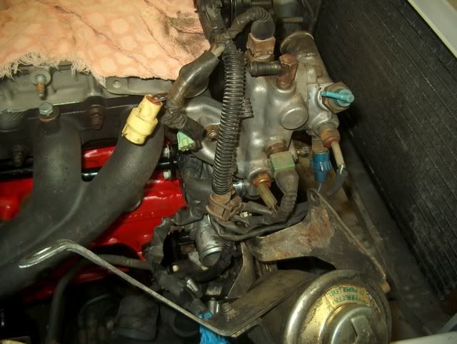

Then i take my new thermostat hose and install the thermostat.

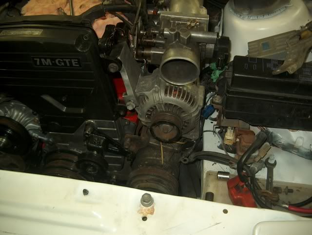

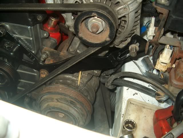

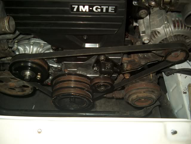

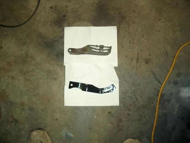

After that i start working on my alternator drop down bracket and try to install the lower bracket but it would not fit so i made one:biglaugh:
So the oil relocation is for another day.

Not the hoses and clutch master is a top of the line one,And i dont have alot of time so i order online.
