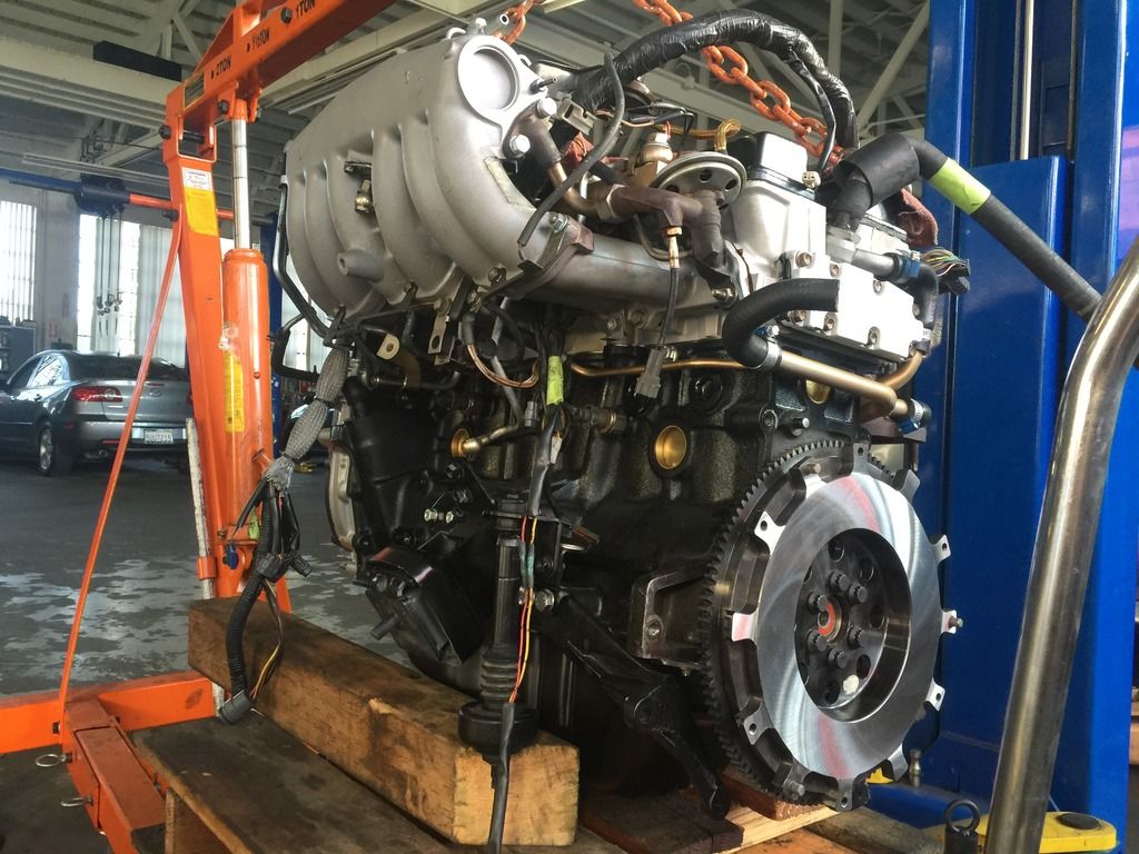

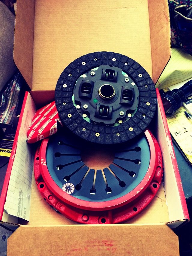

I finally chose a clutch.. went with driftmotion's upgraded pressure plate and stock Toyota disc. Absolutely loving it so far...
And realized that I already had an ACT flywheel... sweet!!

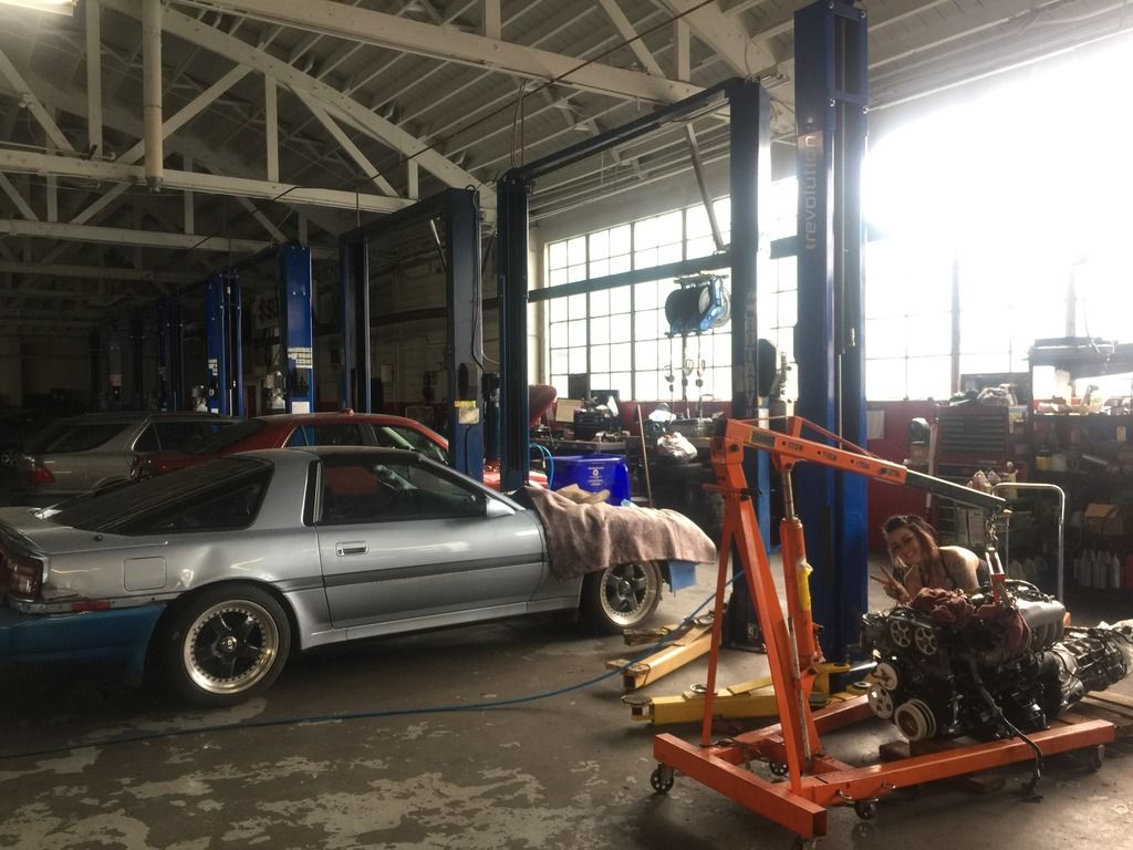

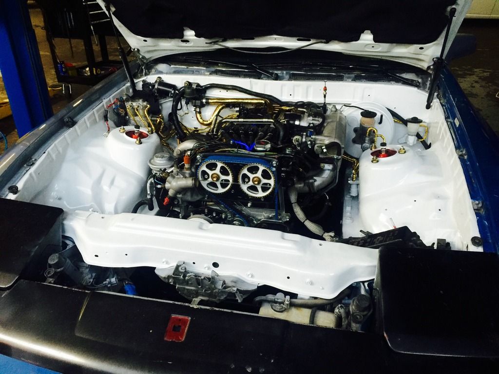

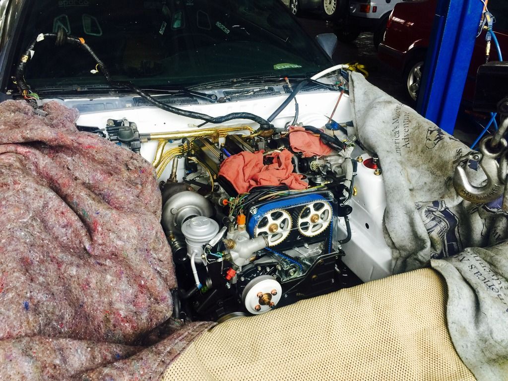

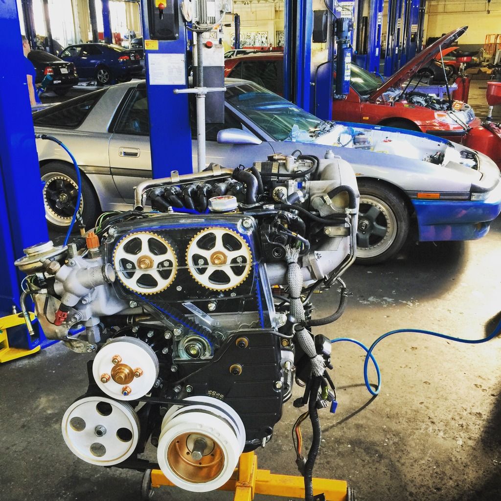

Shameless post of me prepping the motor for install ^_^
Looked so good after first seeing the motor sitting in there:

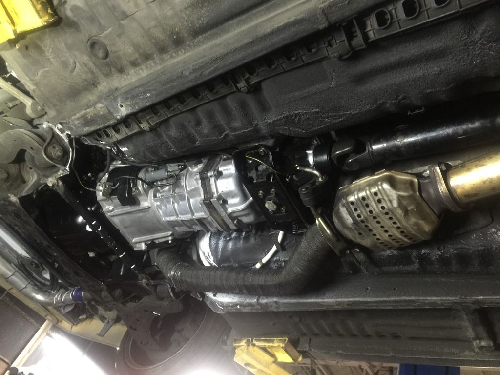

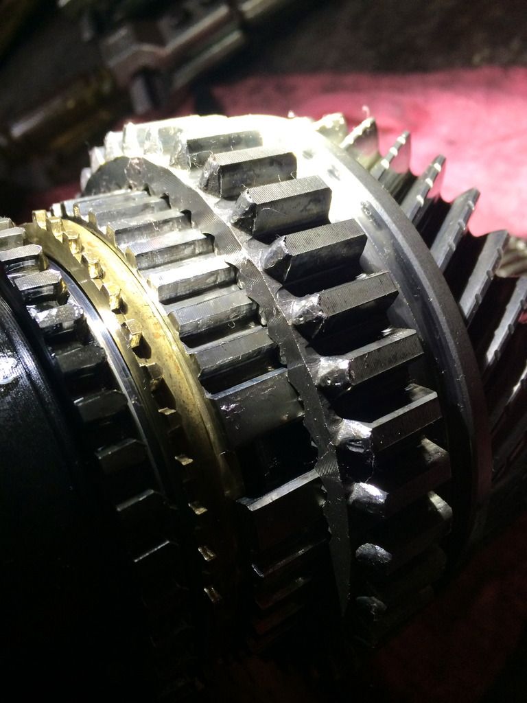

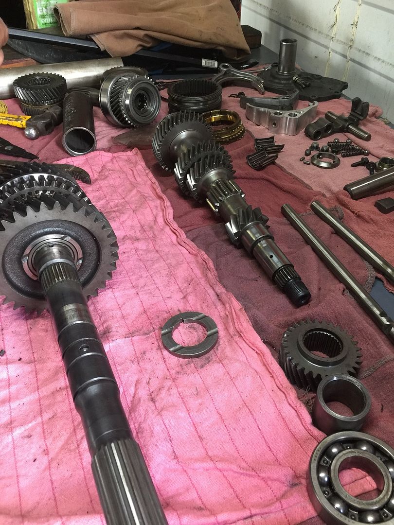

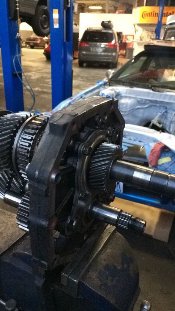

The transmission was the hardest part for me. I literally ripped it apart and put it back together 3 times. I also had one of my coworkers give me a hand, and try to help me out (I am also still a little intimidated by our shop press.... haven't gotten over my fear of it yet, or the spring compressor...) so I actually had help every time. Thanks, Loyd! I should share some pictures, because it's kind of crazy.
Here's re-assembling it, the first time:
I actually had taken a term of tech school a few years ago, when I applied for a program here in Portland that paid for technical training for women in "trades" ... whatever the f*ck that means. Anyways, I had taken a class on Manual and Automatic transmissions, so I thought it would be cake.
The final time I got the thing reassembled, I thought for sure everything was great, it went through all the gears, and life was good, but after I got it in the car, I wasn't able to get it to engage in any gears. Thinking that maybe after I put gear oil in it and applied some power, it would go back to shifting fine like it had on my workbench, I went forward with installing it onto my engine and dropping it into my car. Took another weekend to hook everything up on the engine, fill cooling system, connect wiring, fuel, vacuum lines, etc, and finally turn the car over to realize I was stuck in gear. Several days of frustration later, and a really shitty Friday where every car that I touched ended up being a clusterf*ck of madness, I pounded some energydrinks and ripped the transmission out again. I scraped the paint on the back of my firewall removing it, and our tranny jack is less than optimal at the shop, so what did I expect ?? but you can't even see it. Anyways, I gave up and brought my R154 to a transmission shop.
When they had it all torn apart, I guess I had swapped syncros from 2 hubs... "It would have been so easy for you to fix it if you had just taken in apart" the guy at the trans shop said, "It would have jumped right out at you!" ... fair enough, but I had given up so I just let him take my money.

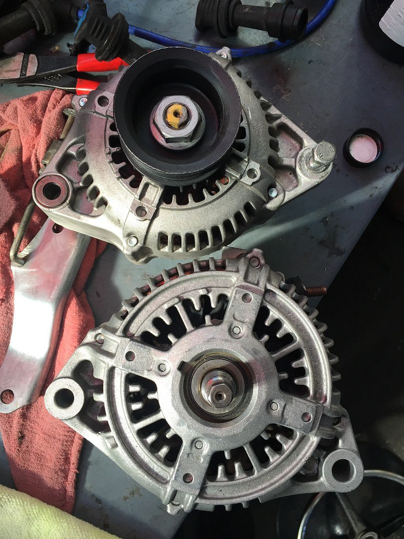

Other things that were fun, I had gotten an upgraded alternator from a 1JZ in trade (I didn't really want/need, but figured it would be cool to install and see if it did anything!) So I had a machine shop bore out the inner diameter of my 7M pulley to fit on the 1J alt, found a connector from a Toyota Camry to fit (different plugs on the alternator) and took a trip to the hardware store with a lousy sketch of the tensioner I wanted to build:
I need to find some more pictures of it installed with the tensioner and stuff...

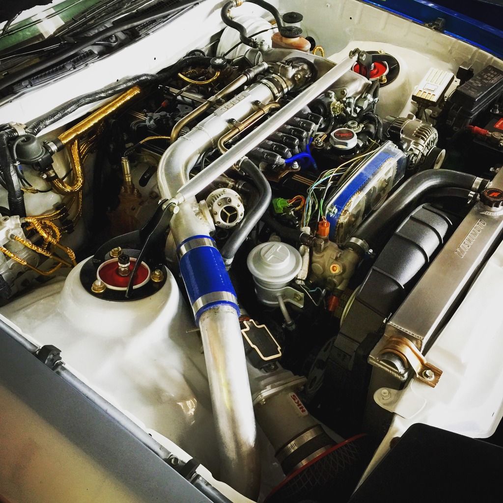

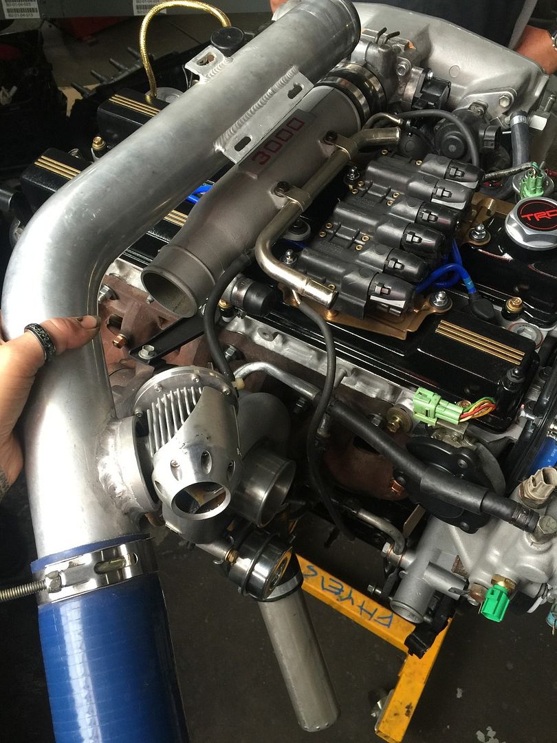

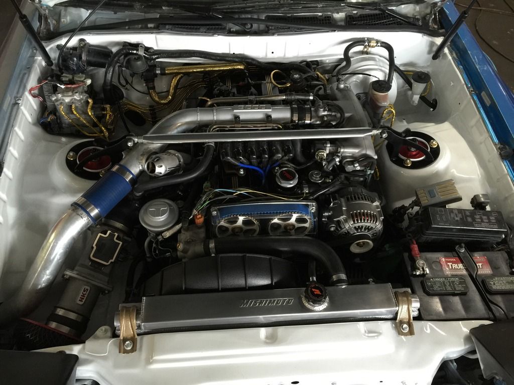

You may remember my engine bay looking like this:
I never really thought my engine bay was ugly, I just thought that the cheap eBay intercooler kit was tacky as hell, though I didn't feel like spending money on an upgrade... it would be short-lived, afterall, since I am hoping for an FFIM, and I will redo the intercooler piping then.

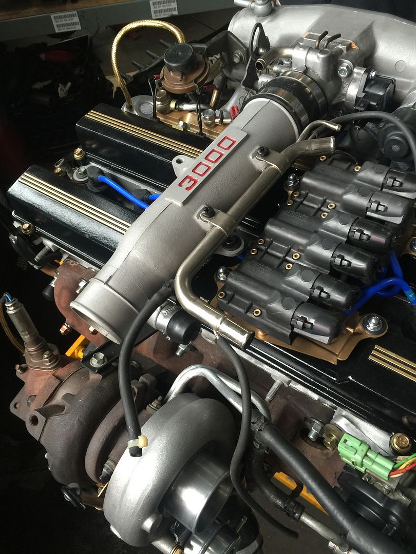

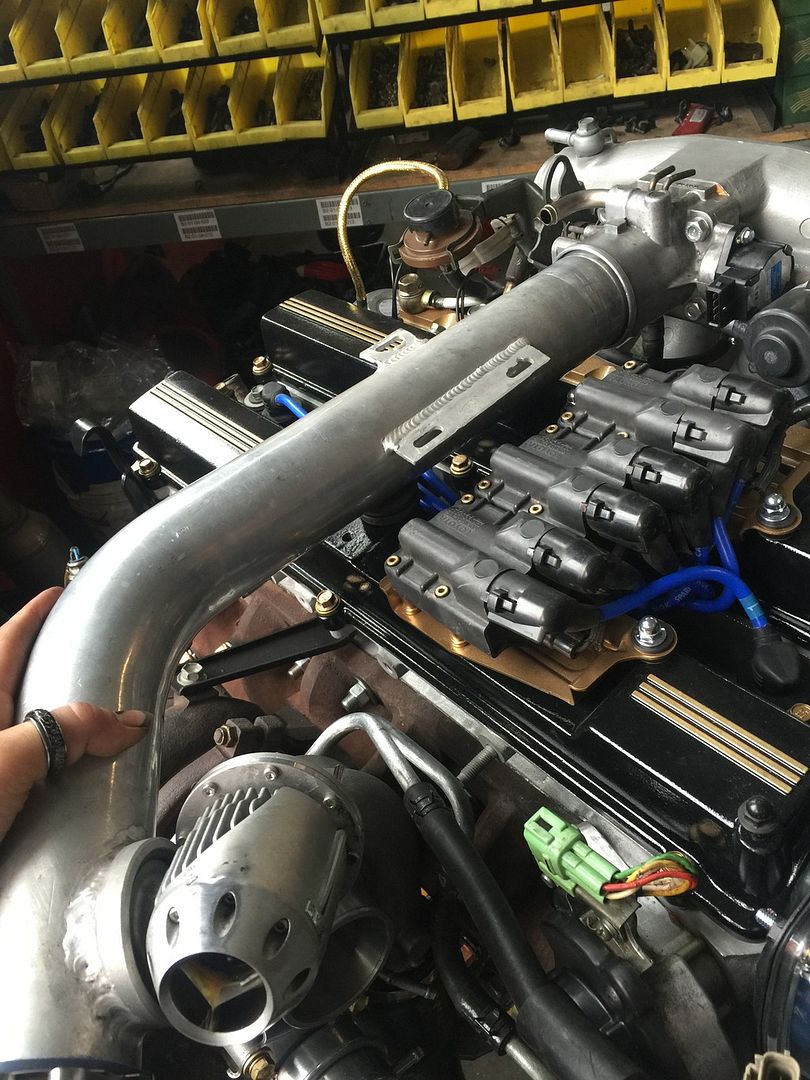

In interim, I thought a custom 3000 pipe would work well! And though I can weld, I opted to pay a professional to tig the cast 3000 pipe to the thin charge piping.
I think the end result turned out pretty well!

So mint!!! loving it! Oh what ended up being the problem with the tranny? going to be doing that to my tranny soon and hopefully don't round up doing the samething
If you check out the photo of the close-up of my reverse hub... The issue originally is that it would pop out of first gear. During rebuild, I just upgraded everything that I knew to be common failures on the R154... The first gear thrust washer, first gear shift fork, etc. ... All nice Marlin crawler stuff :) I did have issues with fitting the washer... I had to grind down the pin.
The issue was that I swapped syncros from 2 hubs... :-/ lol so as long as you pay attention... (And don't just rip open the packages in excitement and litter your workbench with unorganized parts, then you should be fine!!!)

Really love the way that 3k pipe turned out and you're able to use the mounting spots for the PCV piping too! Lets go for a cruise soon, I'll bring my camera!

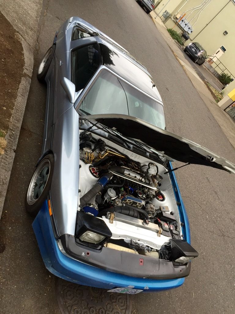

First real cruise: 150 miles in the Columbia River gorge. I love living in the PNW.

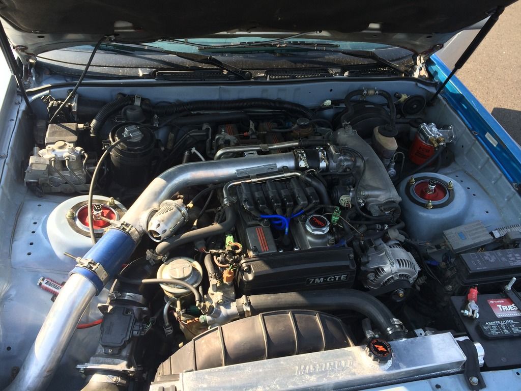

Ugly car, pretty engine:
Red Door Meet in Portland, Oregon (every Sunday 6pm under the Burnside Bridge) You can see my smiling face in my rearview...

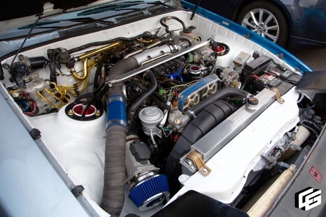

Sweet engine bay pic someone took at Red Door:
And thanks everyone for the positive feedback.... And sorry for the loads of photos :"D
ahhh i see my bad couldn't comprehend the 2 syncros part from the last post. Cheers!!
