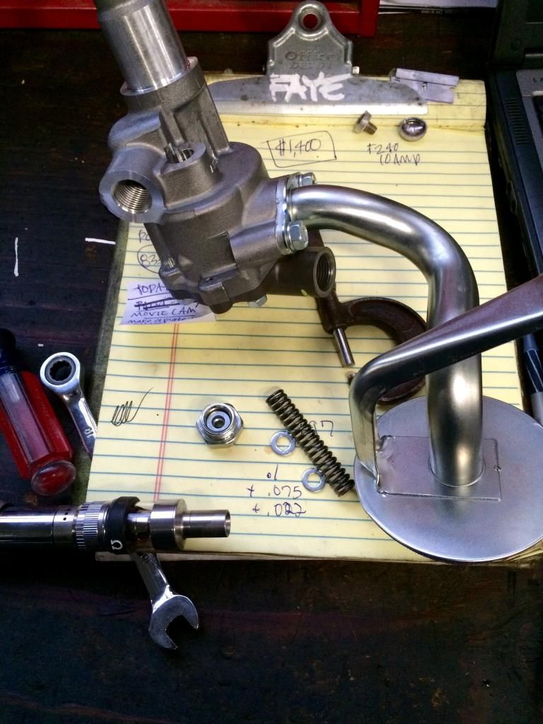

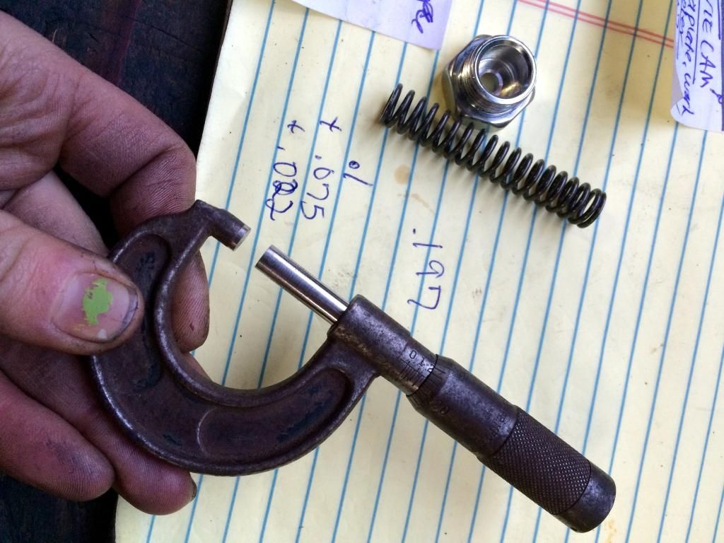

bloodasp90, it won't change at all at idle or lower RPMS. Shimming the spring only delays the pump from recirculating oil back into the pan. I am not sure what it was at before, but I will certainly know (since I will be fixing my oil pressure gauge as well!) what it will be now, so we can compare numbers and see what the "gains" are, lol, if any! It was kind of more of an experiment, if anything - I have never had any oiling issues with this car, but I figure it certainly doesn't hurt and didn't take me much time or any money:D

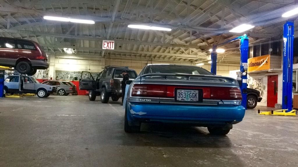

Last night, one of my coworkers (who has one of those magical shop keys) had to stay late to do a lot of work to his personal car... this meant that the shop doors would be open, and electricity, my tools, compressed air, chemicals..... and MUSIC would be available to me for several hours. I decided to take advantage of this, and finish up the prep work to my engine bay.
Toyota Tow rig:

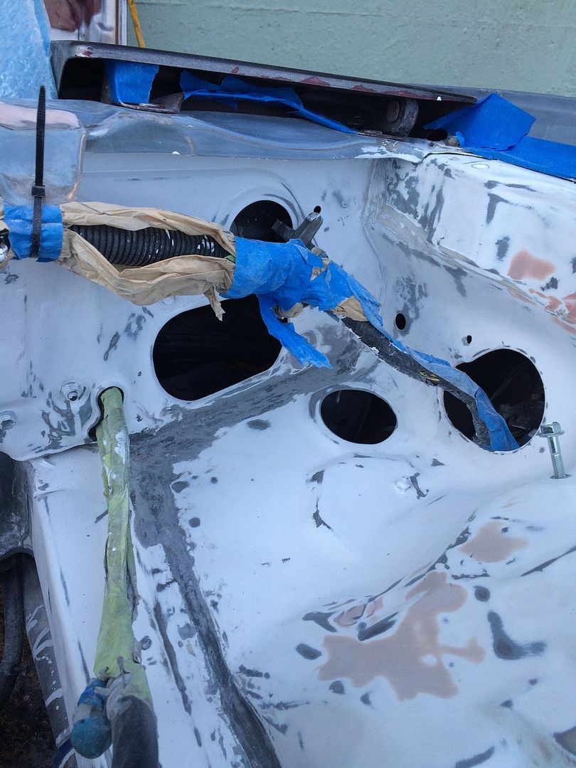

I didn't take any pictures after I sprayed the primer (I used SEM self-etching primer, good stuff!), I just had to clean up so I put the hood back on, taped everything shut, and sealed her up for the day of rain that we had (today:/) .... next step is to check it all out tomorrow on my lunch break (should be sunny!) and do a little bit of quick sanding (if necessary) then laying my second primer coat in places that need it.
I was hoping to paint the engine bay my snow white this weekend, but its looking like rain, so we may have to wait it out.

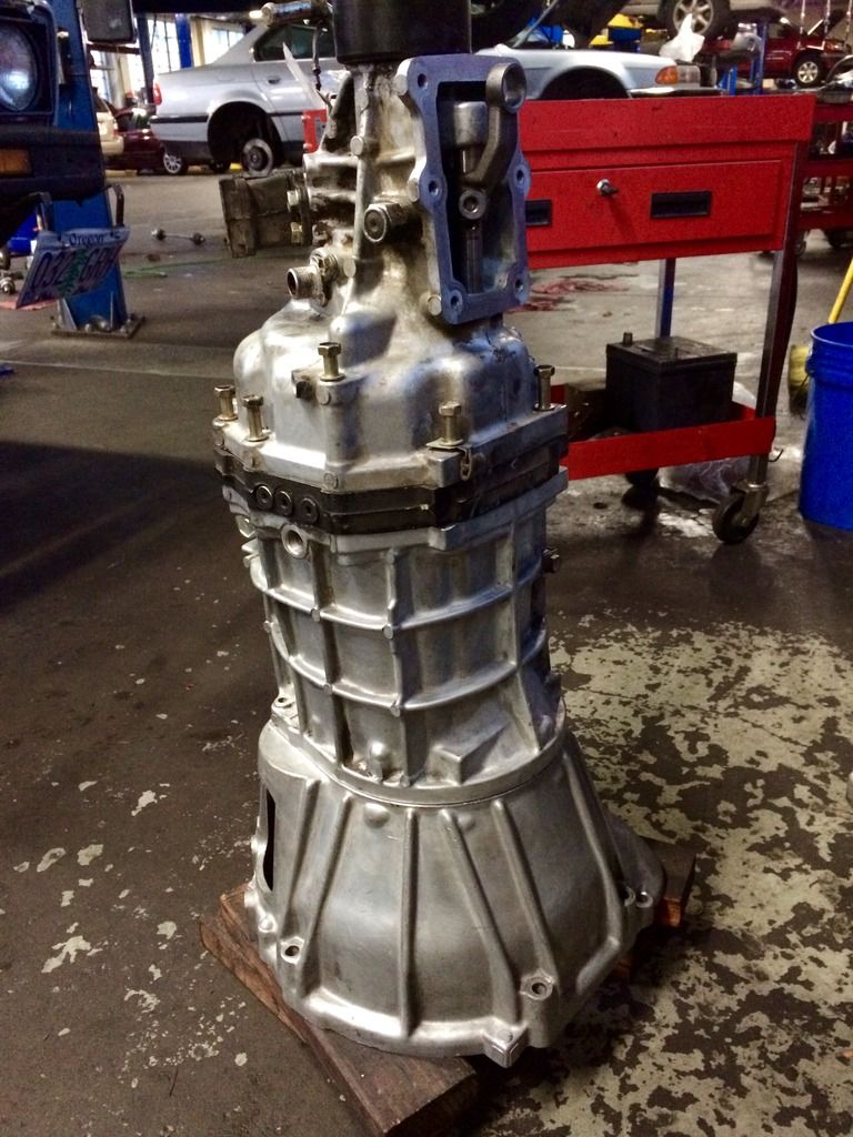

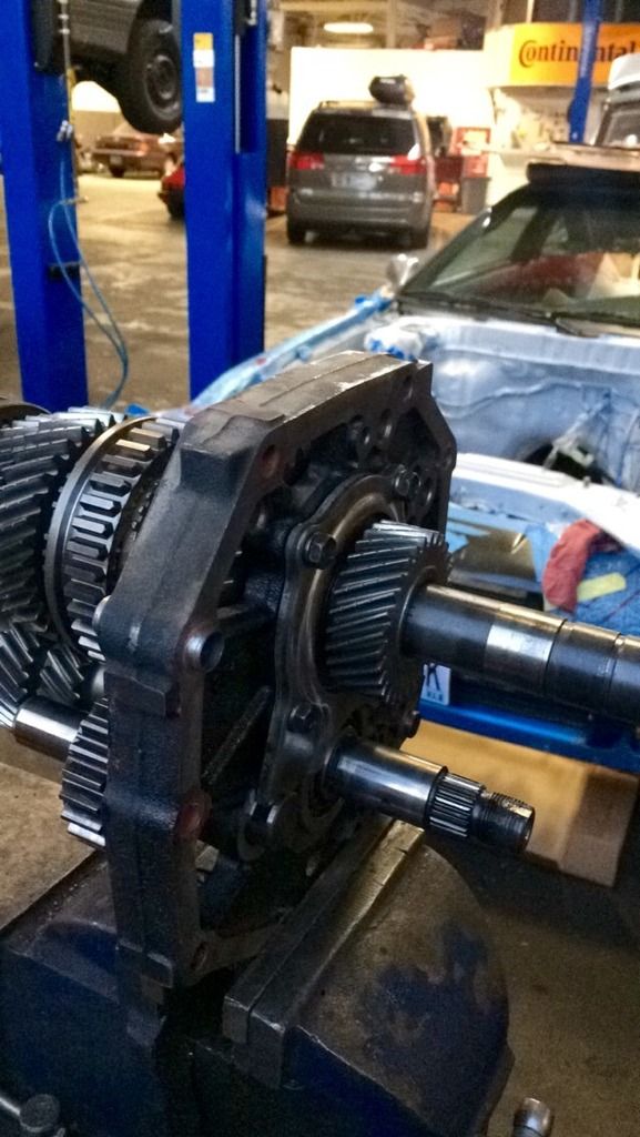

LOL okay, fair enough. Well I took the advice of my friends, you guys on here, and some followers on Instagram and I decided to take a break from painting. Seems everything I tried to paint I just failed at in every way imaginable.
So I went to something a little easier and I assembled my R154.
I took a class on transmissions back in the day, and remembered a few things, then had one of my coworkers walk me through some basics and provide aide when I fucked up, which was every now and then. Actually, I have to take it all back apart, because for some reason whenever I put the front plate on, the input shaft won't rotate, though with it off everything moves freely.... ?? Something is messed up but that's a puzzle I can handle, no magic involved. I don't know wtf is up with paint.

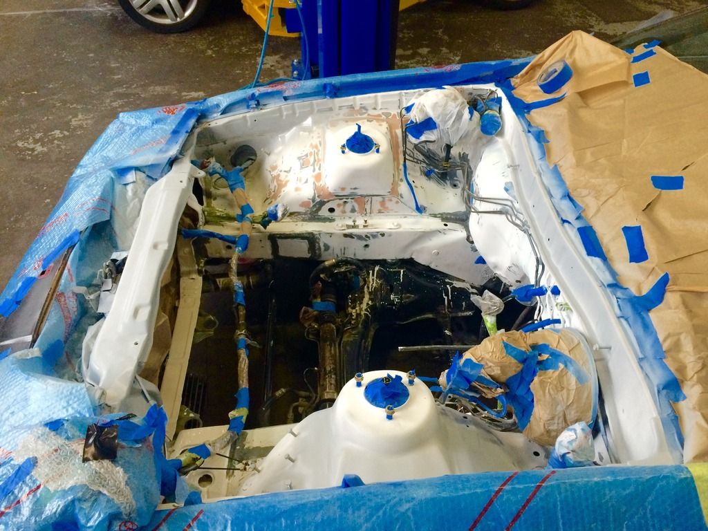

Alright, so I am weak (kind of) and I am breaking down and putting a shout out for some help. Somehow, the Universe has lined me up to keep moving forward to make it to Formula Drift at the Evergreen Speedway. I have an opportunity to have my Engine Bay professionally sprayed, so I just have to get it ready. The problem is, that it has to be done next week, (what took me over a month to do, with every second of my spare time) when the painter is going to be at my shop doing work on another non-customer car after hours. (I can't afford/don't really want to tow my car somewhere, and he is volunteering supplies, paint, and letting me put the tab on my account at work to pay off as I can). And, I am taking my ASE tests in Brakes and Steering and Suspension this weekend, so I *must* study to avoid failing the tests and owing my boss $150 or whatever.
Okay, I'll get to the point.
This Saturday, April 4th from 1pm - 5pm I am having a "sanding party" at my work, Atomic Auto on 2510 NE Sandy Blvd in Portland, OR
Anyone who shows up I will pay $10 an hour to help me get this done. You can stay and help as long as you would like. I am not sure if the shop will be open at all, but we can use the bathroom at Church bar when they open, because they are cool like that! I will provide beer and pizza! I will also supply materials. Just please let me know if you are able to join me so I know how much to get/bring/prepare/etc. Let me know what size rubber gloves you would like any. Let me know what you like on your pizza. I will also cover everyone's first drink at the awesome bar across the street that I drink at daily if you stay with me until we finish up at 5pm ;) haha. No really.
What needs to happen is:

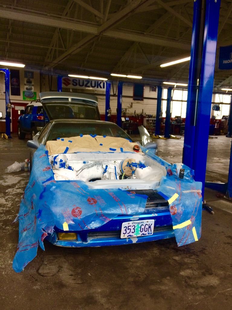

1) Remove masking. All of my old masking needs to come off. (The primer stuck to my tape, paper, and plastic, and flaked off into the drying paint.) :-/ This time, though, I am not using tape on the brake lines, I am using TIN FOIL. While the tape is off of the brake lines, I want to get all of the old white paint off of them too, or at least sanded smooth since I will be wrapping the all after she's painted.
2) Sand down drips and places where the primer flakes ruined the texture. I started painting, (of course, as you saw) and covered one side of the transmission tunnel and the top half of the passenger's side fender. If its smooth then make sure all shiny surfaces are scuffed with scotchbrite.
3) Make sure that the entire thing (or mostly where can be seen well with engine in) all gets wet sanded smooth with a finer grit (since the paint is going to be thinner going through a gun).
4) Then, everything needs to be re-masked.
Some pictures of the worst parts:
