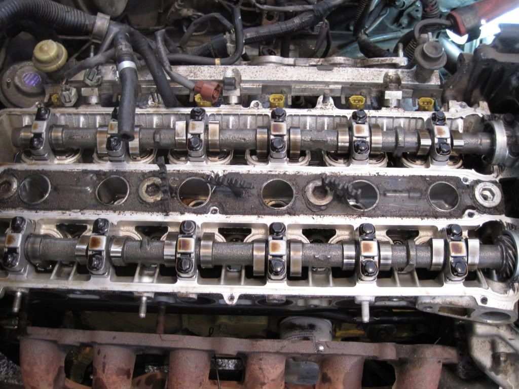

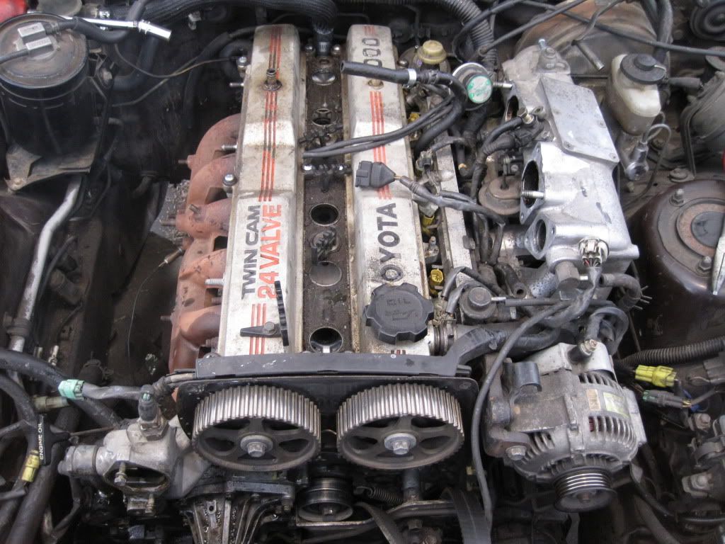

ok well i'm about an hour and a half into the work and i'm just about to remove the head bolts... just wanted to get on here to get the removal sequence..
no fucking around this time
supraduper
Jun 7, 2009
126
merrimack nh
definitely 4-5 thats blown... all others look shitty too.. had to have been the torque...
definitely a bitch to get the head out of the engine bay by myself... i must have had a friend last time...

Damn, that's a bad blow for an NA.
Hopefully you can clean it up, install a Toyota HG and reassemble.
Good luck man! :)

it was definitely a torque issue... it seemed like the bolts around that cylinder were loose when i went to remove them...
but i wouldnt be supprised if it was also made worse by a lean condition.. as the o2 sensor is known bad and i was running the car without it for a long time...
the car ran great without it... but lately i was tired of running through my gas so i plugged it back in.. and it was noticeably slower in closed loop but much better gas mileage...
ignition timing is advanced a little bit also, but i always run premium..
