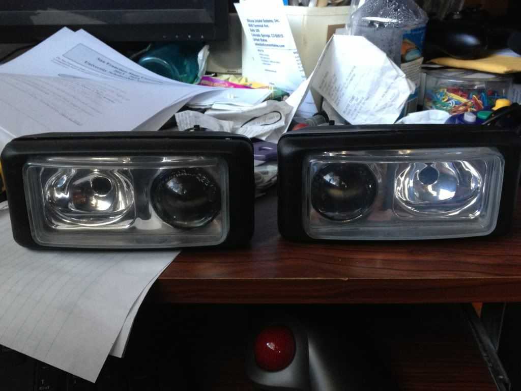

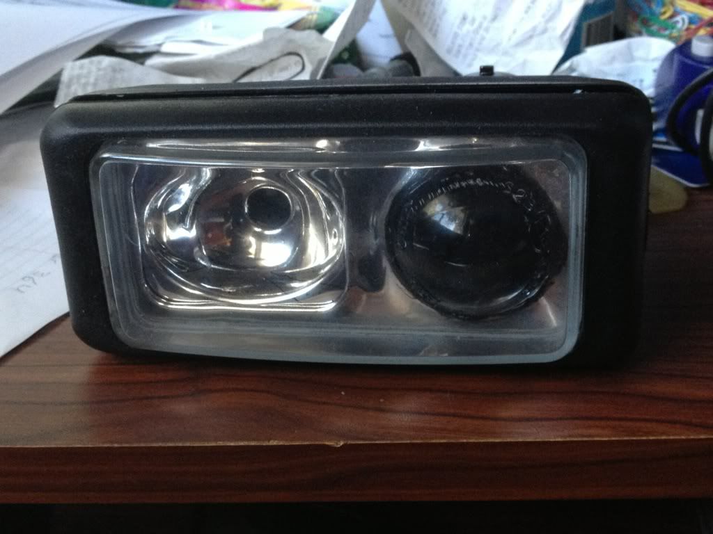

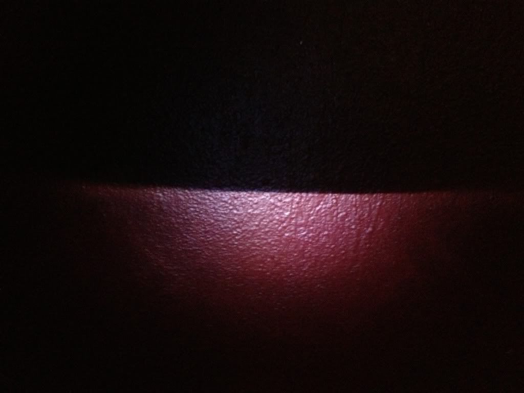

here are pics of my newer ones as promised. for the back part of the housing im thinking of making a mold to make the new piece or fiberglass the current one. the last pick is of the light cut off using a dinky LED light. Oh and excuse the mess, when im in school it tends to get that way

they are most likely foglight housings. i picked them up because they were the perfect size 3X6.5. the projectors are generic ones off ebay that i took apart

Foglights aren't going to have near the output needed...
Also, the IS250 headlight isn't bi-xenon, so you won't have a high beam...

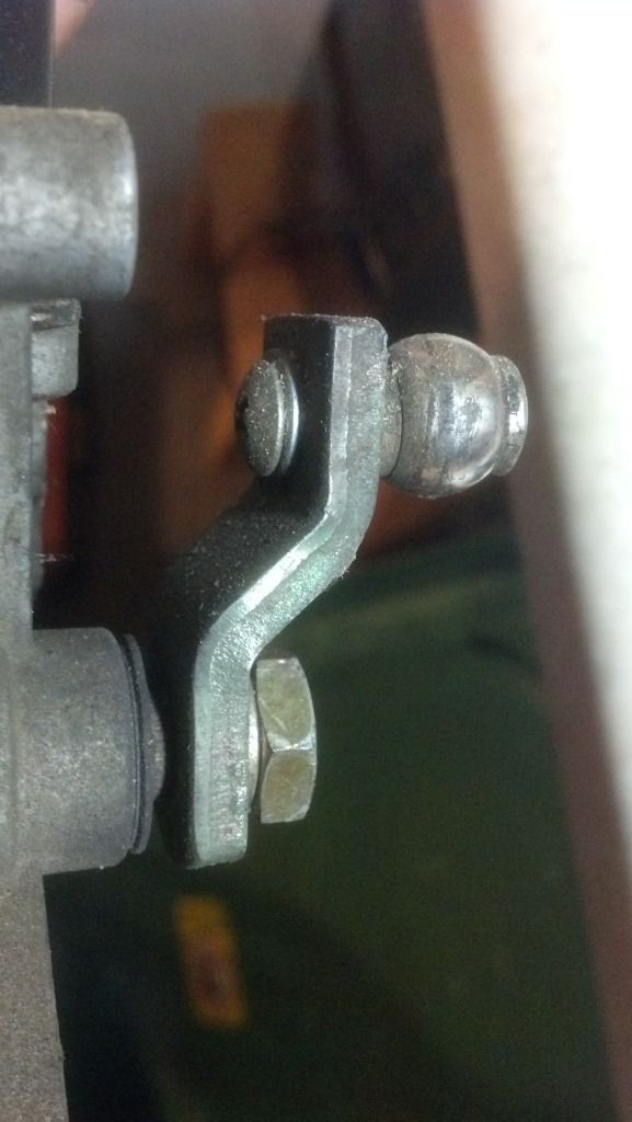

Finally got around to getting a pic of my mod to the pivot arms.
You can see where I cut the arm about 3/4 of an inch shorter, and relacated the ball, by knocking it out(press fit), drilling the same size hole, and drilling/tapping the backside of the ball for a small screw.
In retrospect, it's not necessary to actually cut the extra length off, as it wouldn't interfere with movement, and that way, you could instantly reverse the mod by simply unscrewing the pivot ball and relocating it back.
