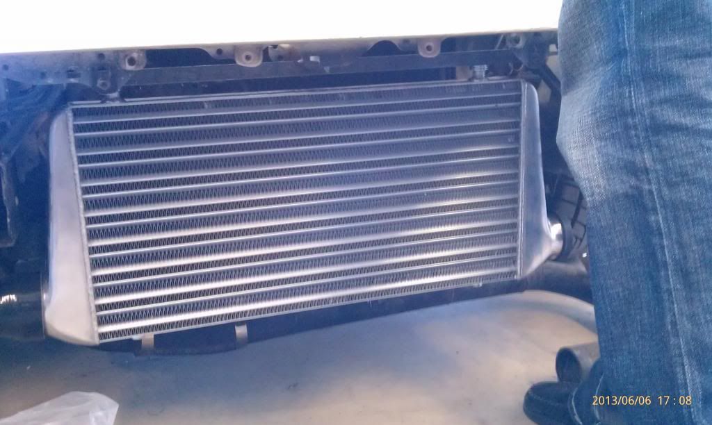

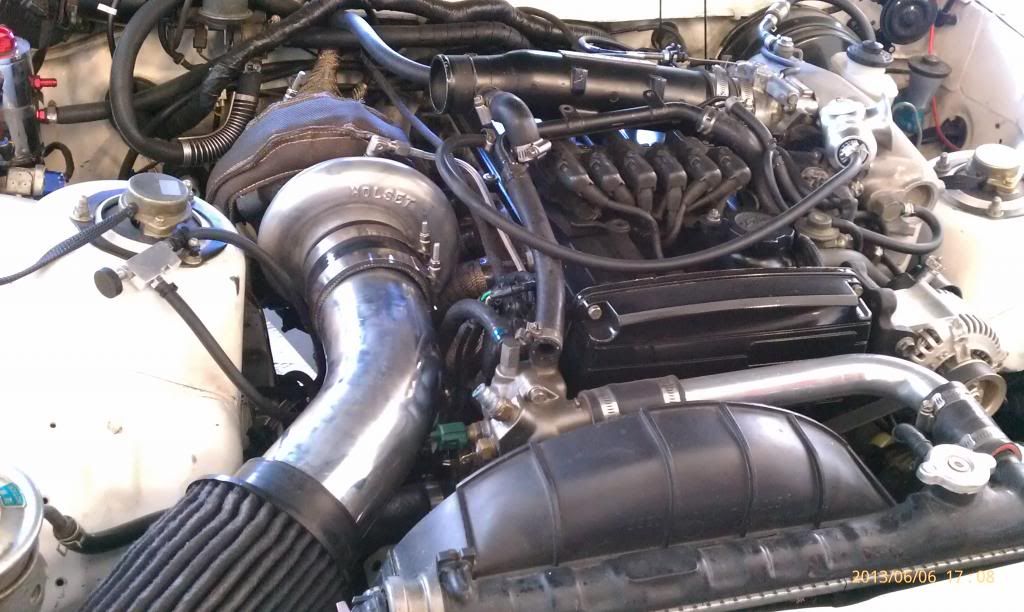

Aaaaand in for the third time. This time ready for some good power
Should be running tomorrow
Sent from my PC36100 using Tapatalk 2

Yep, turbo is working great and pulls hard at 15 lbs! That is if I could keep the intercooler lines from popping off haha
I ordered some t bolt clamps so I can keep them together then it'll get dynod
I'll have to see what full spool actually is when I get the new t bolt clamps

The housing was machined out for the bigger wheel and gas a 3.5" v band downpipe. The turbo itself is 3" exhaust

Got the tune checked with the new intercooler, took a little fuel out at wot. Pulls hard at 16psi.
Taking it to Tue dyno hopefully Tuesday or Thursday
