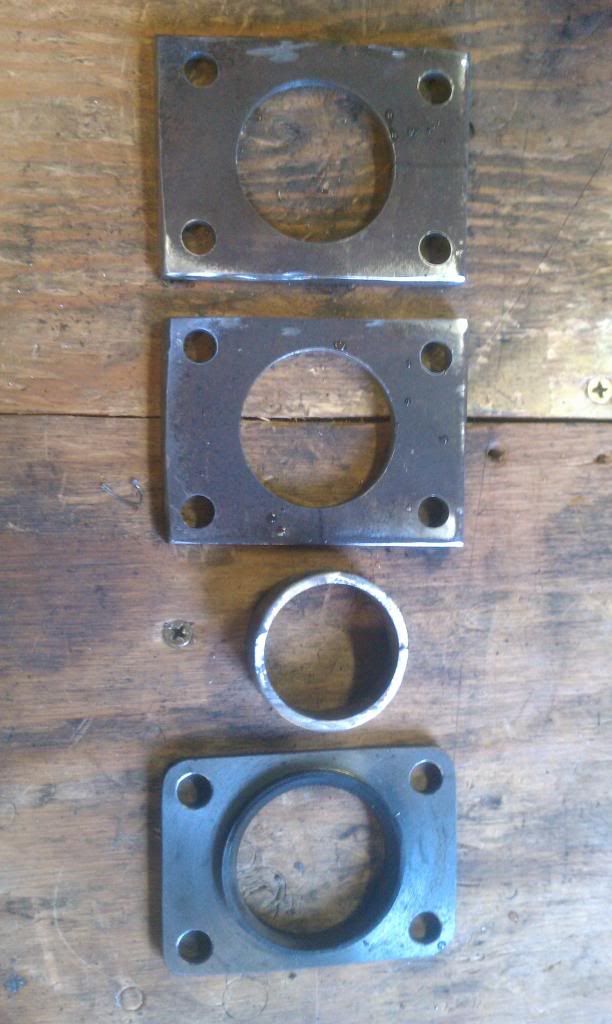

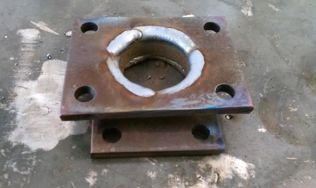

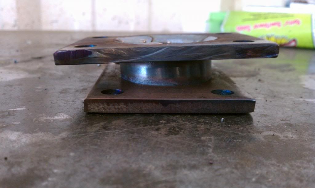

made an adapter to rotate the wastegate 90* so it doesnt dump out toward the oil pan and i can fit a dump tube in there
slightly angled

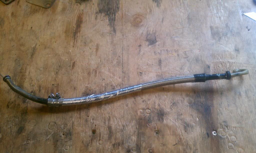

also made a custom dipstick tube with some high temp braided hose to clear the new header
