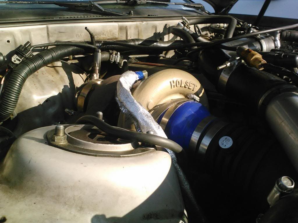

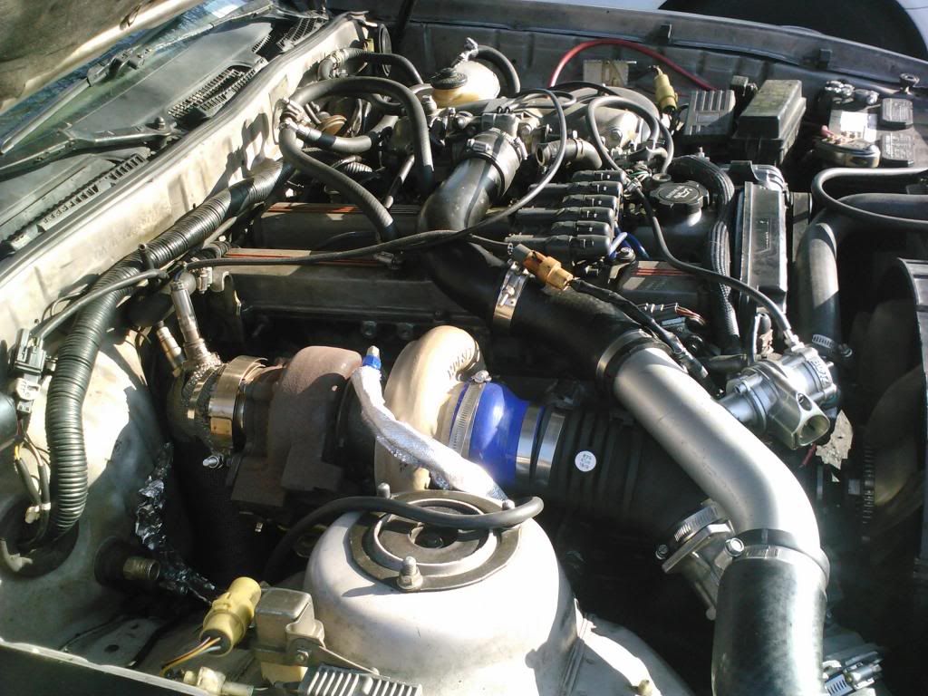

Several hours + goop off + rerouting a few wires, you get this.
not the best, but definitely cleaned up the engine bay a lot!
still waiting on my downpipe flange do get made, then i can take it to the exhaust shop, then tuned

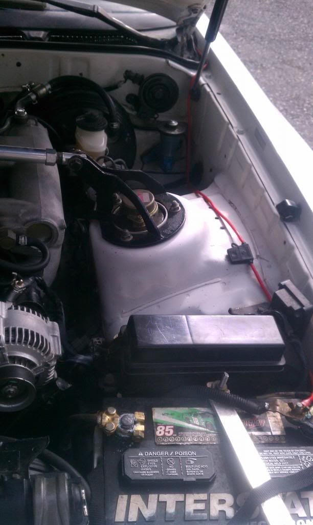

Your red wire is bugging me.
Run it through the hold next to the battery and under the fender and follow the body harness and run it through the boot of the body harness.
Also stick the relay behind the fender as well on the pass side.
Looks great tho.
Looks great tho.
thanks
yeah that red wire has been bugging me since day one when i went to look at the car before i bought it
good idea on the relay, i didnt think of putting it there

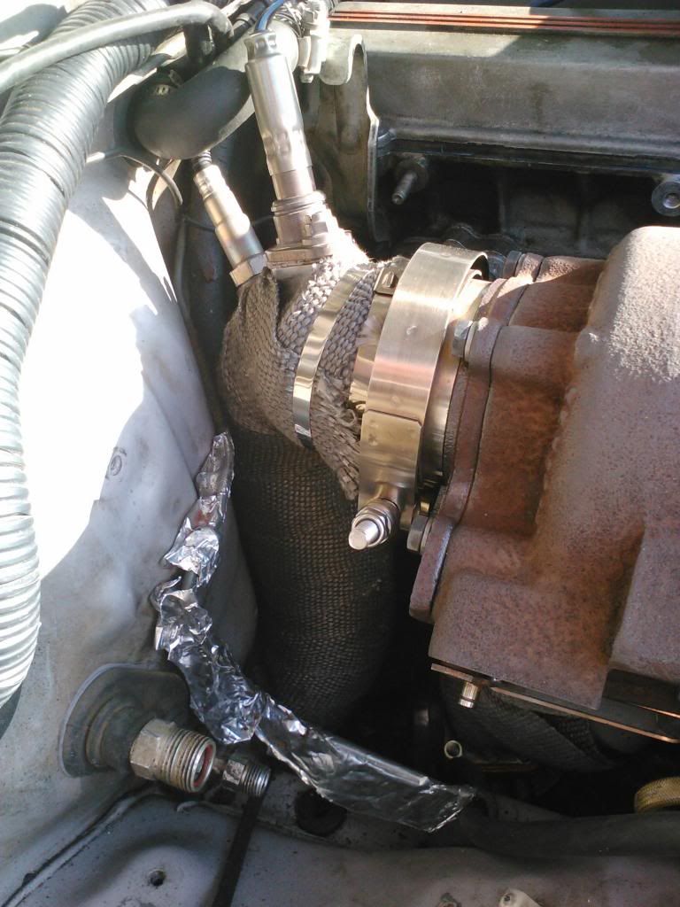

ill try and get a sound clip here soon
bad news earlier, turbo will need a rebuild. i was taking a chance with a used turbo off a diesel with 100k miles anyway, smokes quite a bit.
wastegate needs rotated 90* from how it is now. the dump tube only has a couple inches and hits the oil pan :(
