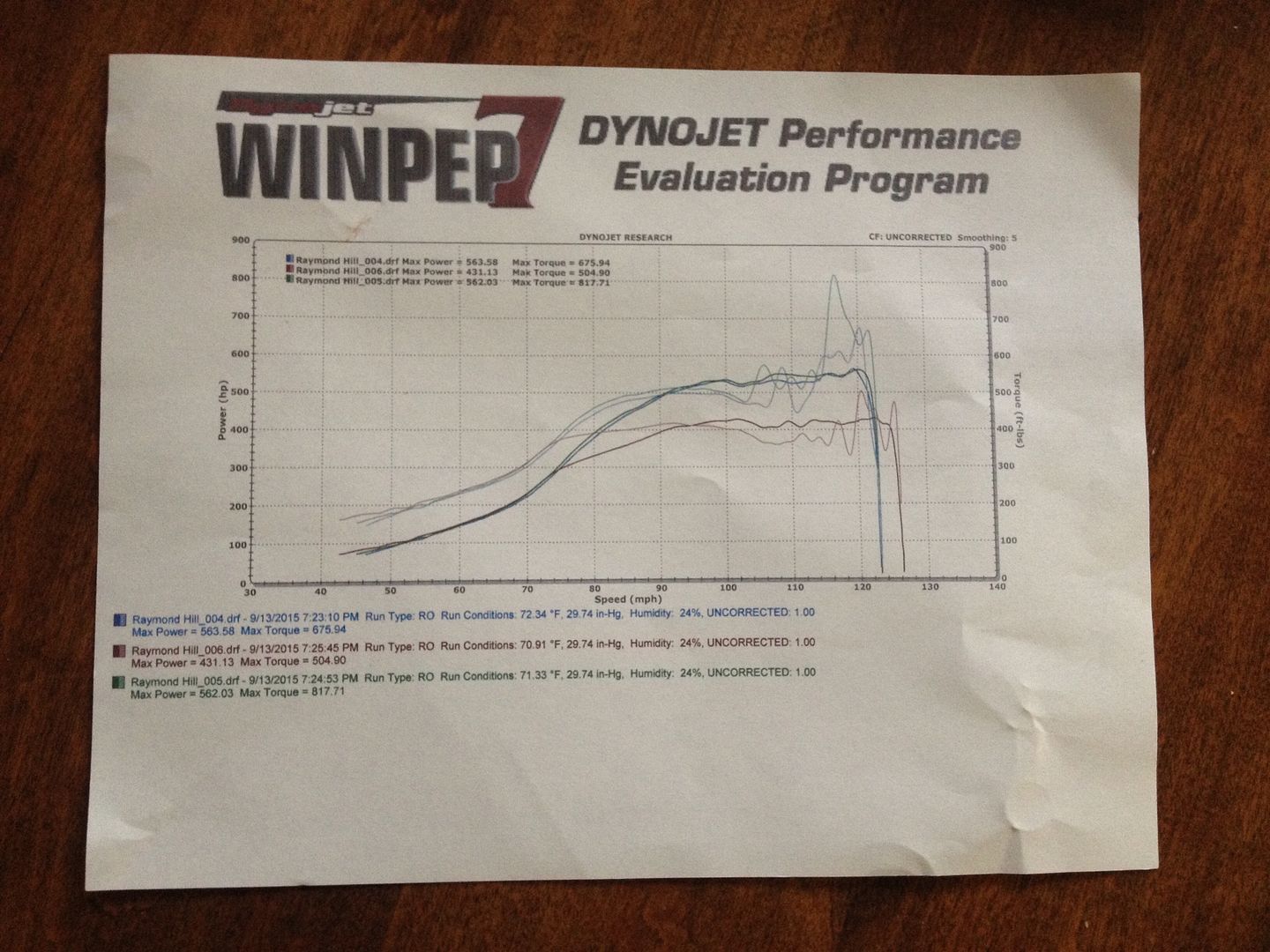

So that 563 run was on an s363 with the 83 housing at around 26psi? I'm also having very high duty cycle on my boost controller so I'll have to get a stiffer spring. It currently has a 10psi spring in now. May try a 15 since I don't plan on running anything lower.
Again, I'm doing all the tuning and boost control setup myself, so there may be some error on my part and most definitely isnt the best tune but it is safe with conservative timing and on the richer side.

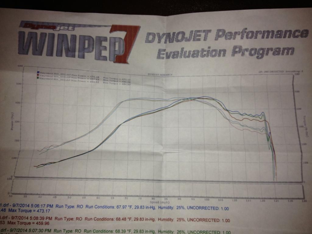

the 563 run was on 20-22psi and would trap 123-124 never dynod on the higher boost but went 130-131mph so im sure it was in the 600's. i think with it holding 30psi it should trap 135+
im currently running 1 bar springs so like 15psi was thinking of going to 18psi since that is what i run on pump most the time. this is the graph on my hx35 when i was running waaaaay past the exhaust housing limits. just straight falls on its face. a larger exhaust housing would have helped there a good amount i'm sure.
