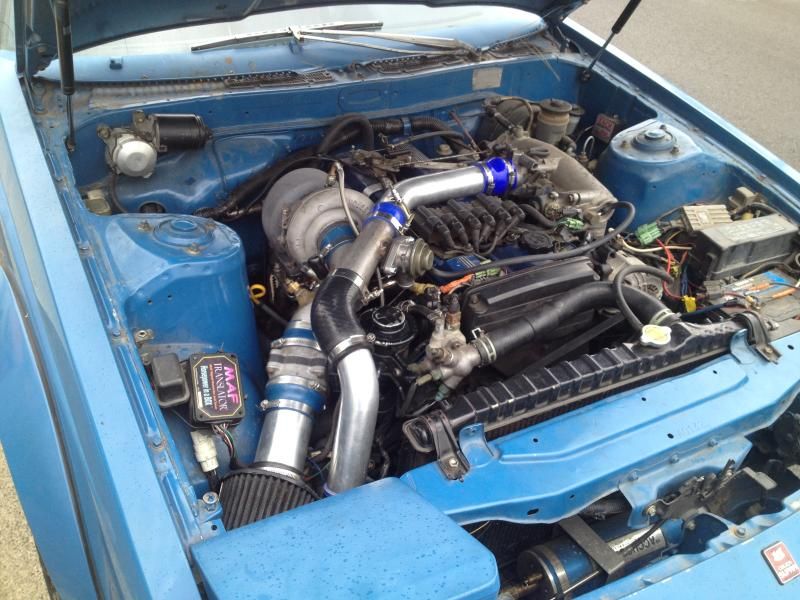

Thanks guys! I actually opted for this turbo size by the way it spooled on your car I watched on YouTube. I opted for the slightly smaller exhaust housing though (.83 divided)
Only reason I switched to the jz distributor was my 7m cps went bad on the dyno. Instead of taking a chance again with having yet another cps fail, the guys over at Portland speed industries suggested that I upgrade.
The only difference is the wheel is bigger which makes for a more reliable and clean signal I guess you could say.
It is rather big which is its only downfall. Sometime in the future I'd like to go to a hall sensor on the cam/crank for a cleaner look. This setup works great for now though! Now if the dang snow will clear out of the area I could take it for a spin

Had someone ask if I was still running the factory fuel damper on the rail, I still am. Heard of some issues with high flow fuel pumps and no dampers so I decided to keep mine. Just welded a 6an fitting on the end of the factory banjo
Hate to cover up the nice aem cam gears and belt, but I'd rather not have anything work it's way down inside! So on goes the cover. I cut it in half for easy installation and removal

Today was such a nice day, took the soup out for a drive and did some tuning.
Running 18psi of boost and only 11 degrees timing, she pulls hard! Although the 83a/r exhaust housing choked up top in higher gears, I'm impressed...
I will end up switching out to the 91 or 1.0 rear housing eventually
