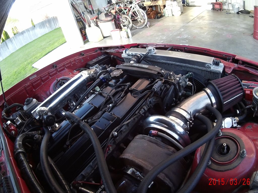

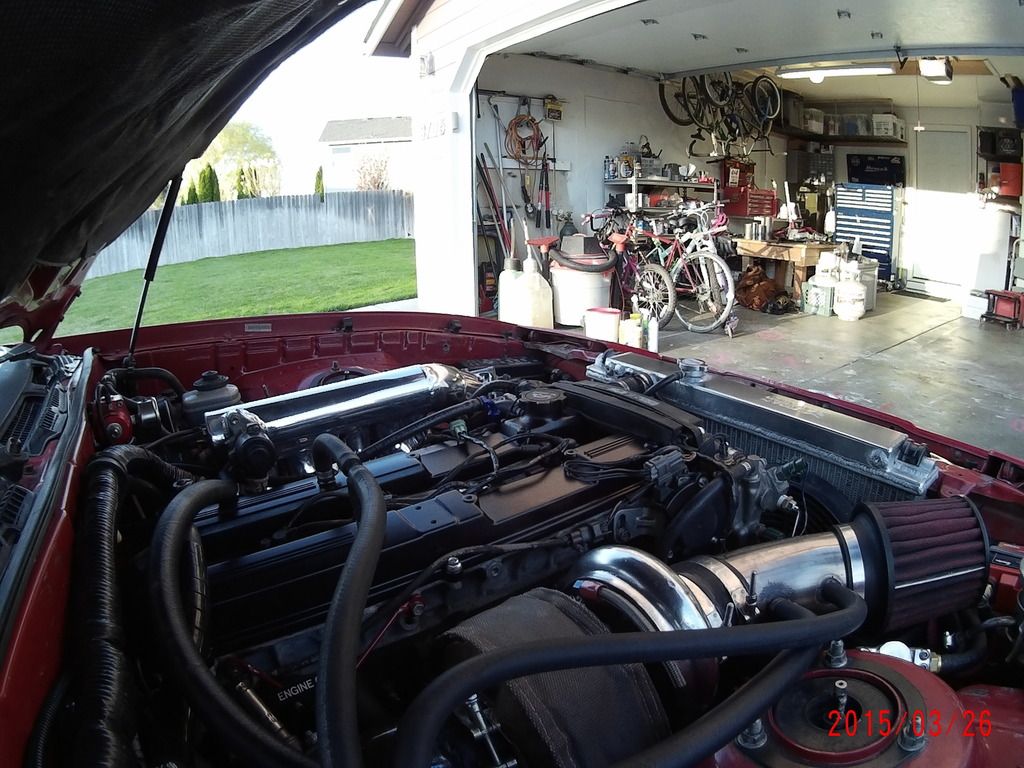

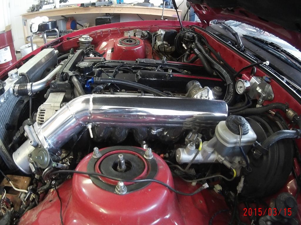

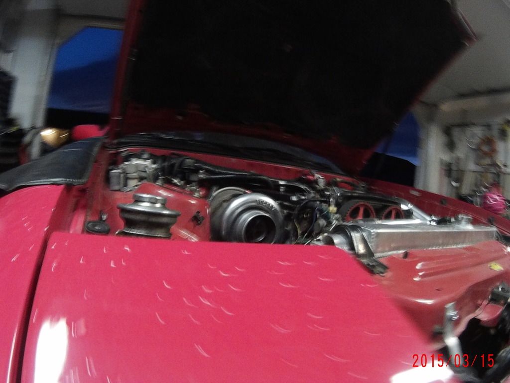

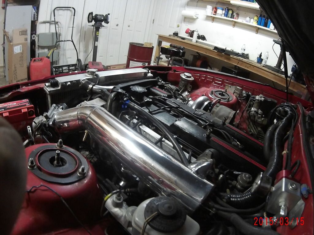

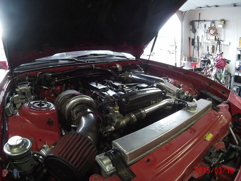

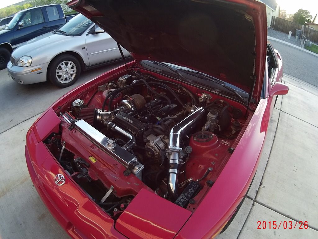

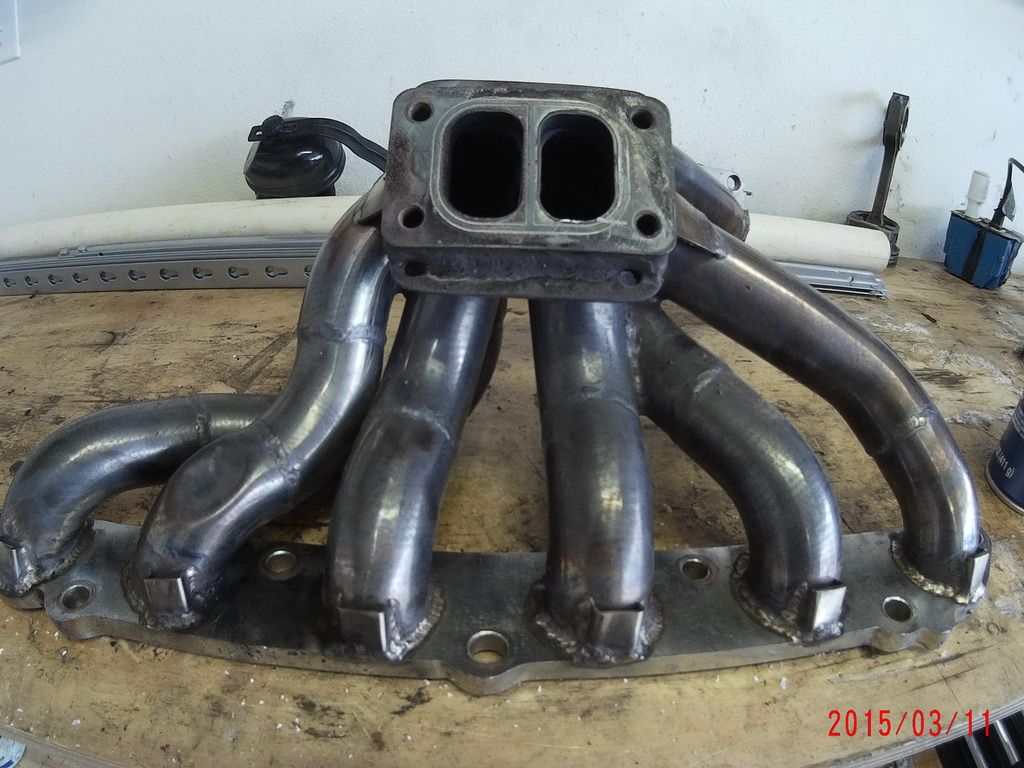

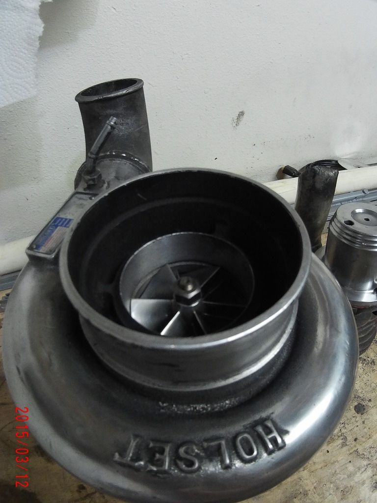

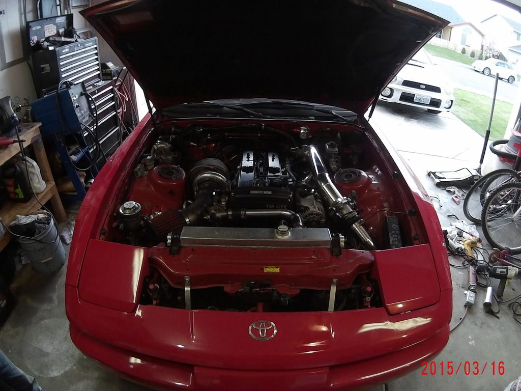

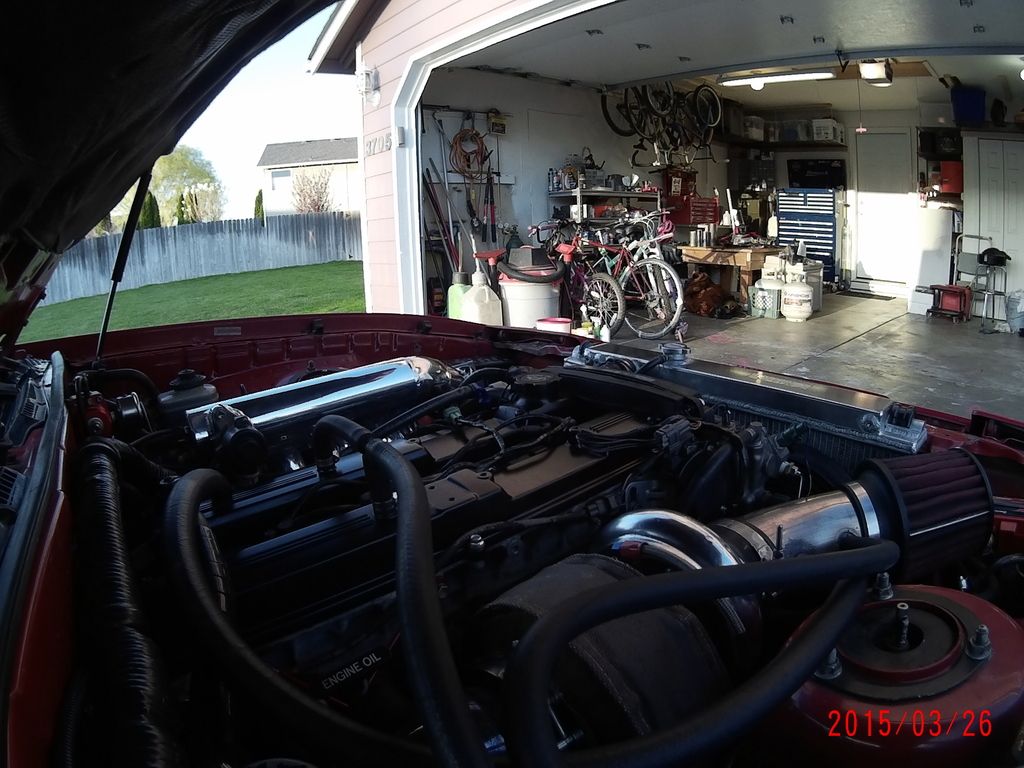

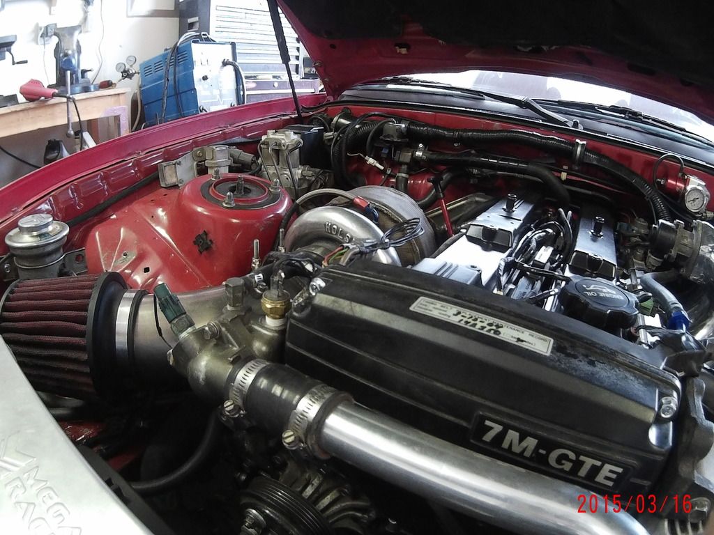

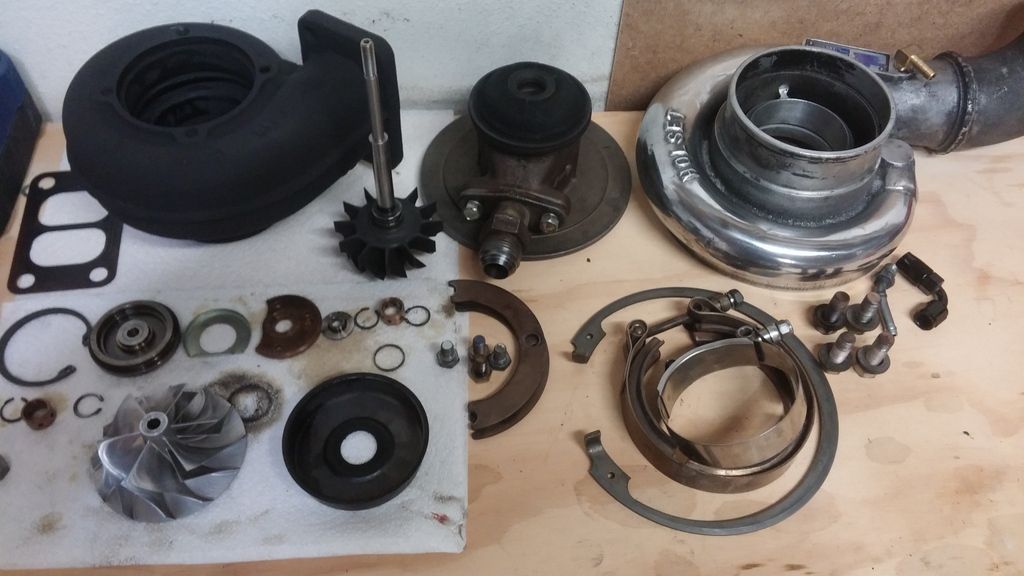

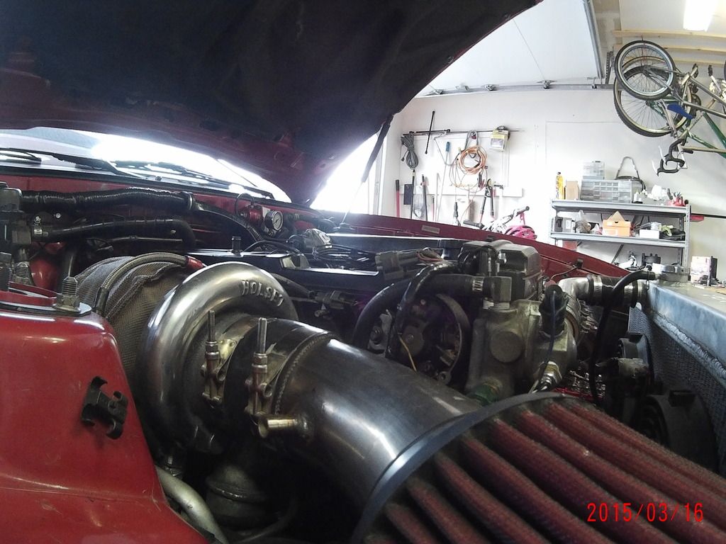

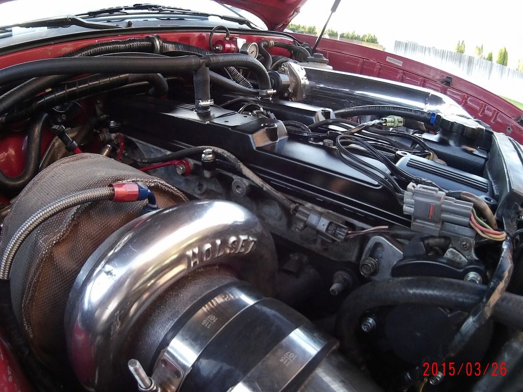

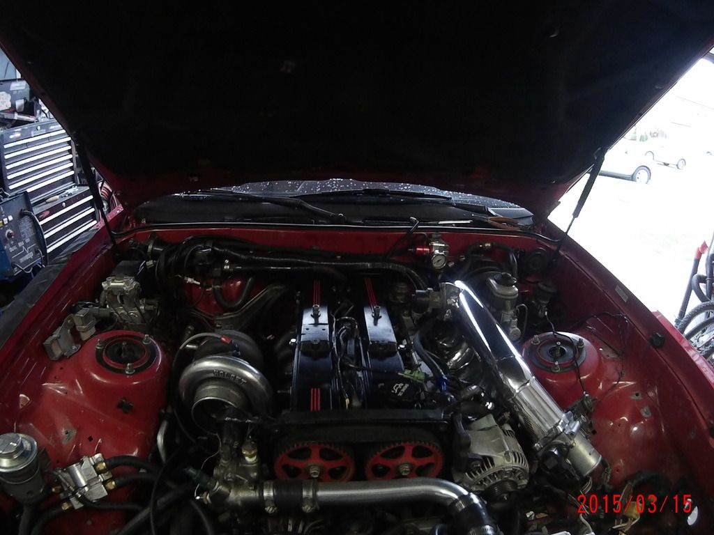

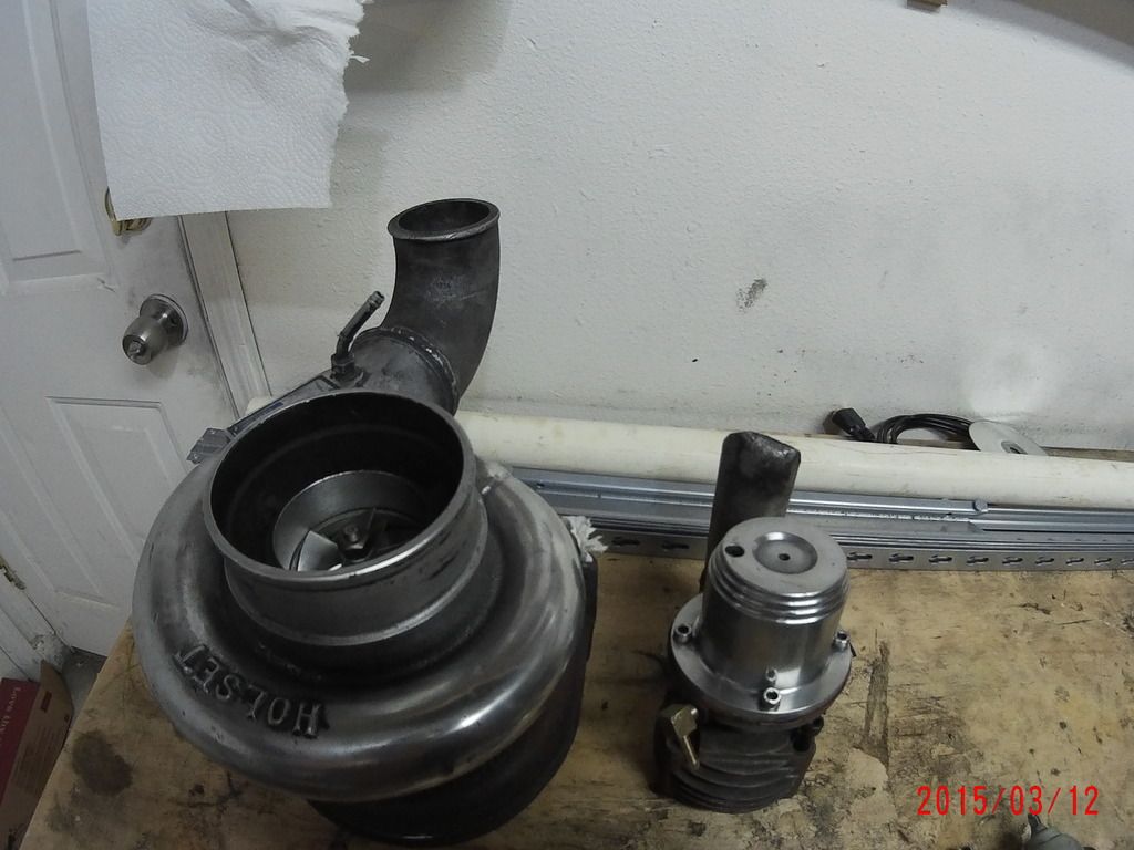

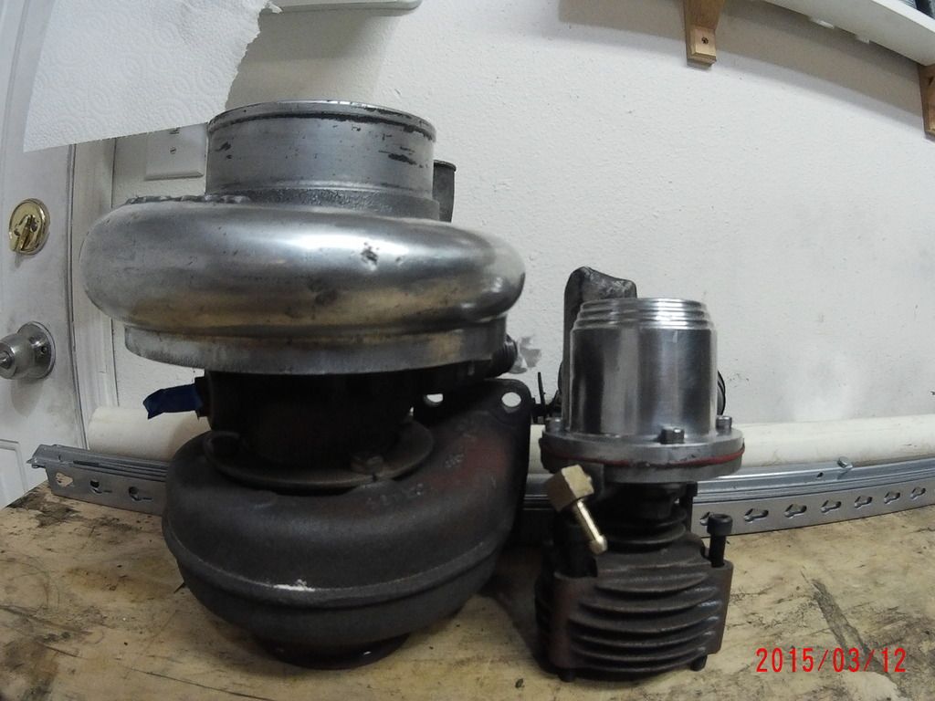

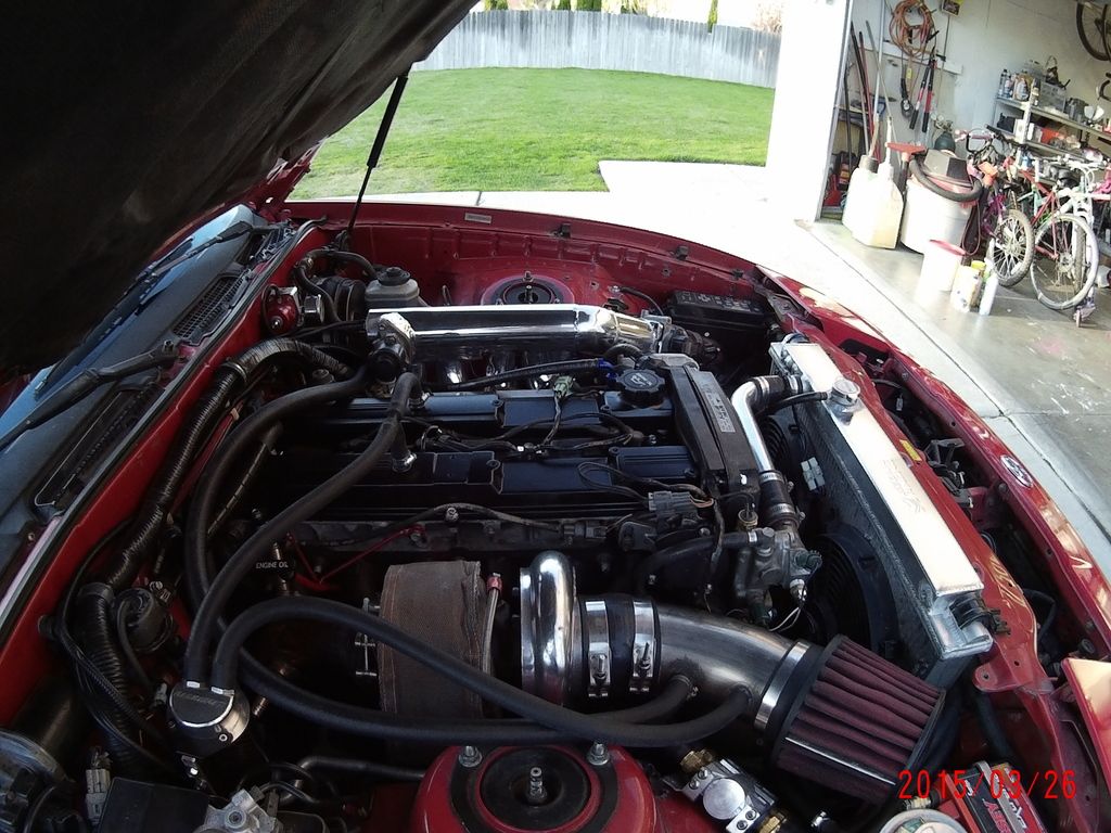

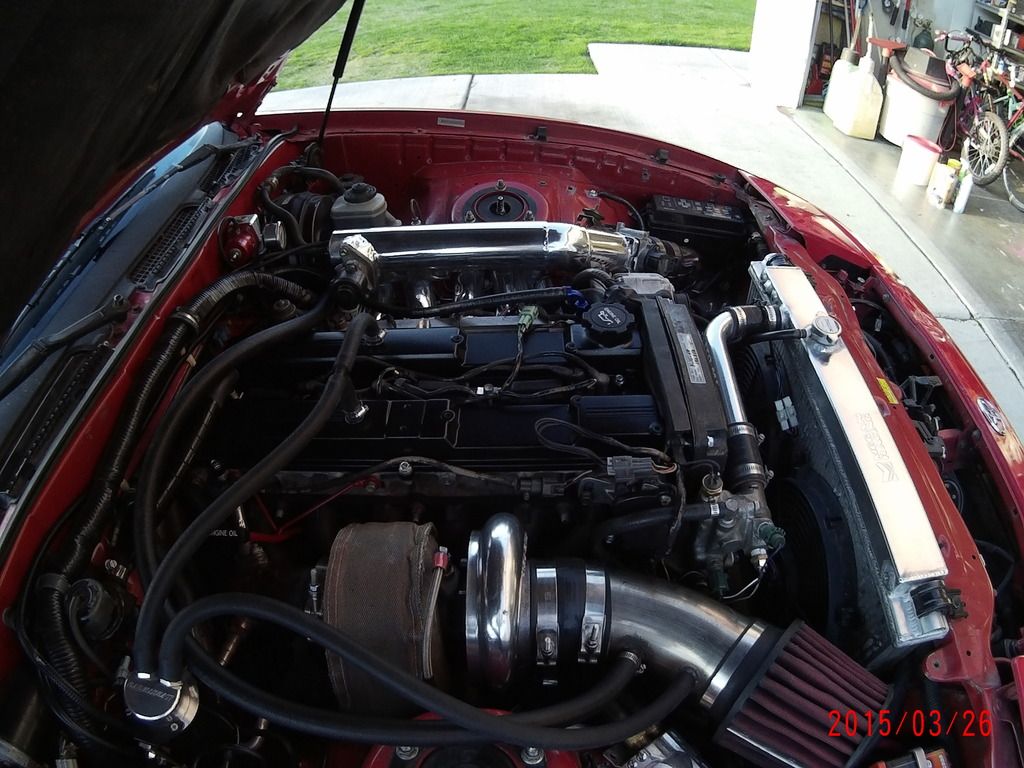

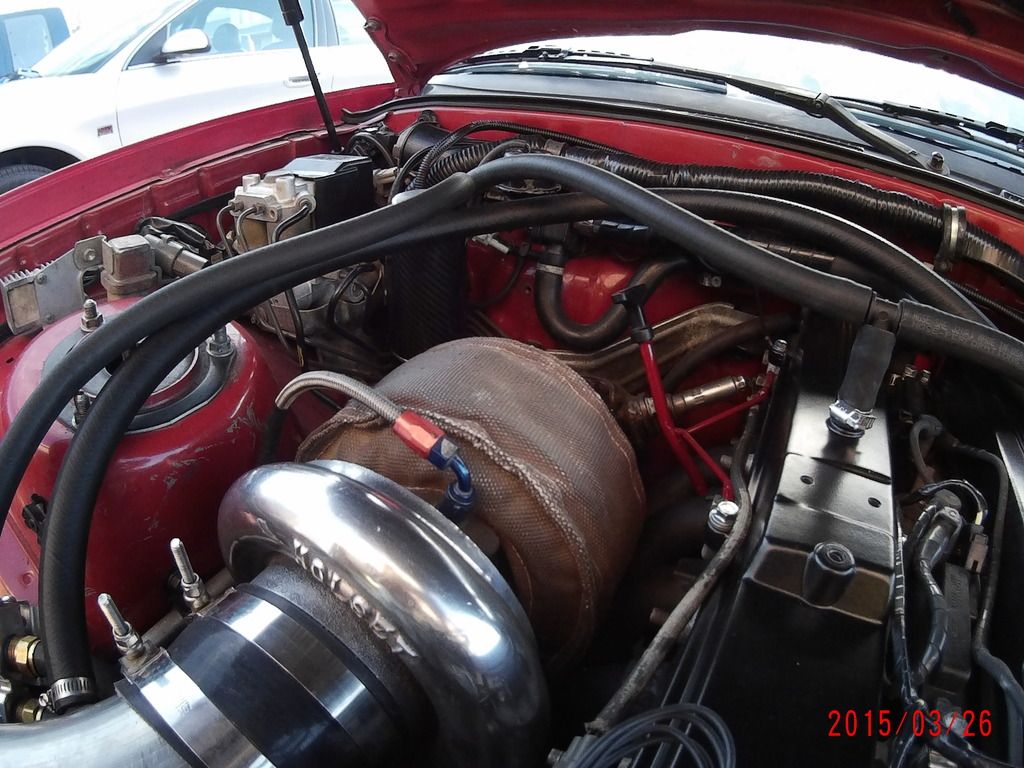

my header apparently had a small pinhole leak that i must have missed before i installed it. had to pull the turbo/header to weld it up, will be getting the turbo exhaust housing as well as the header ceramic coated. i dont like wraping the header, takes too much time and makes a mess once the fiberglass breaks down..

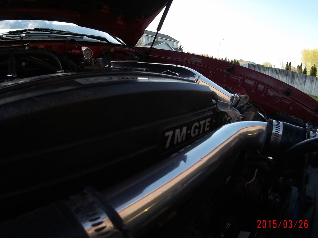

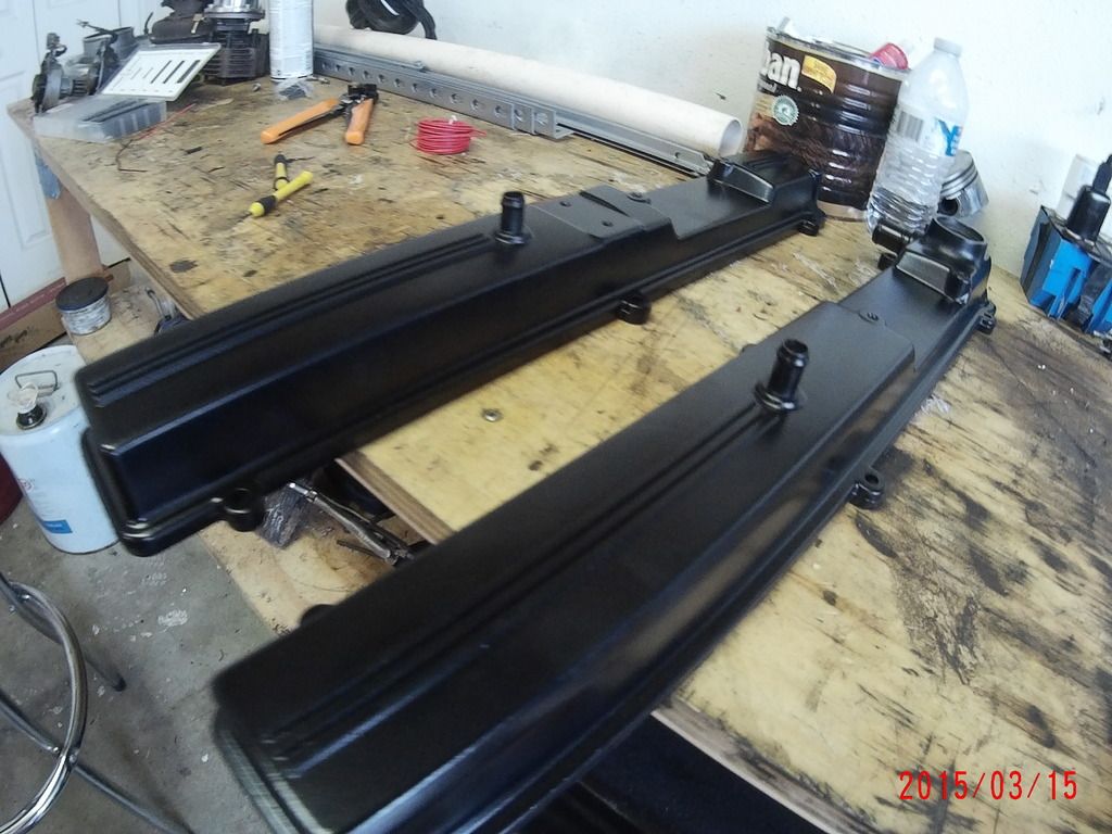

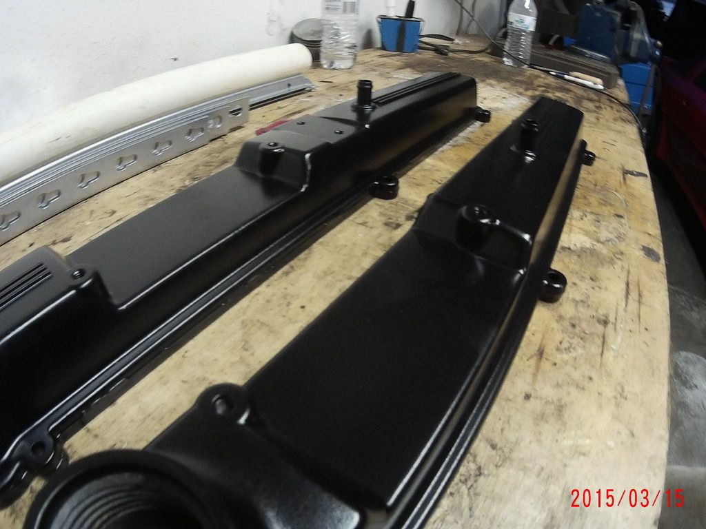

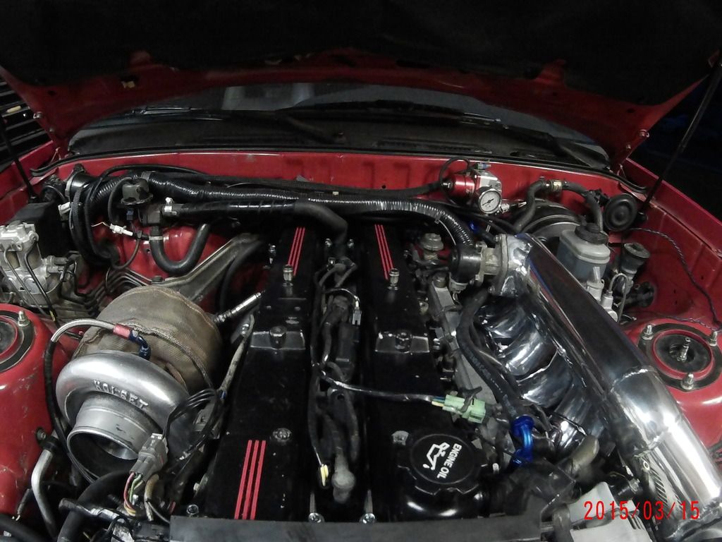

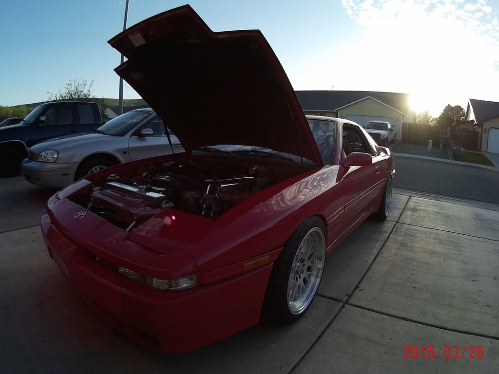

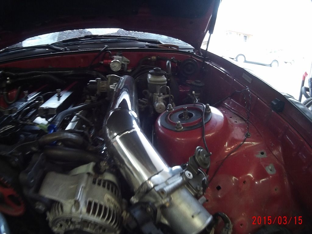

went ahead and pulled my valve covers too and resealed them. they had a slight leak. painted the ribs 3e5 red too to match. i think they turned out alright
i think i might get my spare set powdercoated red with the ribs polished. i cant decide though

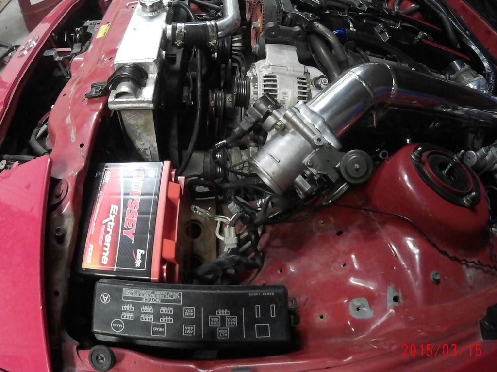

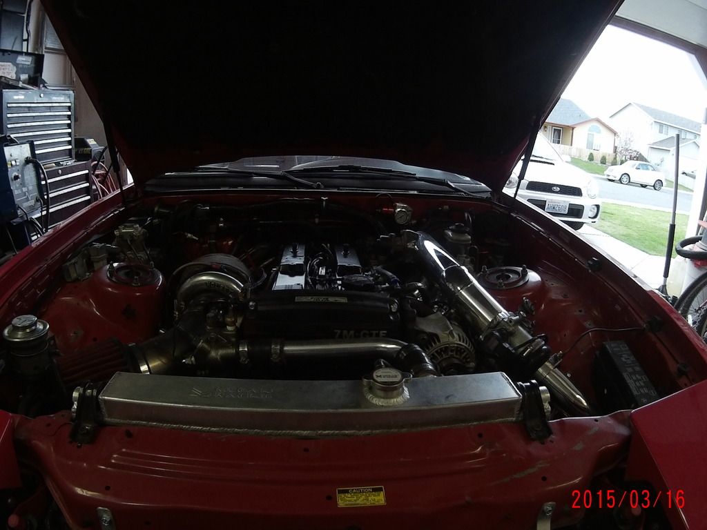

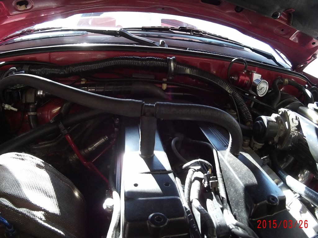

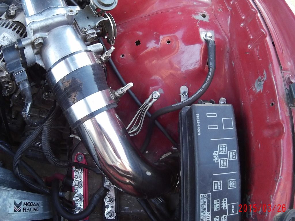

ended up going with some is300 coils too! just have to mount them, makes sure the wires are going to the right plugs, and extend my harness. not bad for 45$ total. went ahead and installed some 10mm head flanged bolts for the valve covers..way better than stock thats for sure!
