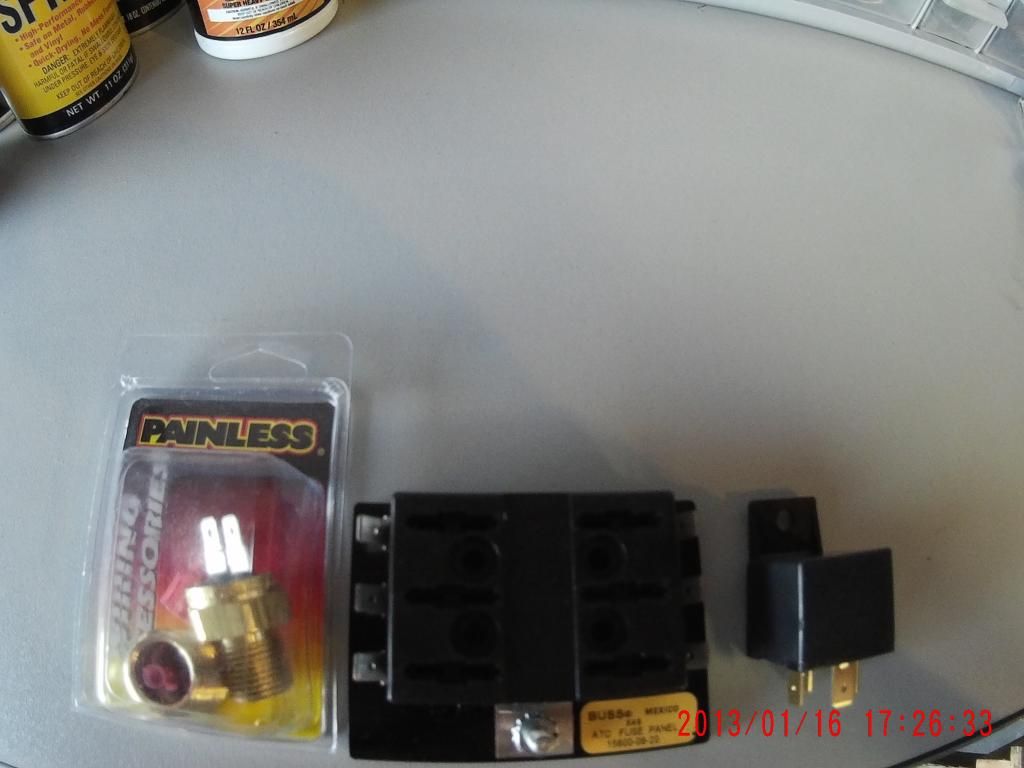

my electric fans were previously wired to stay on all the time when the key was on.. so i junked that setup and did it right with a thermostat, relay, and fuse block.
now that fans actually turn on and off when they are suppose to!

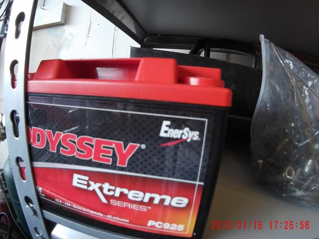

greddy type RS Bov and boost controller hopefullying going in soon along with a small odyssey battery to accommodate my custom FFIM!
should be done in a week or so, i cant wait! allows me to keep the ac and alternator in the factory location i just need to relocate the battery.

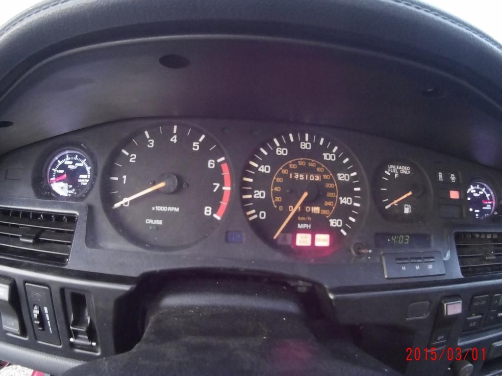

since ill be running the ffim i ditched the cruise control. new oil pressure,water temp gauge came in. still waiting on my 2 pod lotec pillar mount.
decided im going to run my oil press and water temp gauges in the gauge cluster, wideband and boost in the pod, then my EGT right in the center where my weideband currently is

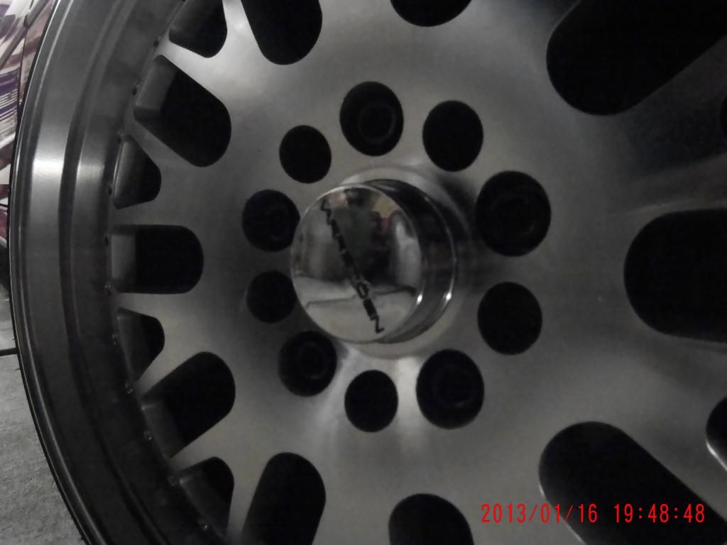

Wheels are 18x9.5 +12 and 18x10.5 +22. Fenders are rolled with a slight pull in the fronts

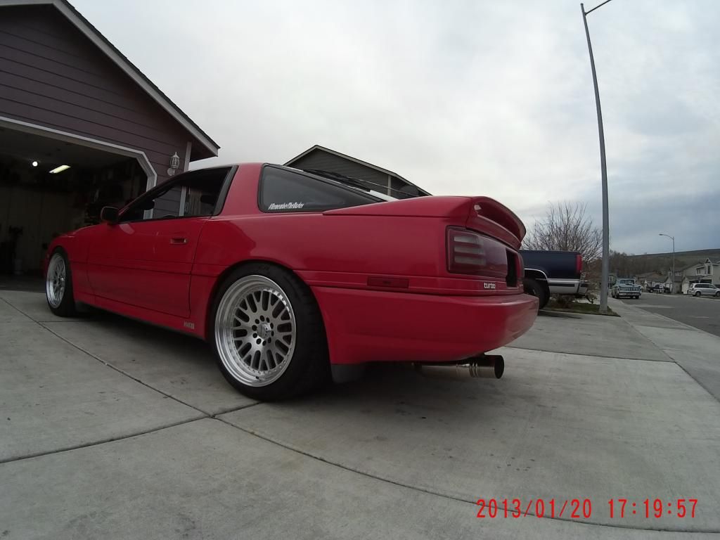

got some things done today while the weather was nice

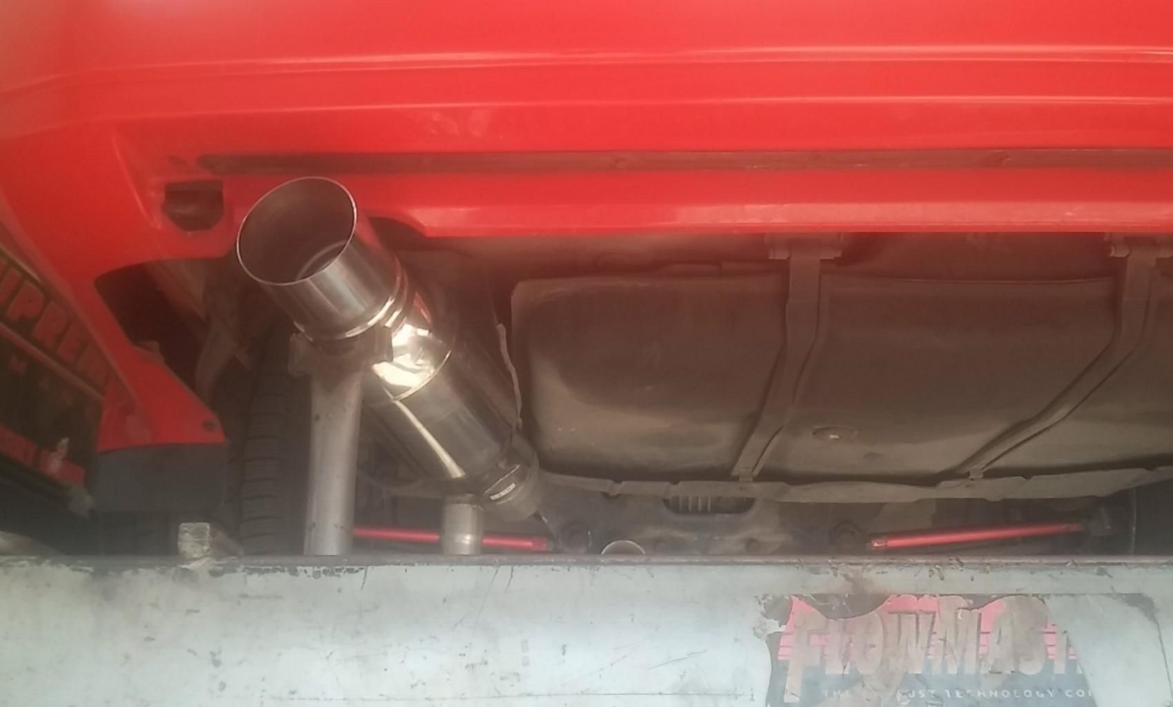

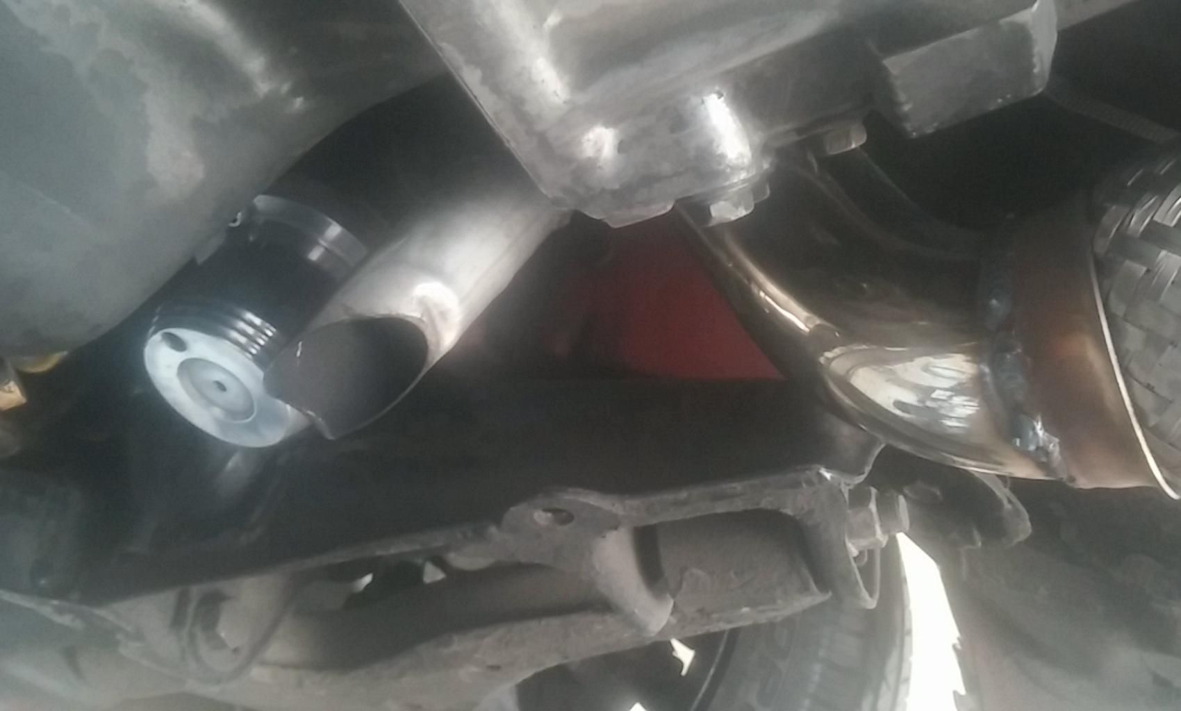

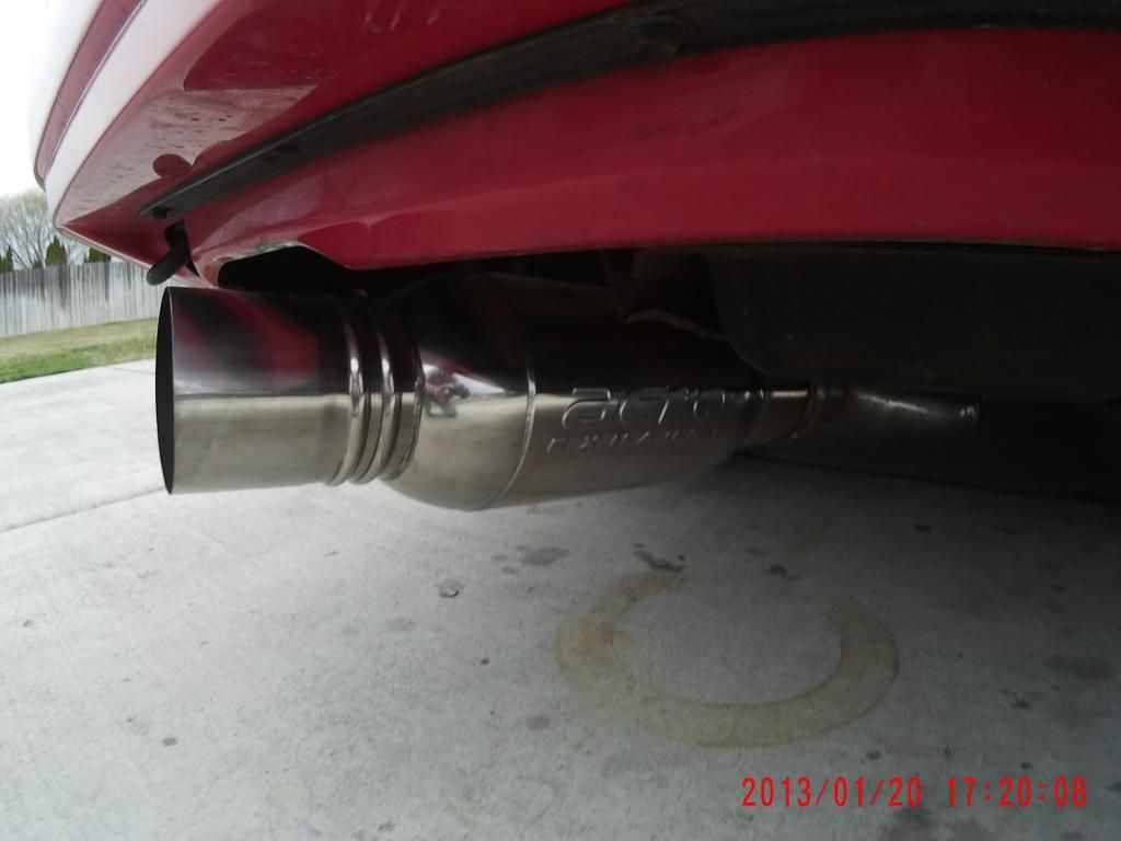

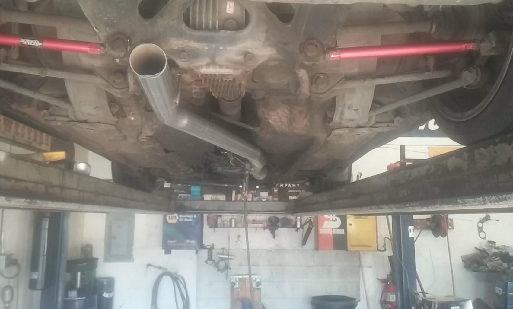

went to the exhaust shop and had some 3" piping bent and welded for my exhaust along with a 4" muffler. for how big it is, its a pretty deep tone and quieter than my hks hi-power muffler. i can also hear the turbo whistle a lot better through it!
bought some stainless 2.5" IC piping so i can make my own piping when the custom FFIM comes in the mail.. the guy told me it was just about ready and just needed polished.

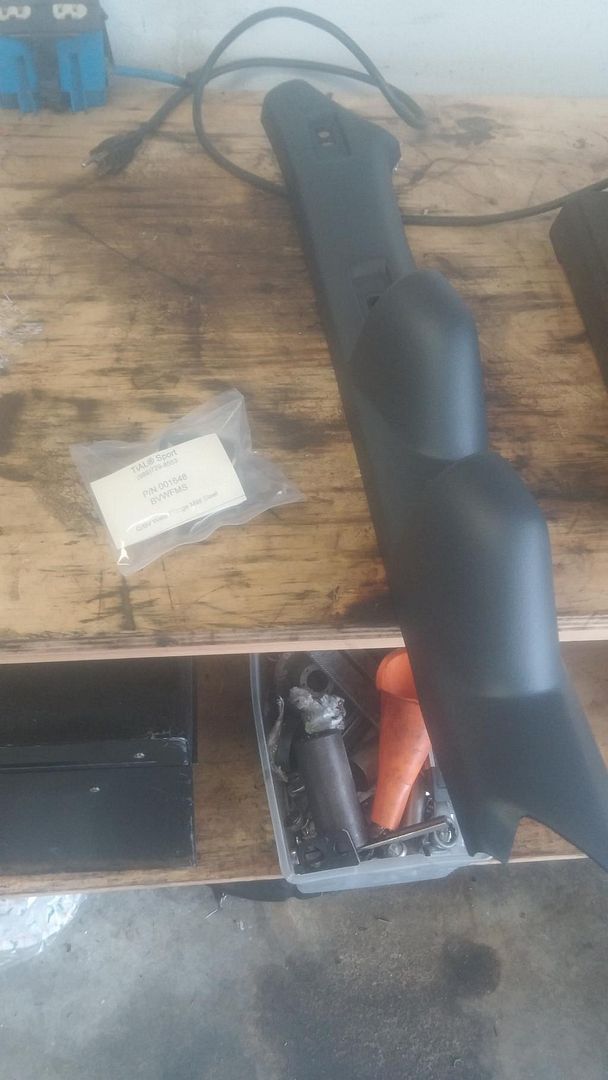

supra sport was actually pretty fast at shipping the 2 pod pillar to me. i just got an email today that driftmotion just sent out my CPS cover today.. both were ordered at the same time. hopefully its just becaust aaron was out of stock at the time

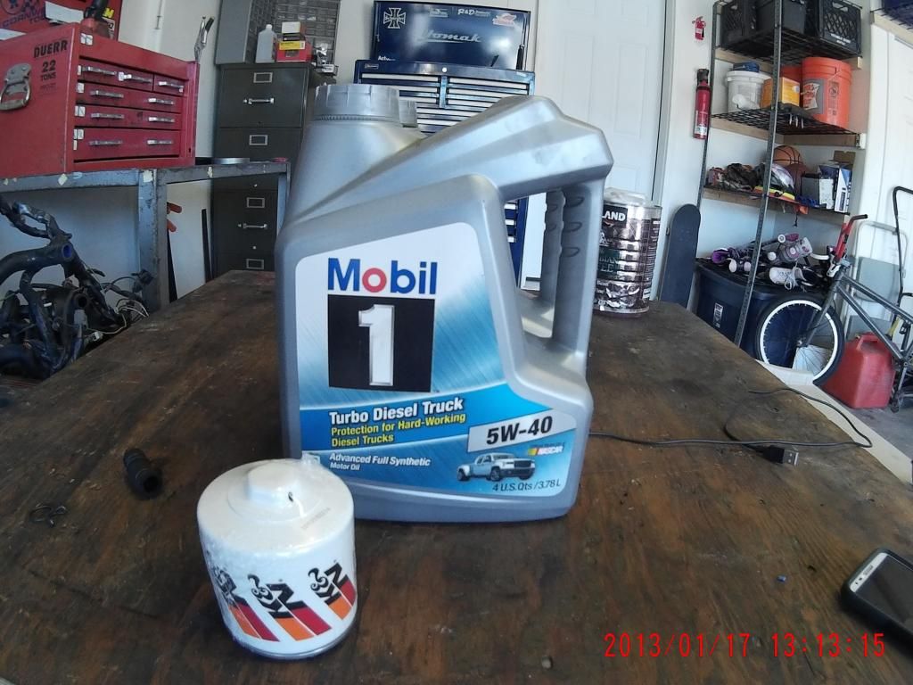

oil is changed using Mobil 1 Full syntheic Turbo Diesel Truck Oil 5w-40 with a k&n filter.

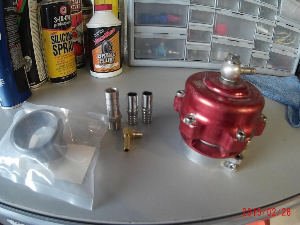

i also scored a lightly used tial 50mm BOV for 125$...couldnt pass that up!
anyway heres some pictures

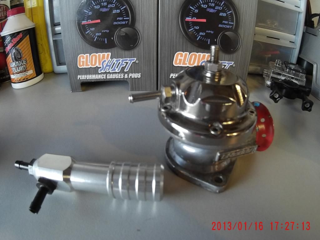

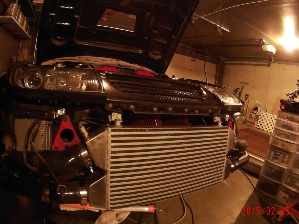

more parts! scored a 50mm TIAL Bov on the facebook page for 125..cant wait to weld it all up along with the new IC piping when the FFIM comes.
just got word that it will be shipped out Wednesday to me! Cant wait!

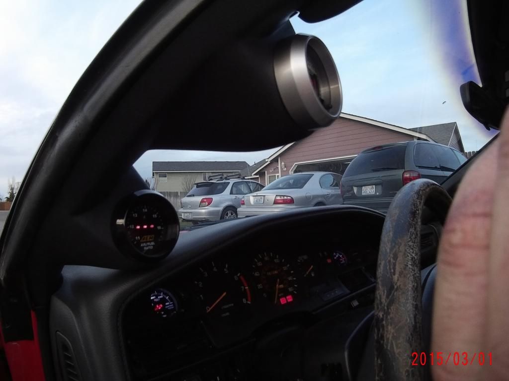

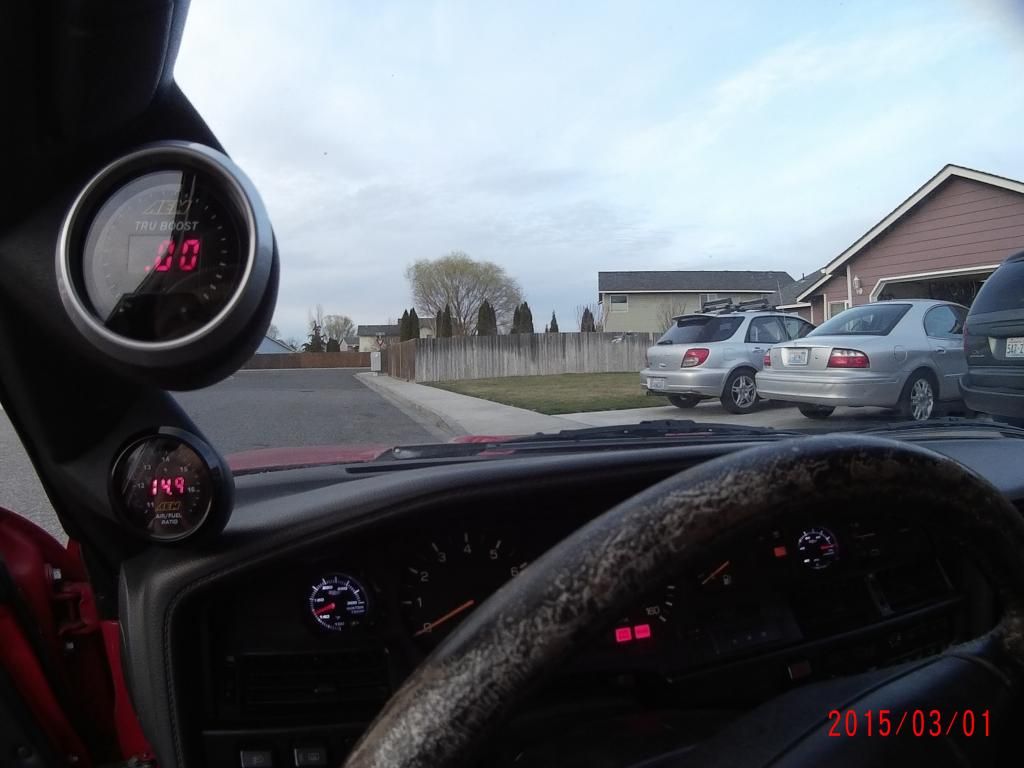

new water temp and oil pressure gauges are installed in a NA cluster so I can run a volt meter. i put my AFR and Boost gauges in the pillar pod,
and will be adding my egt gauge on the steering column or in place of the cigarette lighter spot. i havent decided yet.

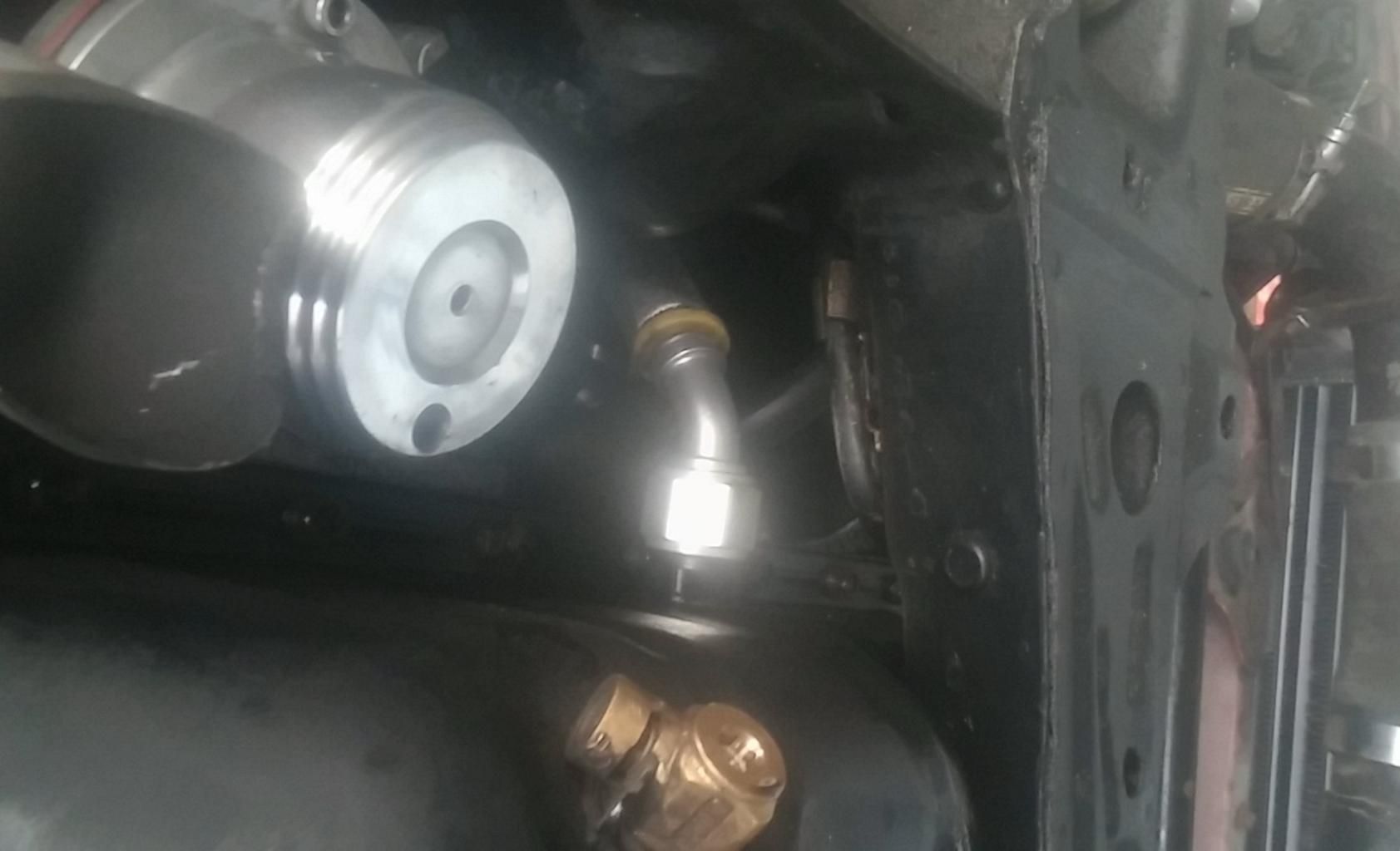

I was surprised at how well the paint matched my factory color. Not bad but I guess it wasn't very cheap either.

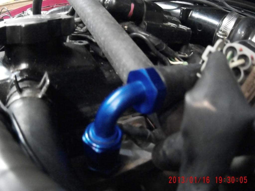

I'm thinking about recirculating my wastegate but I love the open dump pipe too! Yep that's for my turbo drain, it's - 12 high temp hose with heat tape wrapped all around it. Haven't had any problems yet and drains way better than that - 10
