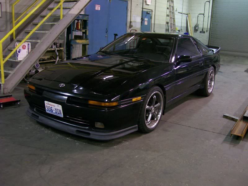

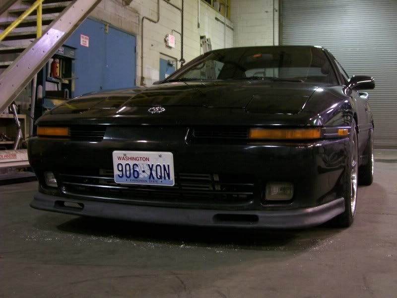

Alright guys time for some updates!
Here are some new pictures of the of the supra with the new lip I installed this weekend, the whale tail, and my 18's!
It will also soon be getting some other upgrades in the form of one of my new CNCed manifolds, long runner fully custom exhaust manifold, GT35 size turbo, and a new exhaust system. All of my current setup is for sale.
Thanks for looking,
Seth

Nice! Lookin' good buddy!:bigthumb: Those rims definately look better on your black car than they ever did on mine!:icon_razz
