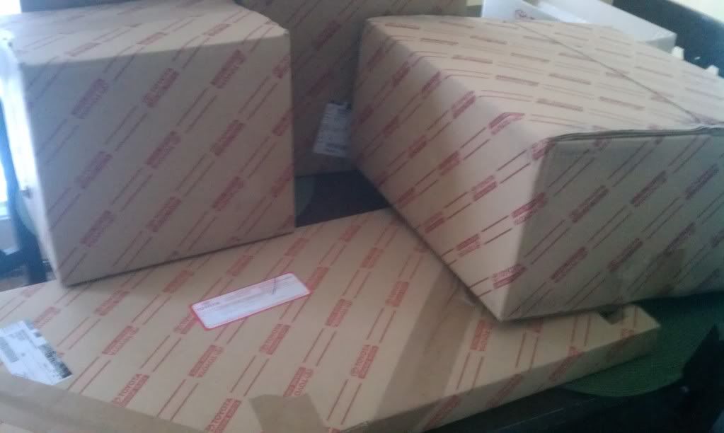

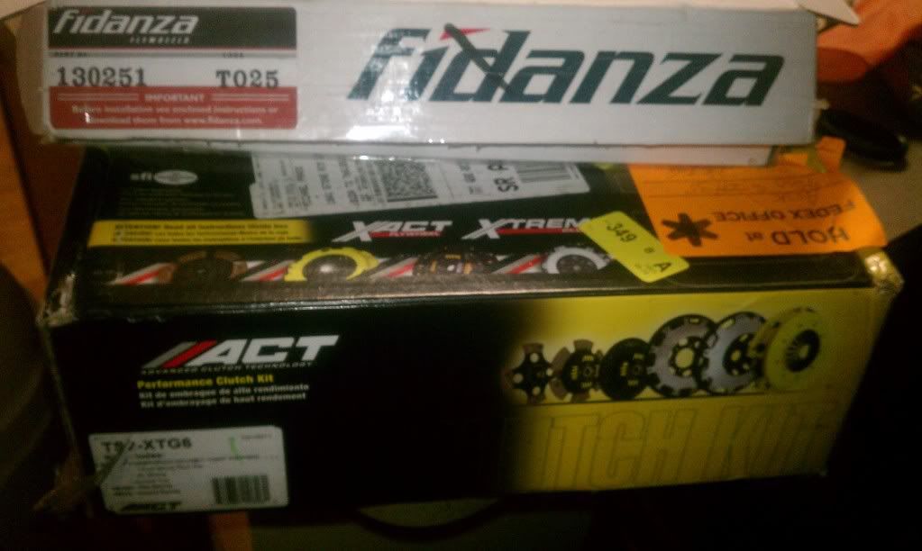

Christmas came early.... Time to get to work.
---------- Post added at 09:12 AM ---------- Previous post was at 09:08 AM ----------
Sweet, Darrell!!!!! fix those leaks.
