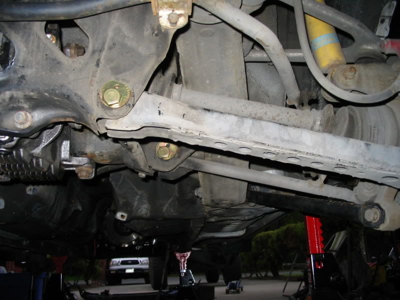

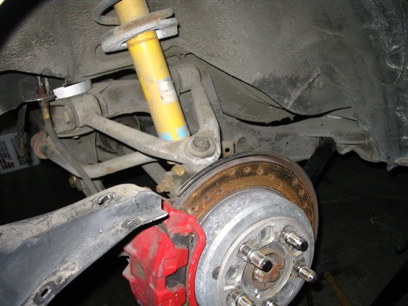

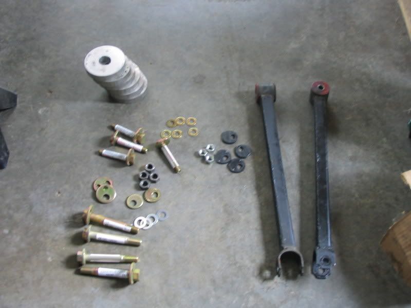

well my spacers are in and my boxed beefed up traling arms are in stall and all brande new hard were for down there
still have the front to do still and never size all the cam bolts ect

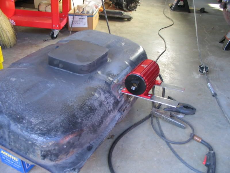

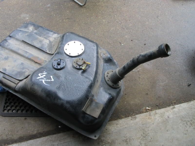

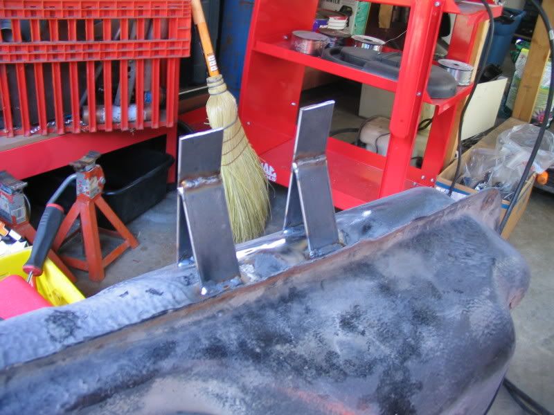

hum mm stupid fuel pump there not much room for it lol
but i did find place to put it but i got make custom monte on my gas tank for it to sit
since the a1000 does not self prim i going have to put it low as possible
and one way check valve i don't trust in less there after a filter even still then don't like them ina fuel system
some times i wish i went with magnafule some times

ummmm i kidna throw them in the gragbe can thou lol
it's pretty easy there are only 3 diffent cam bolts you got to get
the rear cam bolts and cams are all the same
the front have 2 diffent ones for the front and back lower arm and get the cam's to match
in most cases you will just need the cam bolts and re use you old hard ware
hope this helps

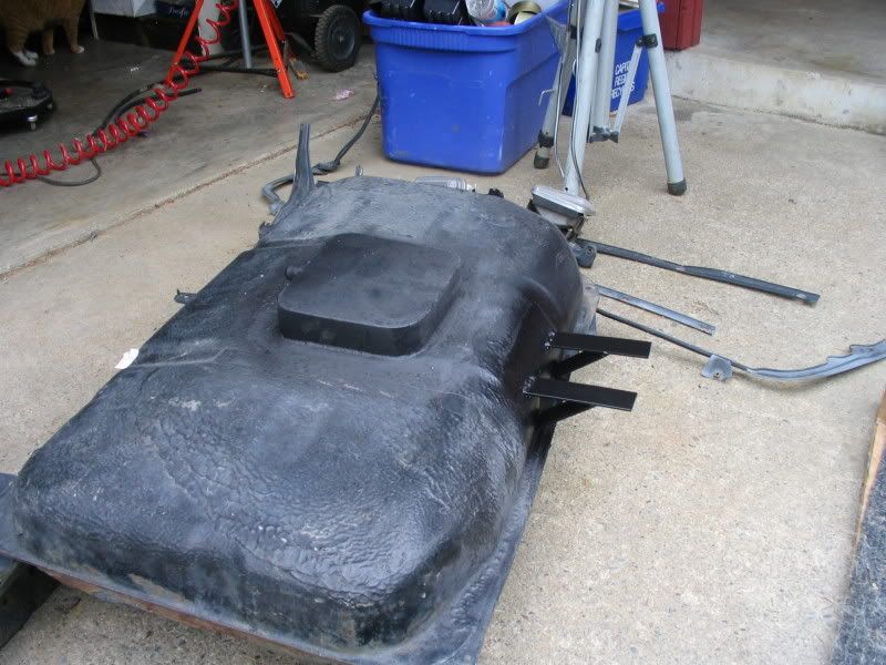

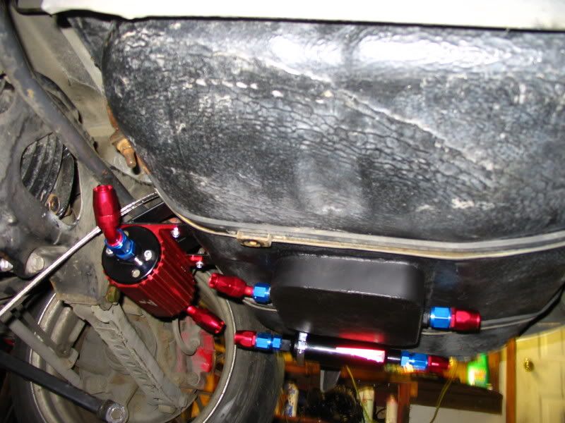

well she coming along
stuff that has bean done

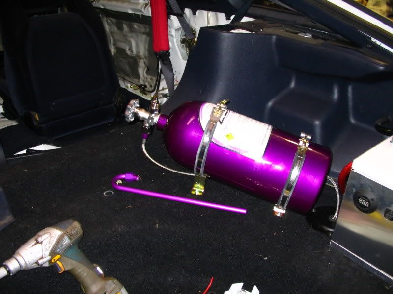

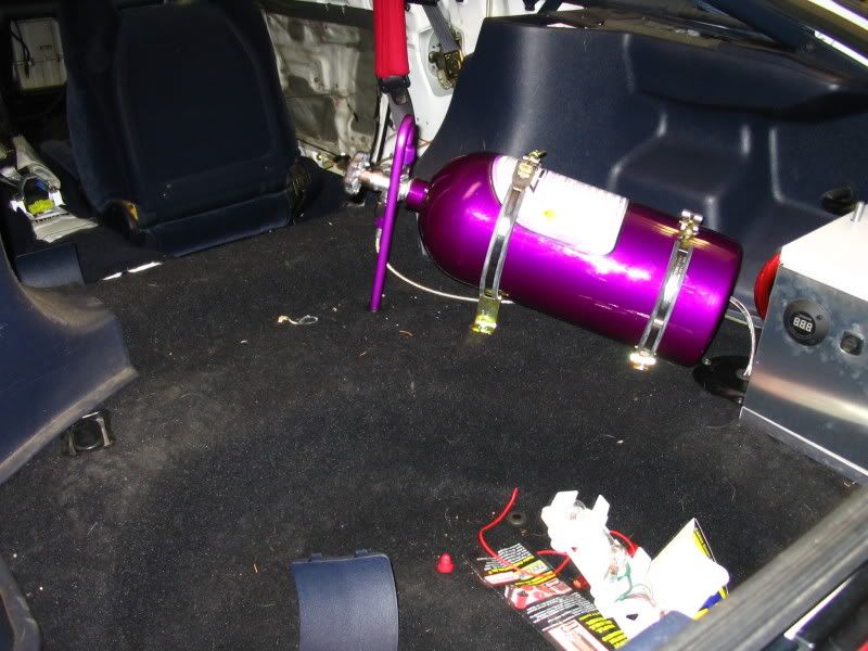

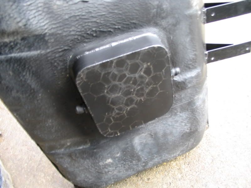

zex tank installed lines are ran up front
zex nozzle installed
lines for the inter cooler perg are ran

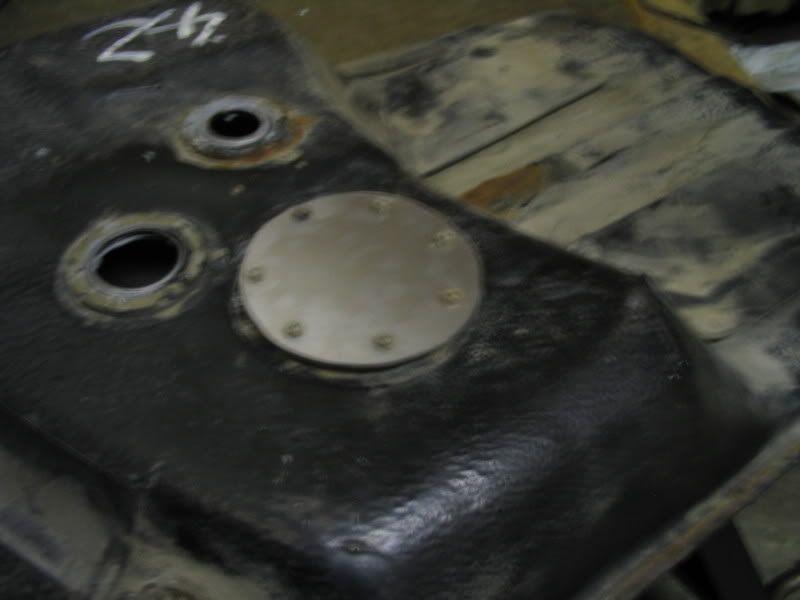

gas tank painted/a1000 Mount made/return bung welded on/custom cap made
gas tank install and never coming out again WOOT WOOT

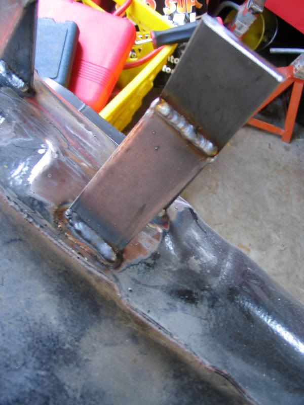

ffi is being reinforced so ti can take 30 psi all day long

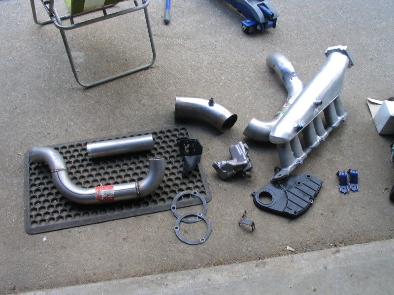

i got my blow down tube install and my fuel line fitting mocked up
i even made a tool to get to thous hard to reach areas for my intake manifold
tomorrow i have to send bunch of stuff to get powder coated
anys way here is some pic's

well this is the first batch to got to powder coat getting all done in glosses black
i will have another batch going out soon as well thinking gun metal not sure yet thou
oil pan will be going blue i know that for a fact
