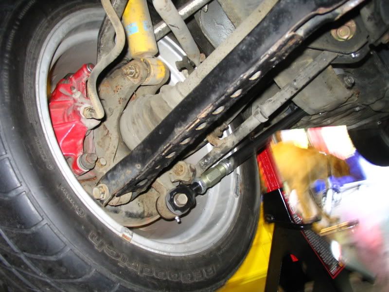

Making lots of progress Ryan! Can you give me more info on the problem with your Energy bushings? I bought a full set, how can I check to see if mine are correct?
Also, how are you going to use those arms to reduce toe in under power? As you know my car with the stock bushings toes in like crazy.

but the arms will pull the slack out and make stuff tighter and reduce toeing in and out and will not hop when wet out like other fixed arms do
it pretty simple to make as well so it why not thing

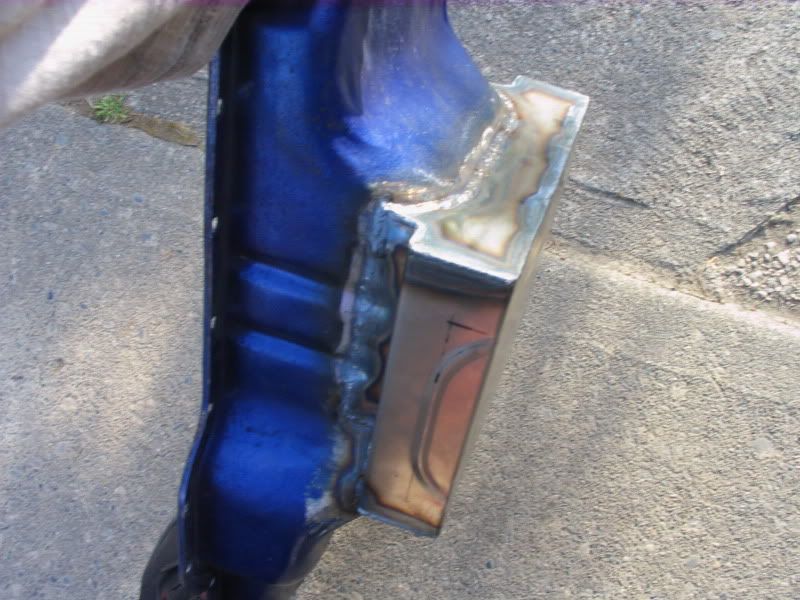

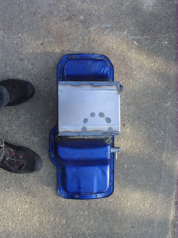

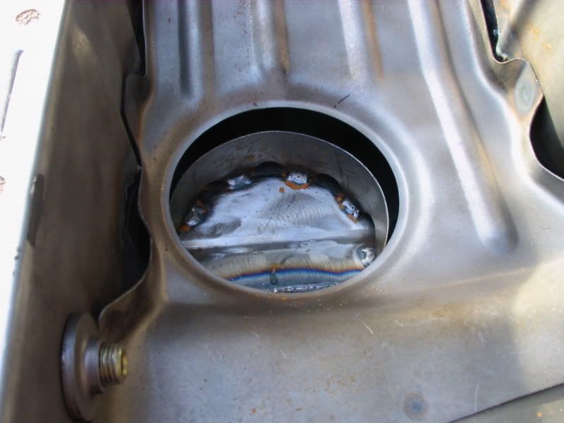

stuff that got done oil pan is completed
i changed it up some and tested it with water for slosh etc and works good i am glad i did not add another deflector cause it simply would not be needed
reason being is if water does not have issue since it's heavier they oil will not have issue at all

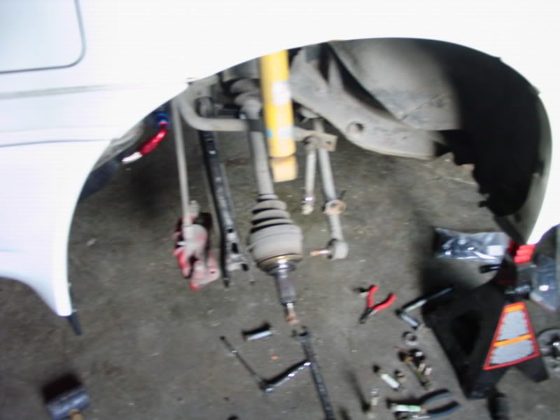

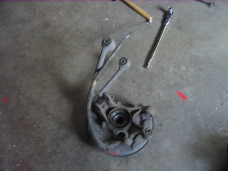

stuff that i did yesterday was remove the knuckle and push some bushings out
i suggest if you are doing this leave the e brake shit alone and just undo the cable form the car much easier
the only issue i had was when i was pushing out the bushings some of the
e brake guide pins would comes off but there cake to put back together

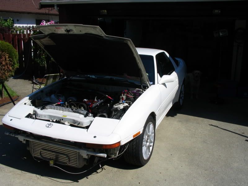

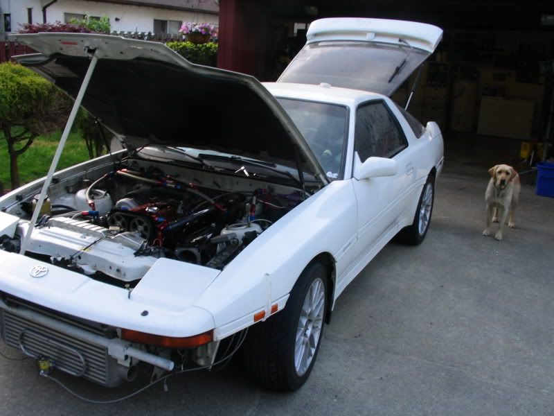

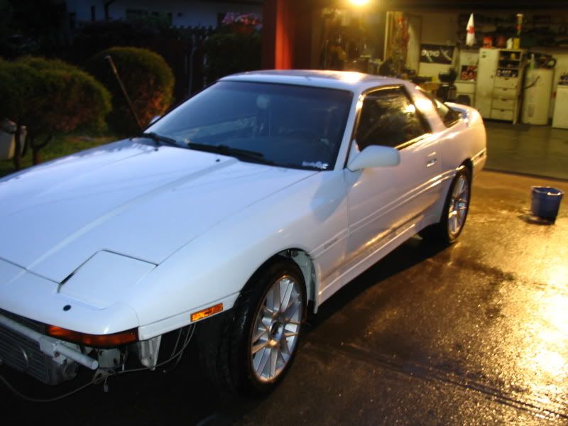

well she on her 4 feet last night it's bean one year since it has bean this way
and holly dame i forgot how much i loved it in dirty state but i soon fix that with nice wash

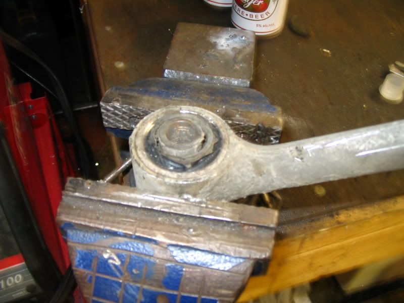

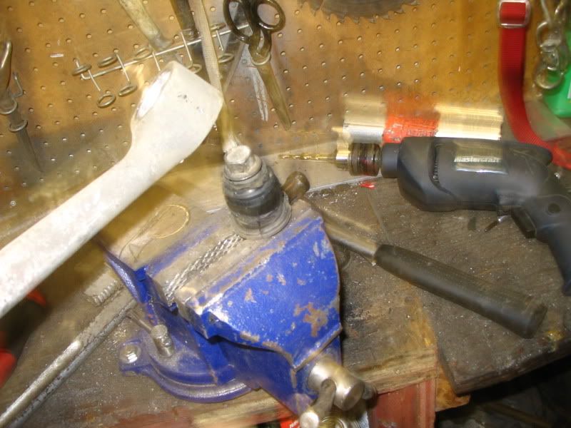

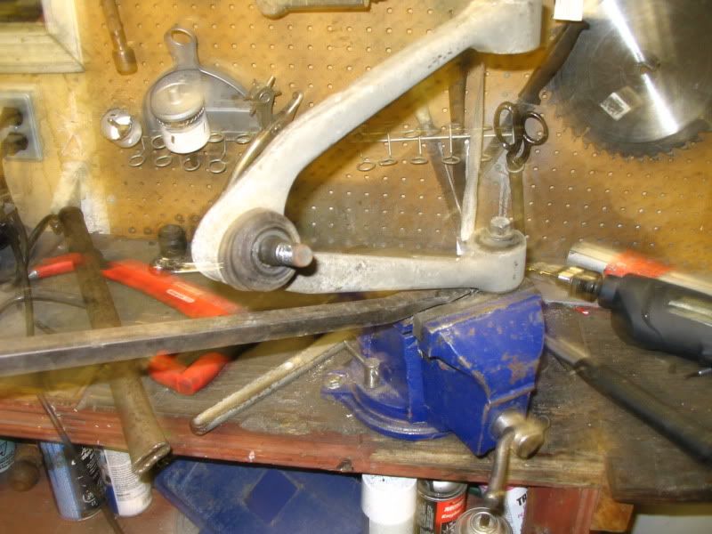

all right what i have done to get it to the point were i am at now

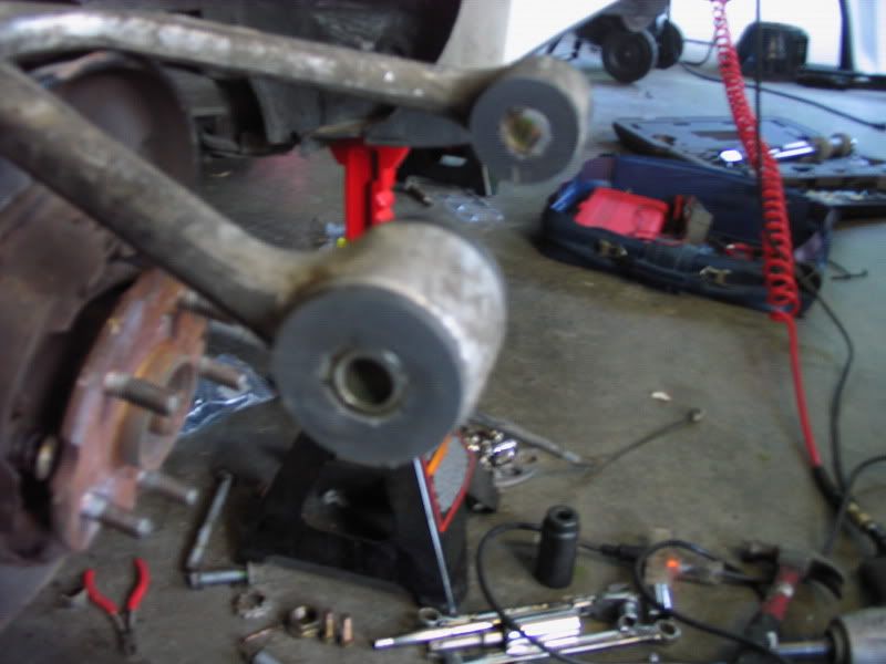

i found the front a arm bushings to be cake walk to push out
but the rear's well not so much more of hell taken them out but i found a good easy fast way to getting them out
tools you need
long bolt
vise
big pry bar
some thing sharp
slice off other rubber
grab a arm and slid bolt though hole clamp really good in vise
grab pry bar slip it in and pry on one side and then swap to the other
side and hold the arm arm with the other hand and she should pop out after some prying it take fair amount of force
this is my cake booking it to safety after loud bang happen air gun line found it funny cause he has never went up there before
here is some pic's of my trailing arms installed and the bushing's i had to shave down to fit with a sander pretty much all the rear had to be sanded pretty sad the front was blessing to do the rear umm fit's like crap but can be made to fit
