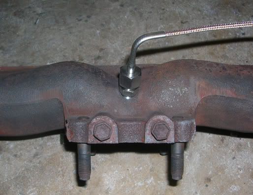

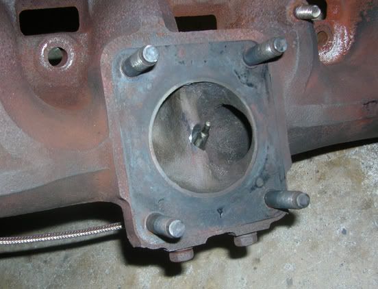

Just a suggestion (dosent look like you've tapped for EGT yet). Since you've got it out, and have modded the the "wall" already, You could easily tap the mani like I did. It works great for an over all temp instead of just going off of #6. Again, just a suggestion.

Thanks Jimi, I'm trying to decide if I'm going to use an EGT gauge or not, but I'm probably going to drill & tap the hole anyway. If I decide not to, I can put a SS bolt in it to close it off. What size tap are the EGT probes?

Can you substantiate that the #6 cylinder is the hottest w/r to EGT? The head and coolant chambers in the vicinty of the #6 cylinder may run hotter than the the other cylinders, but this doesn't directly correlate to higher EGT's... If one wishes to utilize a single EGT sensor, then it's best to get an average of the combustion from all the cylinders rather than just one unless you can identify which is generally the hottest (and the hottest won't necessarily be that way consistently). If you must know how a cylinder is performing, then consider measure each cyl. individually.

IMO tapping for average temperature is stupid. You might as well know what the commonly hottest runner is doing rather then the average. id tap number 6.
obviously without having a probe and gauge for each individual cylinder/runner the number you get is a guesstimate at best to what your engine is doing....
however 6 is commonly known to be the hottest....often detonation is caused from this heat and is the reason a LOT of bhg are in the number 5 and 6 cylinders.
personally i believe that if i keep that temp down the rest of the engine should be fine ASSUMING you dont have instant fuel loss which would create problems so quickly the egt gauge would be irrelevant anyways.
personally if youre gonna put it in the collector you might as well put it in the turbine housing or the dp....as the reading you get will be just as "useless" imo.

This is still speculation on your part because you've yet to stantiate your claims - you're just qouting "heresay".
Stick a probe in either the #6 or #1 cylinders and report back the average disparity between the measurement.
Oh yea, the 3 BHG's that I've seen have all been on the #1, #2, #3 cylinders. Is this an indication of fuelling aspects, heat, etc.. for those cylinders?
Again, it's best to get an average EGT, if you can't prove which cyl. is the hottest, and if you can't measure each individually.

BTW, with only one probe, average is best IMO, If you are wanting to keeping an eye on what you assume to be the hottest, then you need to put a probe in each. Or else it's pointless IMO. I would not want to go off of an assumption. Every engine and set-up is going to be different, way to many variables not to be (my BHG was on #3). Just like it would be to read O2 off of only one cylinder. Sure in theory it shouldn't matter, if every thing is perfect, but nothing is ever perfect.

as far as the egt, buddy did a test on each cyl and found #1 the hottest by 40F at peak. we attributed the fact to #1 cyl being the last to get fuel.
